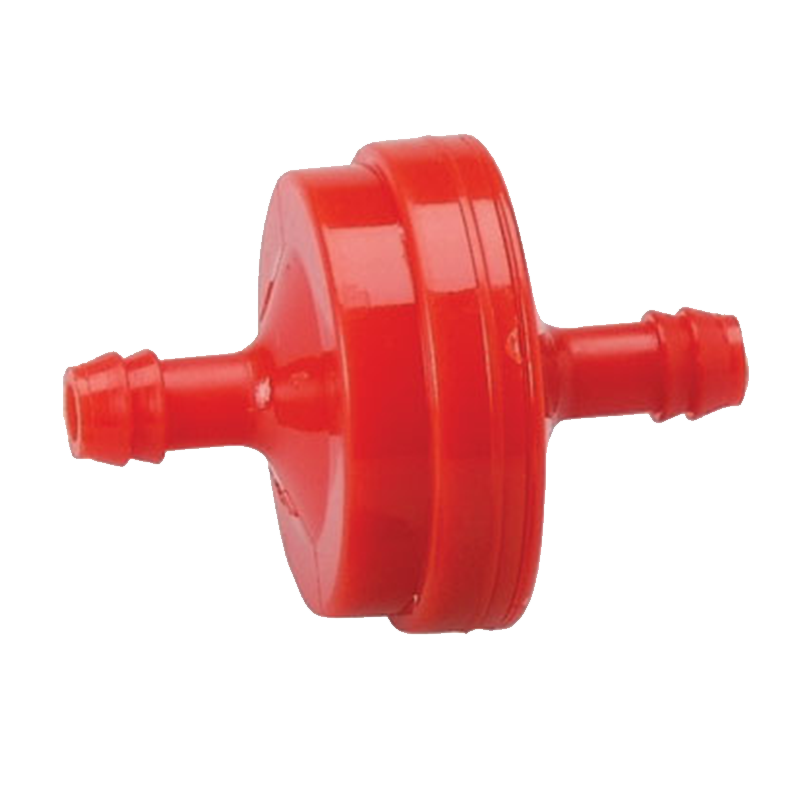

It's all taken apart now. There was nothing from the gas tank to the carb except the small fuel filter.
The filter looks like this:
What does the pump look like? Any good website with pics?
Thanks!

I haven't seen any small engines that have a fuel pump. That's usually on a little bigger lawnmower stuff. You could probably eliminate any feature problems by installing a fuel shut off.
