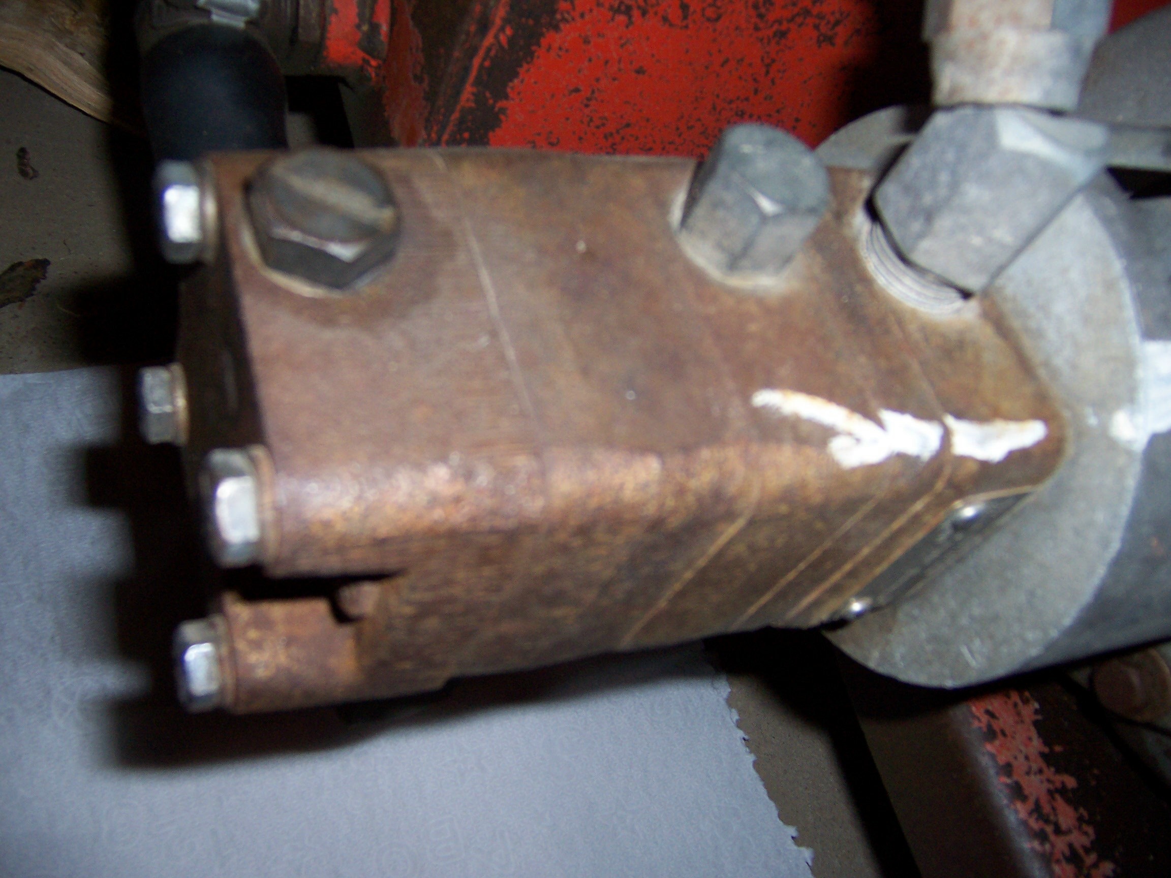

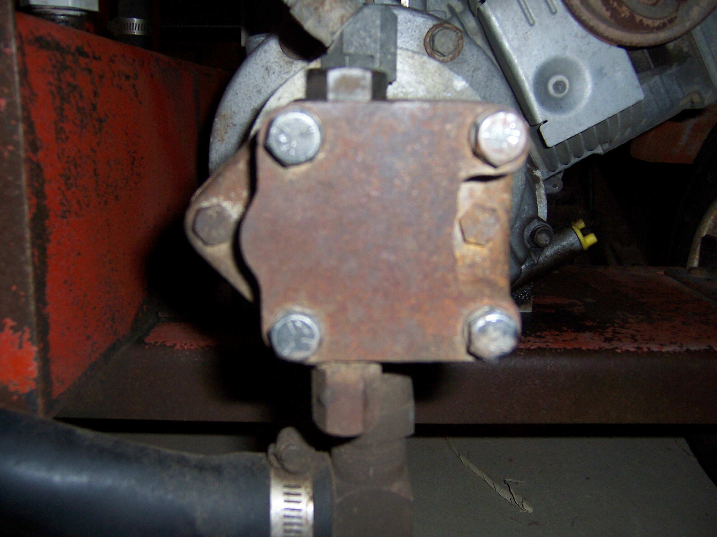

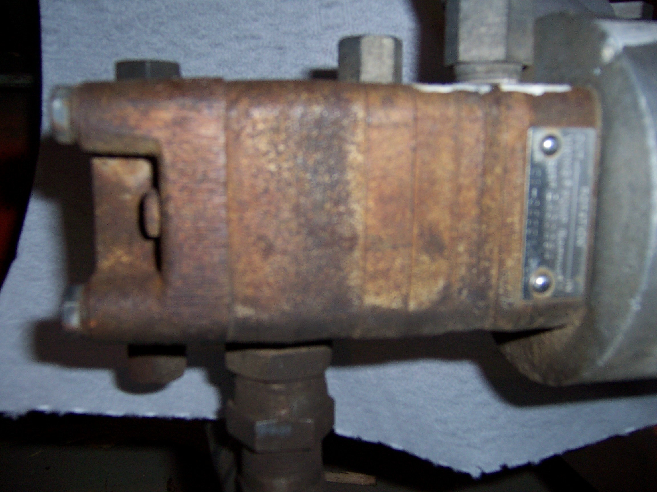

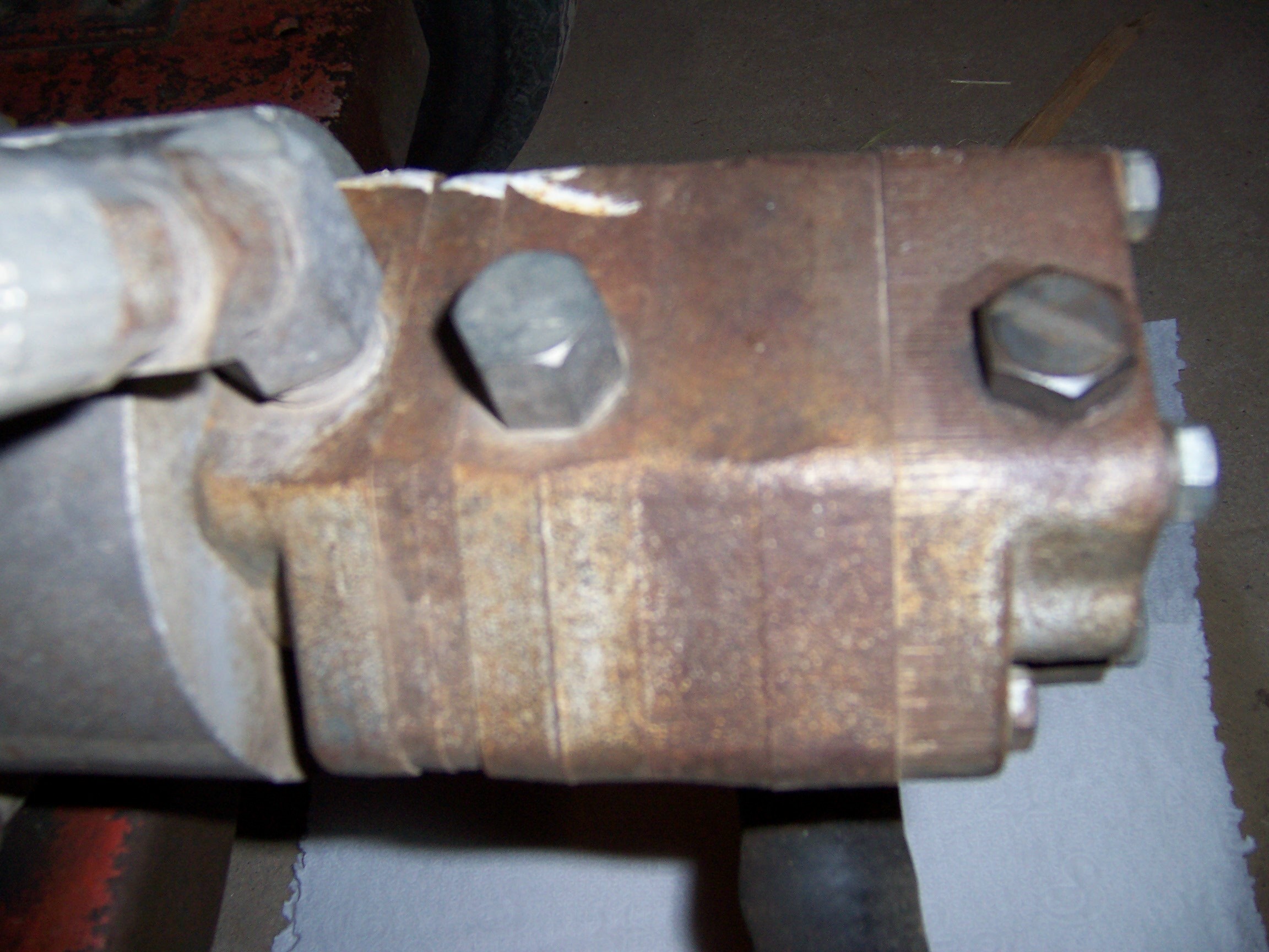

The pump is a Viking model #CP-055014-CO
   / Huss Log Splitter #13
Cant find any more than DOUBLE PUMPS at Viking pumps site.... at search on viking pump site this comes up....
I think we will have to give crazyal a point here...:thumbsup:
Are you sure it is a TWO-stage and not a double pump??
How many each of suction lines and pressure lines is connected to pump?
Any valving built into pump?
We need some photo of the pump,,,:confused2:
or call
Viking Pump, Inc. A Unit of IDEX Corporation
406 State Street, P.O. Box 8
Cedar Falls, Iowa 50613-0008
Telefon: (319) 266-1741
Fax: (319) 273-8157
   / Huss Log Splitter
#14
Got some pump pictures.
Viking pump model GP-055014-CO

Try to see if there is info on pump about make and model#.....
Then the flow points at a around 12.1 gpm pump (at high stage), and force points at a PRV set at around 2400 psi...
Just a question to make sure I am not misunderstanding terms. I am guessing that PRV that you wrote = Pressure reducing valve. My thoughts are that a two stage or double pump would use pressure sensing unloading valves and not pressure reducing valves to shift from high flow/low pressure to low flow/high pressure. The unloader valve senses pressure buildup because of load and then opens the unloader valve to dump the high flow back to tank. Unloader valves are NC valves and when pressure is sensed (internally or externally sensed, depending on application), the valve opens, dumping back to tank. Is this correct.
