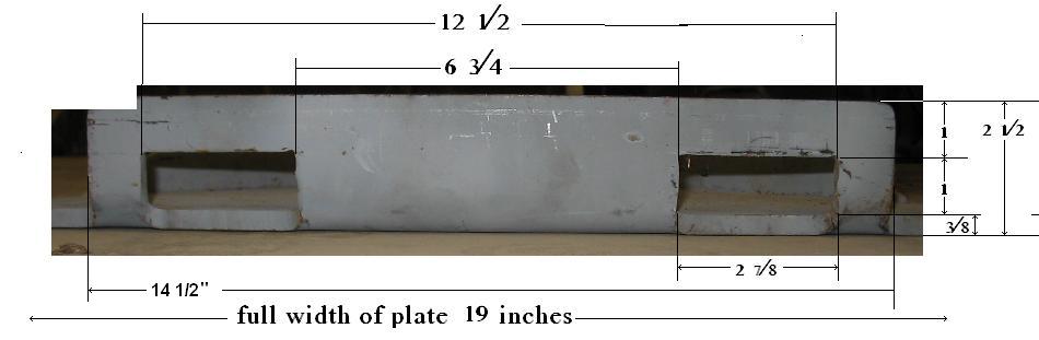

hyd. cyl. mfg. and attachment plate dimesions
   / hyd. cyl. mfg. and attachment plate dimesions #21
next pic

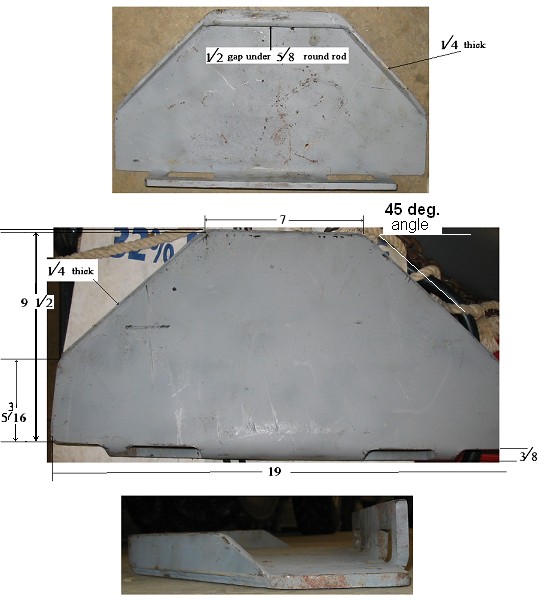

   / hyd. cyl. mfg. and attachment plate dimesions #22
pic 3
   / hyd. cyl. mfg. and attachment plate dimesions #23
pic 4

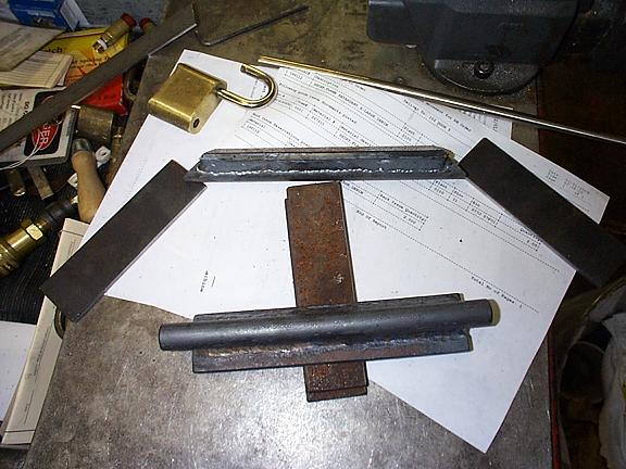

   / hyd. cyl. mfg. and attachment plate dimesions #24
I built 2 of these this weekend. They are made from all 1/4" metal with the exception of the 5/8 bar for the top hook up. The plate is 12" by 19" it could be trimmed but I felt I would weight till its application. Notice the braces at the bottom for added strength of the bottom hookups.

   / hyd. cyl. mfg. and attachment plate dimesions #28
J.J. I don’t think my adapter plate is better. The added structure at the bottom is because I had ¼” plate and wanted to use it. I believe with that structure it will be comparable in strength with PT’s 3/8 adaptor plate. The extra 12 by 19 plate can be trimmed if needed when installed on what ever attachment it is to be used on.

   / hyd. cyl. mfg. and attachment plate dimesions #29
Making a few more quick plates. Here is a pic of the tops.
