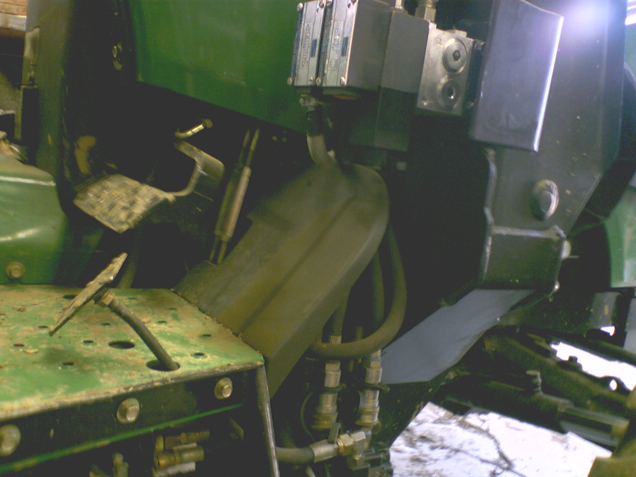

   / Hydraulic Auger Mount #57
bindian

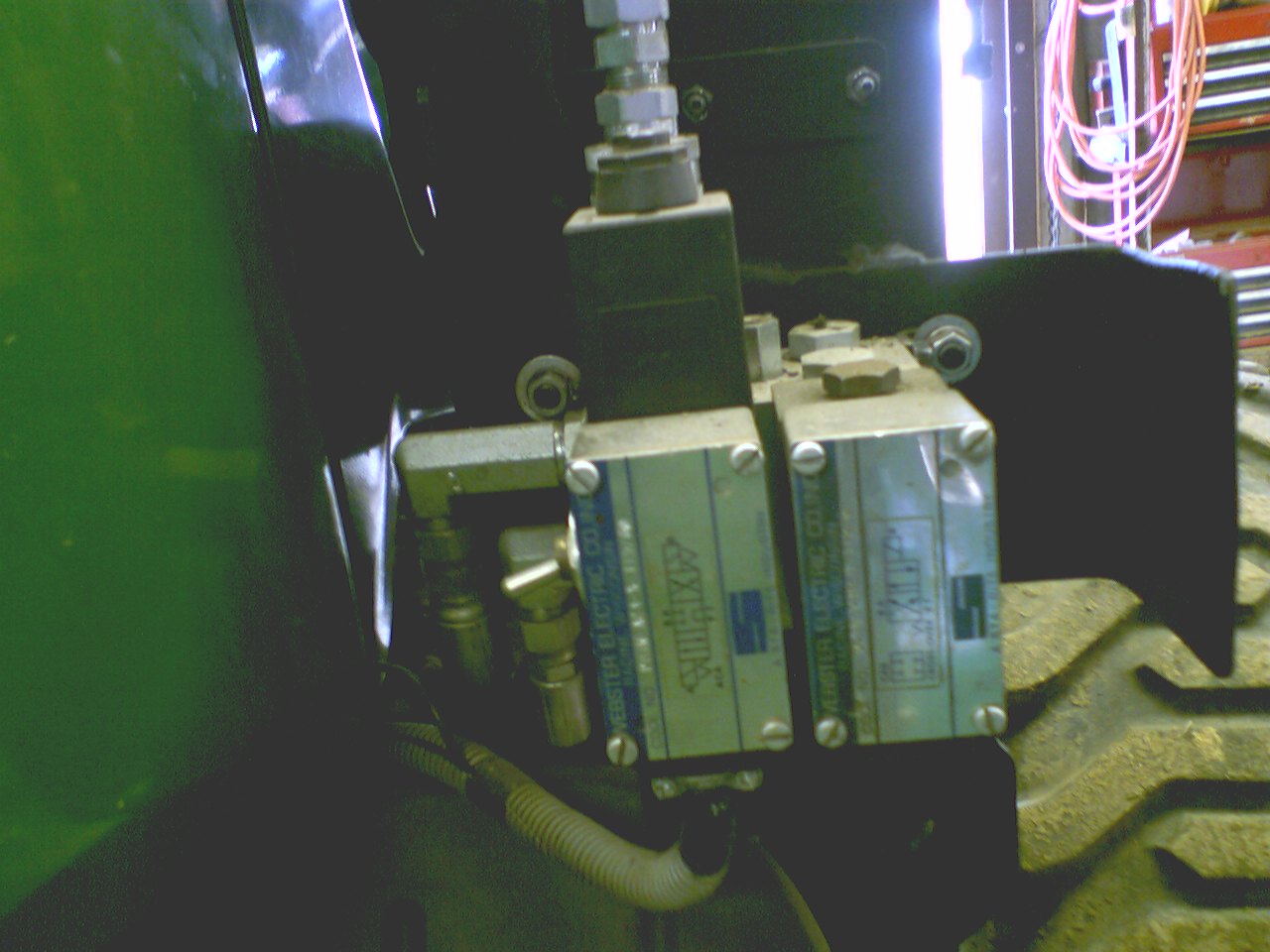

Here are a few pics of my Hyd valve set up i made . I chose this location because it is was as close to the loader valve as I could get it and was easy to pass the Hyd lines to the front. I really liked the way the long and short 90* fittings nested in tight to the tractor and The PB & tank lines were easy to run in this location.
ak9

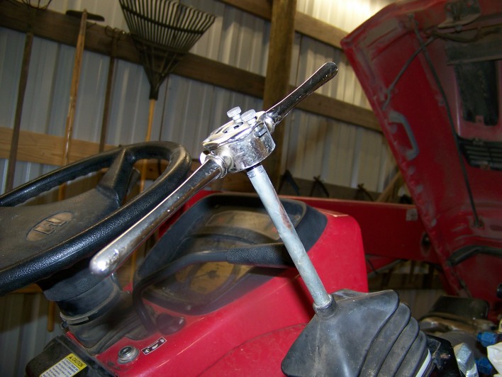

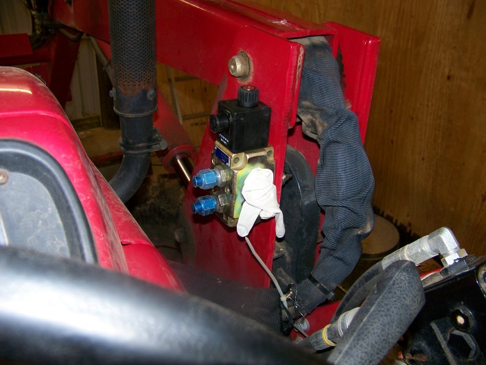

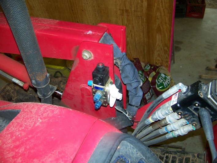

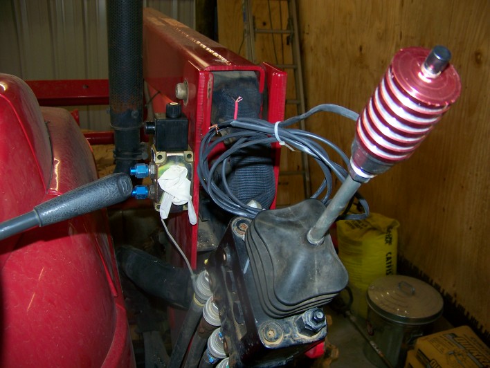

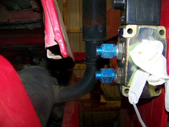

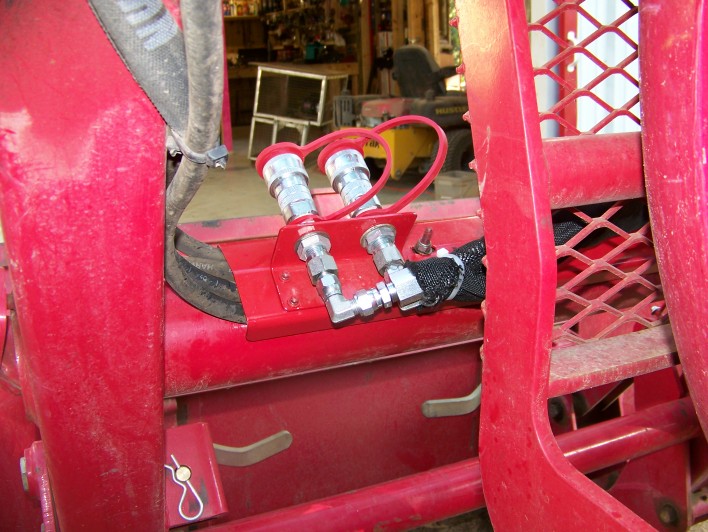

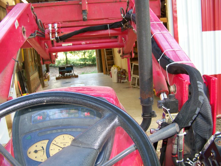

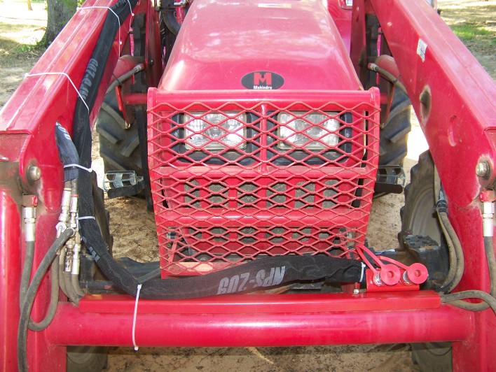

Thanks for the input and photos. I have plenty of room forward of my loader valve on the mast. So that is where I bolted the valve. I have plenty of clearance, even hood clearance. The knob switch is all finished and the wiring harness ready to install. I extended the threads on the shaft for a jam nut.
Just ordered fifty something dollars of SAE fittings for the valve installation. I ordered extra of different fittings to make sure I have what I want when I move lines.
Oh yeah, the white thing on the valve is a rubber glove I used to keep metal shavings out while marking holes. The blue fittings are aluminum AN fittings and caps, which are the Army Navy version of JIC. Those are there just to keep metal shavings out also.
hugs, Brandi

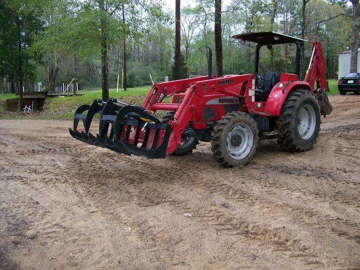

Last Thursday, I won the bid on a Richie Brothers Auction grapple. It was the only bid won under $1000 for a grapple. I wondered why until I saw that I won a bid on a grapple that I thought I deleted from my watchlist.:eek: It is a lite weight grapple and the Big RED Beast just might turn it into a pretzel.:eek::eek: I'll let Y'all know after I get it working if I want to sale it our keep it.
hugs, Brandi
