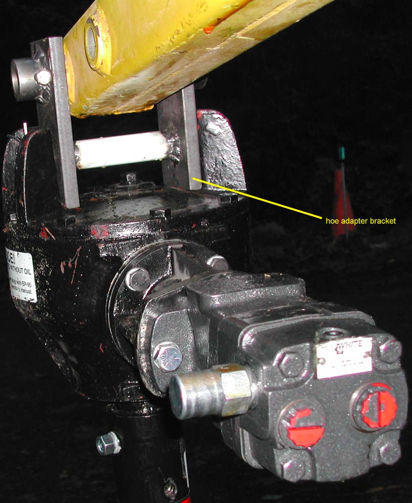

After waiting weeks, I finally got my fittings installed on the hoses. I really like installing fittings myself. It reminded me of my general aviation days when we made up landing gear hydraulic lines. Not counting me not tightening up the QDs after I installed dust covers, I had no leaks. The QDs were just on hand tight and didn't leak much. I want to look into welding on hose clamp brackets, to get rid of the ugly tywraps. I will buy some black tywraps and install them until then.
I installed the hydraulic auger and dug some post holes. After using the auger on the backhoe, the front loader mount leaves me wanting. I can adjust left and right a little with moving the steering wheel, but can't really tell if the loader is ahead or behind of the auger bit shaft, as in 90 degree holes. On the backhoe I can see this all easily and move the boom and dipperstick as needed. Also, when the auger bit is full of sticky clay, I can swing the backhoe and scrap it all off. On the front loader I have to move the tractor to scrap the clay on the bit or let it fall back into the hole.
Over all I am leaning towards the auger on the backhoe. I will try both ways in the next couple of weeks as I put in 300 feet of fence.
My new 72 inch grapple should be here by the 30th. Yippee.:cool:
hugs, Brandi

zip tie a rod and paint it yellow, to the auger motor. so the rod extends up above the bucket and you can see it.
zip tie a rod and paint it green, and fasten it to the bucket near the auger, between the 2 rods, you will see + or X or II pending on curl of bucket.
have no idea if above would work. but i know the feeling, of trying to use FEL bucket to push down steel T posts. and then using the backhoe bucket to push down steel T posts. backhoe bucket wins ever time. so much better clearance for better view of things. and ability to articulate the backhoe bucket, and keep the auger going straight down.
that is one of things i hate about 3PT hitch PHD diggers, not being able to adjust left to right angle. easily without repositioning tractor. only forward and back ward and that still means moving tractor. not to mention the old twisting body backwards to keep an eye on things.
other thought, would it be worth putting an extension between bracket on bucket, and mount on the auger motor. so you would need to have entire bucket raised up higher above the ground. so you have better clearance for viewing things?
other thought, would it be worth while, to have pallet forks on. and mount PHD out on a fork? further out in front of tractor, = turn of front wheels = more angle you can place on the auger?

Boggen,
Thanks for the replies. Back towards the first of this thread I stated I can see the auger and bit easily from the seat and posted at least one photo of it from the seat. Can't see ty wrapping a rod to a round motor unit.:confused: Also, it is forward and aft that is hard to figure if it is square. The problem comes from being further away and a lower angle to the bit. On the backhoe I sit high and can move the boom and dipper stick forward or backward to adjust the angle to stay square. On the loader bucket, I have to move the tractor forward or backward as the auger starts and goes down and back up to keep the hole at 90 degrees.
Good forks have a large headache rack on them, which would be harder to see than off the end of a 7 foot wide bucket.
