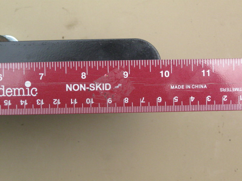

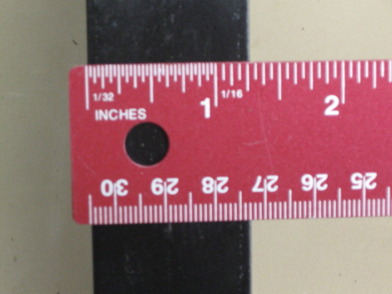

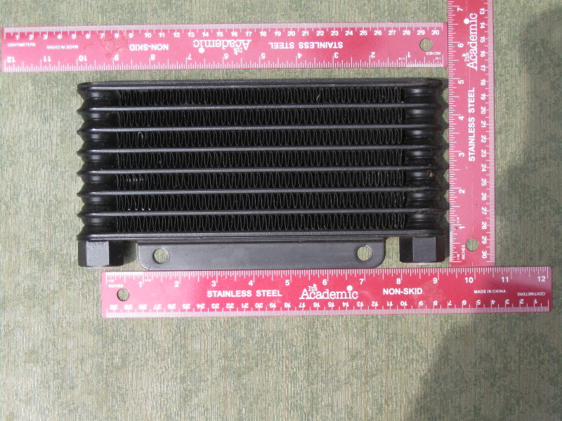

Oil cooler dimensions in attached pictures...
Don

   / Hydraulic cooler on my CK25 #65
For comparison, my cooler is considerably larger. The connections are rubber type hoses with hose clamps to secure them.
