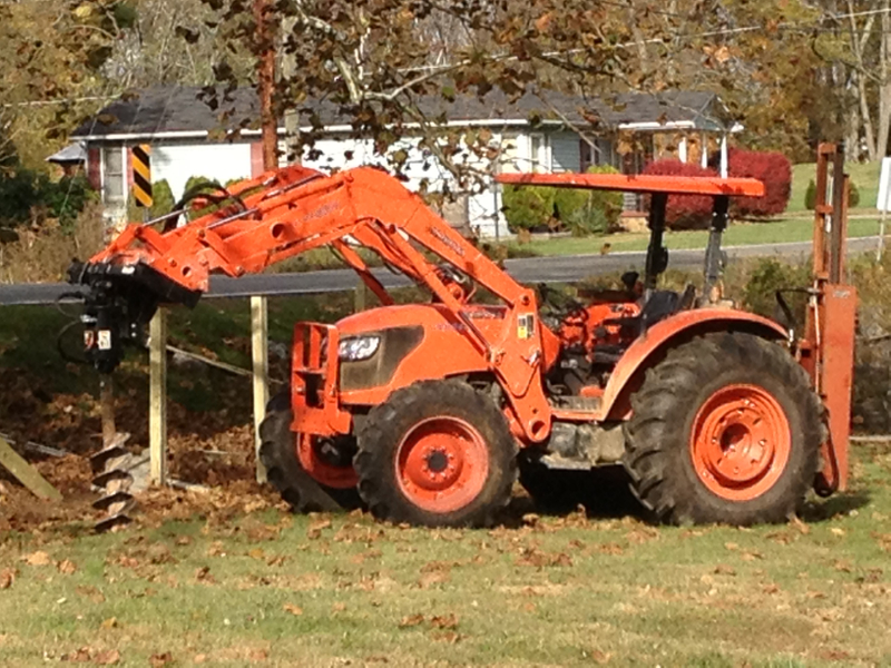

About 3 years ago, I bought a Bobcat brand hydraulic auger motor with both 12" and 18" augers for $770 from an ad on eBay. This is less than, but in the same ballpark as a new PTO post hole digger, but with all the advantages of hydraulic.
The seller was in the landscape business and used them to put in a few trees & bushes, when hard times came.
It now mounts on the front of my JKD 110TLB and does an excellent job of putting in trees and bushes.
Last month I put in 20 bushes at our church.
Another advantage of a hydraulic set up is that after I use a little down pressure to start the hole, I can dig a much deeper hole than absolutely necessary. Add a little fertilizer, and hold the auger at a given depth and it will mix the fertilizer with the dirt still in the hole.

/ Hydraulic or pto post hole auger? #25
A motor valve has internal check vavles that connect both A & B work outlets to tank when valve spool is in neutral. This is used for high RPM motors with heavy load so the motor can coast down to stop when flow is shut off. Not needed for slow motor RPM as PHD.
Loader/cylinder valve normally does not have these check valves. In larger construction equipment, companies will have combination circuit reliefs with anit-cavition valves so the valve can hold load under pressure for cylinder operation but still open momentarially to prevent high shock load such shutting fast spinning motor off.
One thing to consider using a hydraulic auger on 3PH, is does the rear remote dump returning fluid direct to tank or does it Power-beyond capabilty built into it. If it returns to tank you can not keep auger rotating and lift 3PH at same time. There are tractors with factory setup that allow multi-function of rear remote and 3PH, but more that do not vs those that do.

Make a commitment for rules and shut down the equipment if anyone gets near. Everyone should go home at night.
A hydraulic on the FEL gives greater digging depth, downforce to push down, reversing. Mount the PHD to the far right so you can see the tip from the tractor seat.
