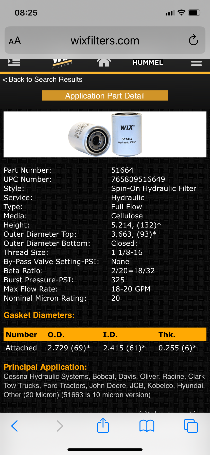

What filter are you using? Same as previous? This is the Transmission filter, charge pump. Not sure if there’s a second filter.
See this picture about the WIX recommendation. Bottom line in photo
   / Hydraulic pump whine, massey/agco/iseki
Thanks. I bought one of the 51664 filters and it doesnt fit. There is only 1 filter on this tractor, on the suction side of the pump. The filter that was on it when i bought it was grey and only had 1 number on it "1720". I cannot find any info on that filter anywhere. So i tried the 51664, no go. Then got 3322234M2 from the dealer. Then started having loss of hydraulics, so then switched to wix 57403 which was cross referenced to the agco filter. Then pump got noisy, ( i think the wix was 12 micron). In the agco parts books there is 3 different part numbers for hydraulic filters, (none of which is the one i got from the dealer). I called a different dealer and they gave me a totally different filter, which i found on agco parts book that its from a MF1440 which i think was an update to deal with hydraulic issues back when these tractors came out. Anyway, I think the damage is done and I will need a new pump. I also ordered a new relief valve as it doesnt seem to adjust at all and pressure is low.
