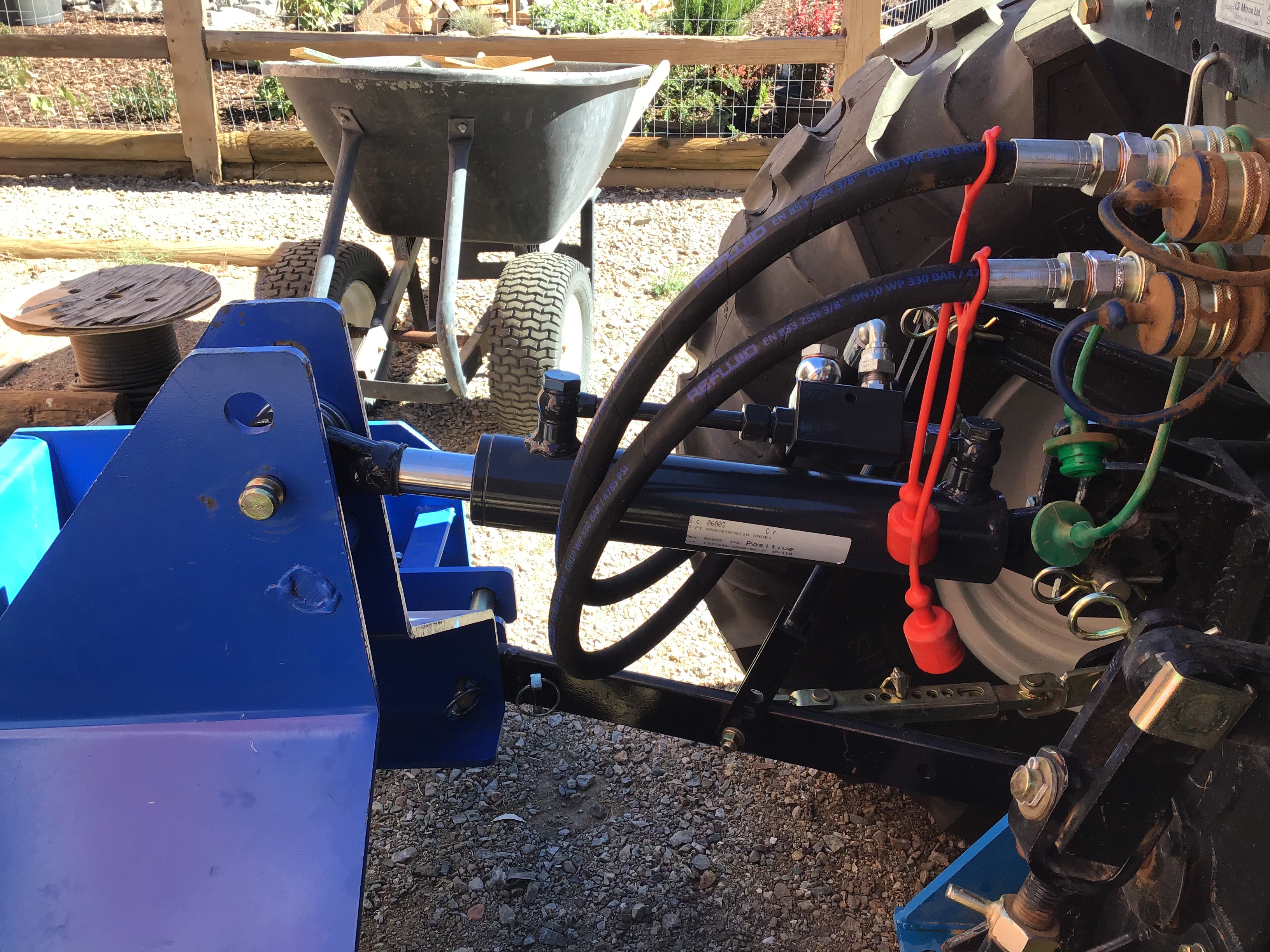

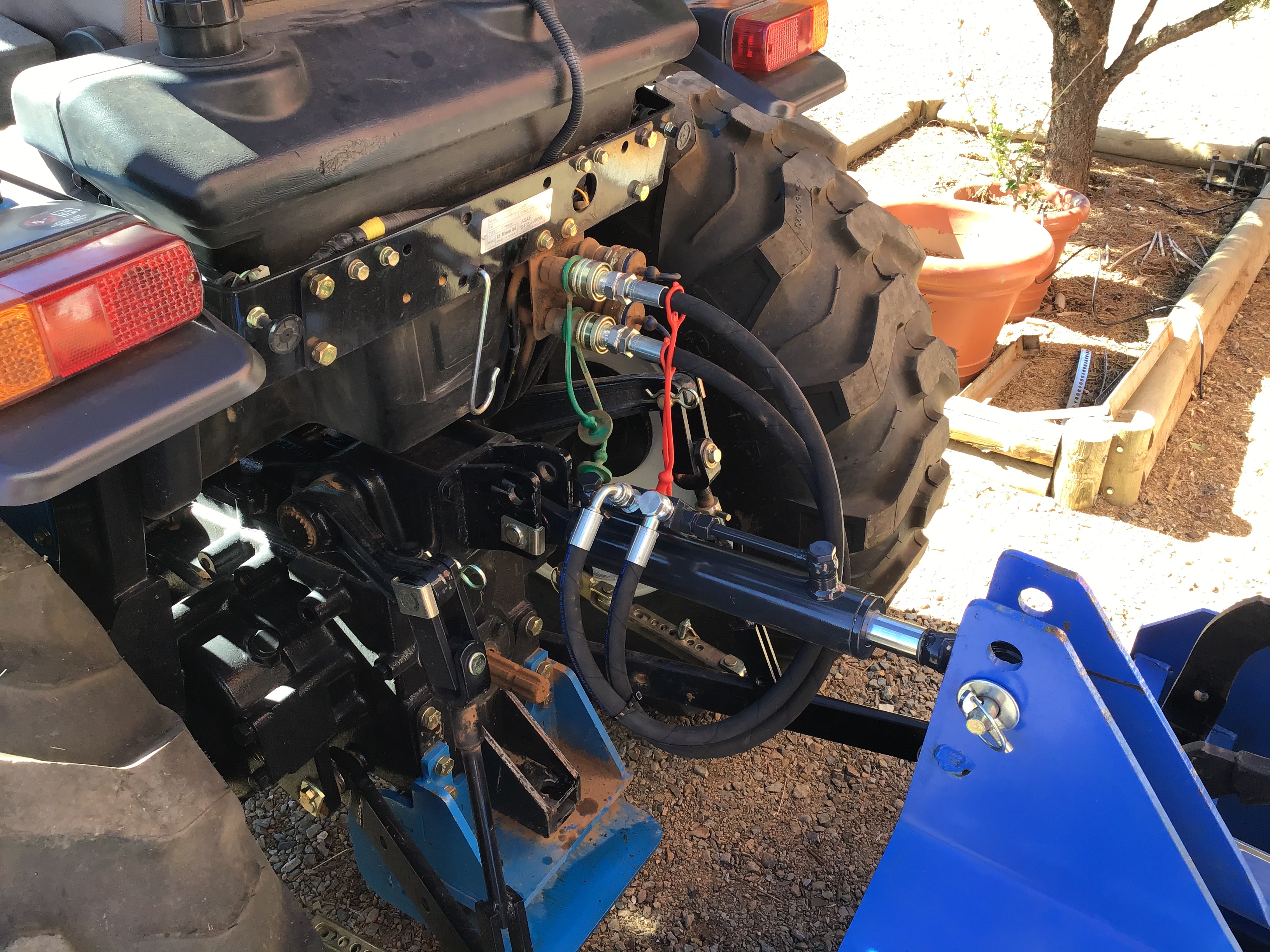

WOO-HOO! Finally got a hydraulic toplink and installed it today. Works great! Next will be a hydraulic side link, but that will be a while.... they are crazy expensive!

Curious about the proportioning or diverter shuttle valve that's on there. Can someone tell me it's purpose. How much was that setup?
/ Hydraulic top link #4
Just as a price point, Agri-Supply is where I got mine. It doesn't have that valve setup and I'm struggling to figure out why that's needed. But a Cat II is $176 and the hoses there were about $25 each. I had to get 2 NPT to ORB fittings.
/ Hydraulic top link #5
The valves on top are double pilot check valves...they prevent the cylinder rod from moving when there is no fluid flowing in or out...it keeps the top link rigid... A hydraulic top link can be made to do the same without a check valve by disconnecting the hoses from the remotes...
Is that the 18 1/8" - 26 3/8", 06003? I see that number in the 2nd picture.

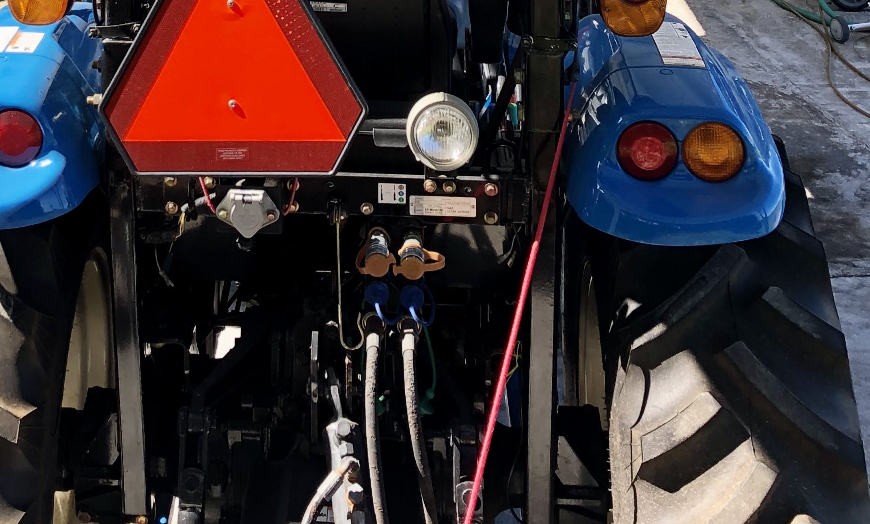

Here is a single factory rear remote turned into 4 useful sets of couplers using 3 electric diverters, all adjustments at the tip of my fingers using a single control lever and 3 separate switches in the control grip on that lever. :thumbsup:

Holy rear remotes, batman!
Is that something you bought and plumbed yourself, of was it a kit you were able to purchase?
Yes it is. Works really well. On my box blade, it will drop the rippers down 4" with it retracted. Fully extended, it will roll it back onto the rear facing blade for fine smoothing. A perfect fit!
