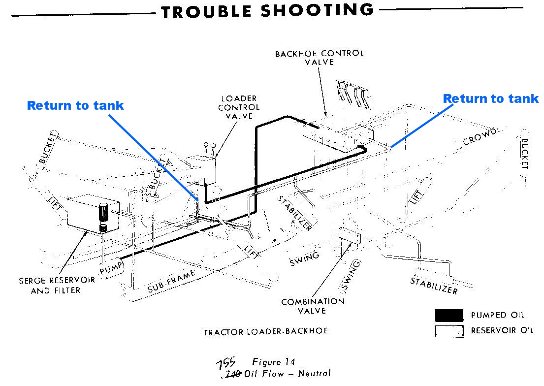

mrkool - The Ford setup has the power beyond function in the backhoe valve, so that fluid goes from the pump to the backhoe valve and then to the loader valve. The attachment to my post #43 in this thread shows the oil flow diagram for the 740 FEL with backhoe. The 735 is similar except there is no surge reservoir on the tractor itself (the loader frame is the entire reservoir) and the filters are different. If the backhoe you found was made for the 3500, the PB function should be in the backhoe valve.

   / Hydraulics for Backhoe #86
That backhoe looks like what I had on my 4500. It was a model 755, 15 ft. digging depth. The 3500 mounted either the 750 hoe (10'6" depth) or the 753 (13'4" depth). All hoes were identical except for dimensions and cylinder sizes.
I'm no hydraulics expert, but as Monte and Jerry say, I think 7 lines at the valve means PB is installed at the loader valve. Check the backhoe valve - an odd number of lines coming from the valve (I think there should be 15: 6 pairs of work ports plus inlet, power beyond and return to tank) should mean PB is installed there too.
Digging further into the shop manual, I found where the PB plug can be removed from the backhoe valve (it appears to be simply a pipe plug installed internally in the valve body and is accessible through the outlet port). This would allow you to feed the FEL first, if indeed the FEL valve has PB.
Is that a selector valve on the side of your FEL valve? In the shop manual it says "The power-beyond port supplies oil to the loader valve, when a loader is installed on the tractor. All pumped oil is supplied to the backhoe main control valve before it reaches the loader. This eliminates the necessity of using a selector valve."

The configuration is:
Pump>Loader Valve In>Loader Valve Out> BH In>BH Out>Tank
I was under the impression that my loader valve was relieving at 2500psi while the BH valve was relieving at 2450psi. Making my setup okay. I NOW think my loader valve was lower than the BH. My biggest problem now is that I cannot find a valve with PB, flow of at least 26GPM, and pressures of 3000psi that will even come close to fitting my machine. I would like to get in contact with HUSCO the original valve maker, but I have to go through my Ford dealer and they dont want to help me. I call and they either dont know anything or dont return my phone calls when I ask for particular information.
   / Hydraulics for Backhoe #93
I wonder if you still had the return from the loader valve to the tank ?Our old 730 loader kept it's return line in addition to the return from the backhoe as stated in earlier post.And if your ford NH dealer wont help you i would try another dealer till you find a good one.
Again, I'm not a hydraulics guru, but the flow rate difference would have been the issue, I'd bet. The outflow from the loader needs to go somewhere, and the BH passes 12GPM less. That sounds a large difference to me, with the resultant hydraulic fracture. Hmmm.
I'm not convinced you actuallly need PB. PB comes into play when you need simultaneous operation of both valves. Is there one without PB that fits? My tiny B7100 has the pump->FEL->3PL. No PB, it works just fine (except if you try to mess with both at the same time). I'd guess you can do a similar trick but with some kind of flow splitter after the FEL (as was mentioned by MadReferee earlier). Even if you have PB, you probably still need this because if you're not messing with the levers, the full flow will go out the PB outlet (minus overpressure flow) and thence to the BH. I wouldn't think replying on the overpressure flows to nicely split off 12GPM to give you a safe 14GPM via the PB connection.
