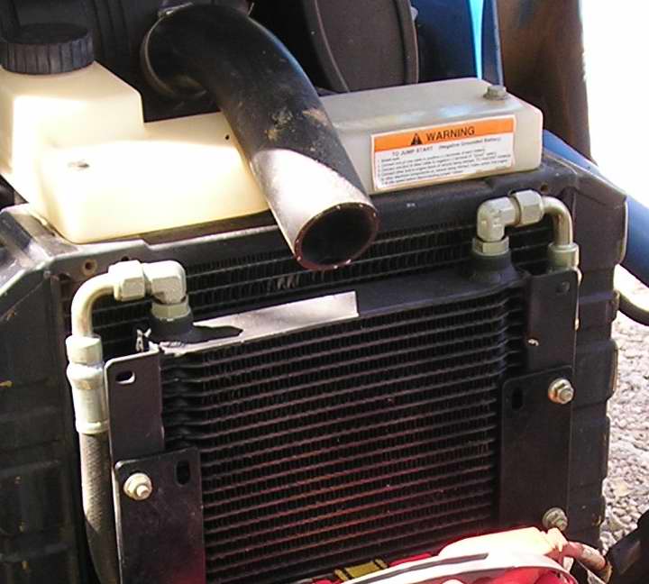

djradz said:
Any chance of a picture of the failed unit. The weld on mine is very heavy, so much so that I think it's a better connection than even the washered-versions they're using on the new units, but maybe I'm mistaken and failure is imminent.
Duane, I just went and looked at PineRidge's picture. Our coolers must be a different "batch" because mine is much beefier than his. I bet yours is like mine. I'll try to scavenge up a picture to illustrate the difference and post it.
Here is the picture.

Definitely a difference there Jim.
   / Hydro Cooler Failure TC-40D #107
You are oh so correct Jim, as usual, and so helpful too - as my wife likes to say, do you do windows too?
Anyway, mine is the same and as I originally thought, maybe even a better connection than both of the newer designs. Too bad they had to make a change in the first place. All that weld seems like it would do a fantastic job of not creating a stress point - unlike either the no/limited weld or the washer.
I think if I was someone with the no/limited weld, I hang on to it and have someone do some heliarc welding on it to improve it before it blows.
I noted too Jim that yours, like mine, does not have any top bracket for the cooler connecting it to the radiator or anything else at the top. Always thought it seemed kind of flimsy, but so far so good.
