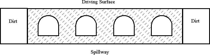

The total distance of the bridge will be 20 feet long. There will be a support in the middle and a ledge on each side.
The spillway tables and calculations I've see suggest that 8 foot wide and 18 inches tall will handle my overflow needs. I'm doubleing this, and will have two overflows, side by side with aproximately 9 feet of width and 2 feet of height.
If this doesn't handle it, the dam is history anyway, because we've gone way past heavy flooding and I expect total failure at that point anyway.
As mentioned in a few posts, the footings will have to be strong enough to handle the load, plus extreme hydraulic preasure from millions of gallons of water along with movement of the bridge itself.
My thinking is to make the center support twelve inches thick and the full width of the bridge, plus another foot for the post of the railing. Ten feet wide by 1 foot thick and two feet above grade. The footings will be a foot deep and have three 12 inche holes drilled into the ground three feet deep.
Then ends will be similar in design, but with a 9 inch shelf to rest the beams on.
I will pour cement on the inside of the dam two feet past the opening to funnel the water in and a foot below grade.
There's going to be allot of rebar and cemtent in it so it lasts through a lifetime of storms. When I start construction on it, I'll post all sorts of pictures with the hope you gusy can spot a flaw or weekness and let me know of it while it's easy to change.
The discussion between wood and steel has been extremily infromative and interesting. Thanks. The biggest problem I have is my total ignorance on the topic, which doesn't allow me to even ask an inteligent question. I have no idea what questions I should be asking. /forums/images/graemlins/frown.gif
Thanks to you guys and your volunteering such useful information, I'm beginning to understand the complexities to bridge design and the various methods to accomplish this.

/ I Beam help needed #57
Chris,
My preference is to use steel over wood and concrete over both. I would build cast in place concrete buttress with end walls on each side of the spillway and place one or two precast double tees (8 or 10 feet wide each) over the span. Use “pretopped double tees with a 4” flange and if required for the point loads (I doubt it) pour an additional topping for punching shear. Add handrails and done, forever! But I tend to like concrete (precast for this kind of job) more than most. Have designed, detailed and trouble shot precast for some time and it just seams better for this type of application.
Precast would be permanent with no maintenance, painting, treating, etc. I have designed many “bridges” for homeowners over creeks and stream with spans up to 40 feet. These must be designed for fire truck (heavy highway truck) loading.
The pier in the middle of the spillway is, to me, asking for trouble from water undermining the foundations, debris hitting it, etc. I don’t like to put anything in the water flow path if not required. But that is my preference.
…Derek
/ I Beam help needed #58
Eddie,
why not cut the span down to 7 feet or so by using 2 supports rather than one. Yes, you might loose a foot or so of total spillway capability by placing an additional footer, but you are substantially reducing the distances your beam(s) will have to span. If smaller beams are allowed, there could be additional cost savings in that scenario as well, maybe you will sleep better knowing that the 7 foot span will support the live loads better than a 10 foot span.
Just a thought.
Derek
----------------------------- initial design
x...................x..................x
----------------------------- with 2 supports
x............x............x...........x
/ I Beam help needed #59
Derek,
Hadn't thought of that and I've set them before. Precast quad tees anyhow. Same idea, different application. Been so long now. The ones we set had steel connection plates and bearing plates cast in for the bearing points and side to side connections (welded). I was doing a 660' mini warehouse storage building about 30 odd feet deep. They were set on one story reinforced CMU foundation with reinforced bond beam cap block with steel bearing/weld plates, vertical in-cell reinforcement bar, and concrete filled cells. There was a center steel beam below midspan. Pre-engineered metal building sat on quad tee for the upper level. That was the entire deck system and it worked great. Very fast and strong. How economical is that these days? That's likely the best solution put forth, but I wonder the costs with the buttress/end walls. There is already some of that concrete costs associated with the steel support though.
How thick would the cross section on the double tees be for that span? I've seen them in bridge application and I recall them much deeper than the quads I referenced above. Feet deep as I recall.
I have a good failure story or two on some jobs I gave some field advice on, once they fell into crisis mode. I'll broach that another time and place. One involved the 440' sister building to that mini wharehouse I built. The precast in that design actually saved them from a total foundation wall failure. Still moved 20" mid length at the top of the wall and took a fair amount of the precast and metal with it. Both the pro and journeyman parties worked very hard to make that failure happen /forums/images/graemlins/confused.gif What a series of dumb events you must see in your line.
/ I Beam help needed #60
Chris/Eddie,
I am sorry but it has been 10+ years since I have consulted for precasters. The costs are very regional depending on plant, competition and location. I would believe that a shallow 20"-24" double tee would work. I do not have my design info available. (I consult from home and try not to go into the office much; the commute is just shy of 1 hr.) If I am near I will stop and look-up the info. The design programs we used were written in house and ran off DOS (was in the business a while.)
All the connection hardware is cast in the tees. The buttress walls would be required for supporting wood, steel, or concrete. For concrete I would make them 12" thick. Set plates in the walls, place Tees, weld and done.
When I am being pressed on a site about who is at fault I simply say: Everyone screwed up; otherwise I would not be here. It takes a lot of mistakes, things getting overlooked, calculated wrong to get to the point of a failure. All the safety factors that have been referenced are there for a reason. That is why we have such safe buildings.
…Derek
