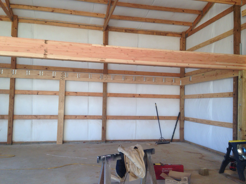

Lots of good info in the replies from everyone. Here is a glulam i just installed in my building.
Nice job on all the joist hangers. I've found that it's easier for me to install the joists first, then come back and install the hangers after they are in place.
   / I-beam size 30' span #57
Are those hangers the top mount kind or face mount only.
On the top mount kind, I like hanging all of them first with ONE nail in the top. That way you dont squeeze them too tight. Drop the joist in and add the rest of the nails.
For the flush mount kind, I agree with eddie, easier to go back through and add later
   / I-beam size 30' span #58
So you guys toenail the joists in place or what??
   / I-beam size 30' span #59
Depends on the hangar I am using and the design of the build.
Something like a deck perimeter or anywhere I can get to the back side of the leger, easily and be able to hold the joist right where I want it, I screw or nail in through from the backside to hold in place. Then add hangars later.
I try not to toe nail anything that is going to inter fear with the hanger. Cause toe nails go through the hanger later. But I really do like the top-mount kind. Assures all the joists are level and the same height, and easier to install the joists and hangars with that style IMO
   / I-beam size 30' span #60
Yep, I can see that. In Bryan's case he can't access the backside. He can't nail a 2x4 along the ledger to sit them on. If he's not going to toenail, how would he fasten them in place before installing the hangars??
