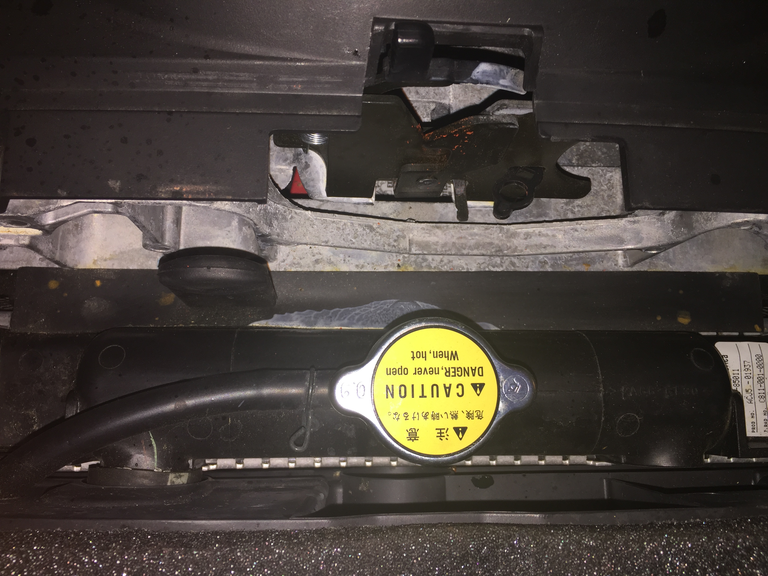

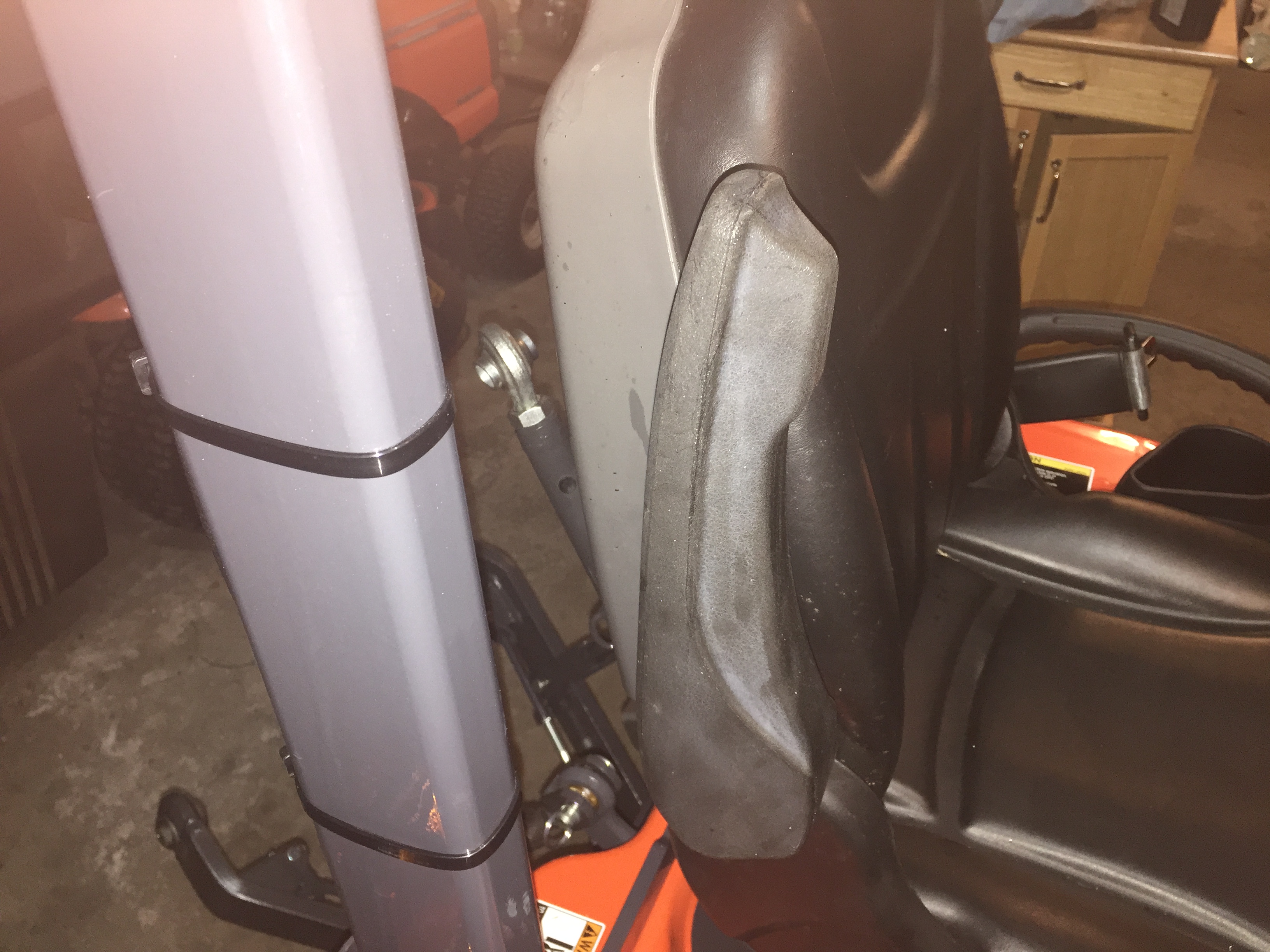

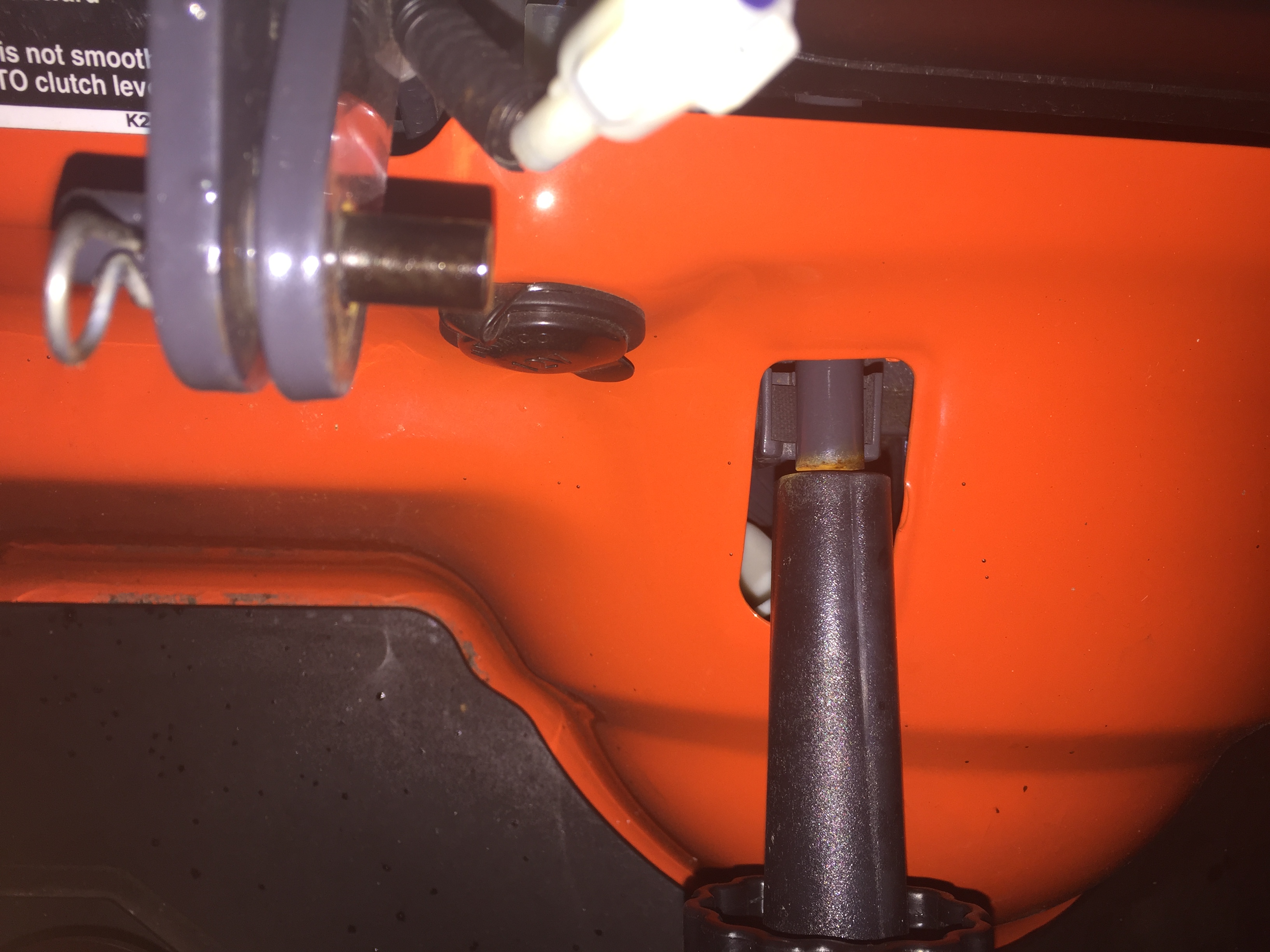

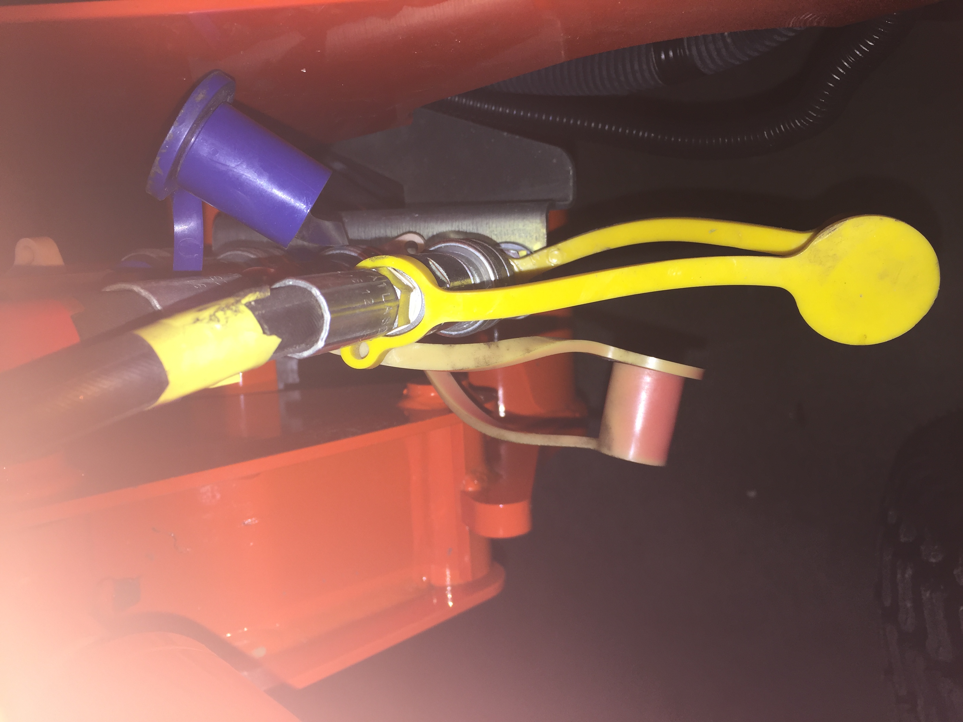

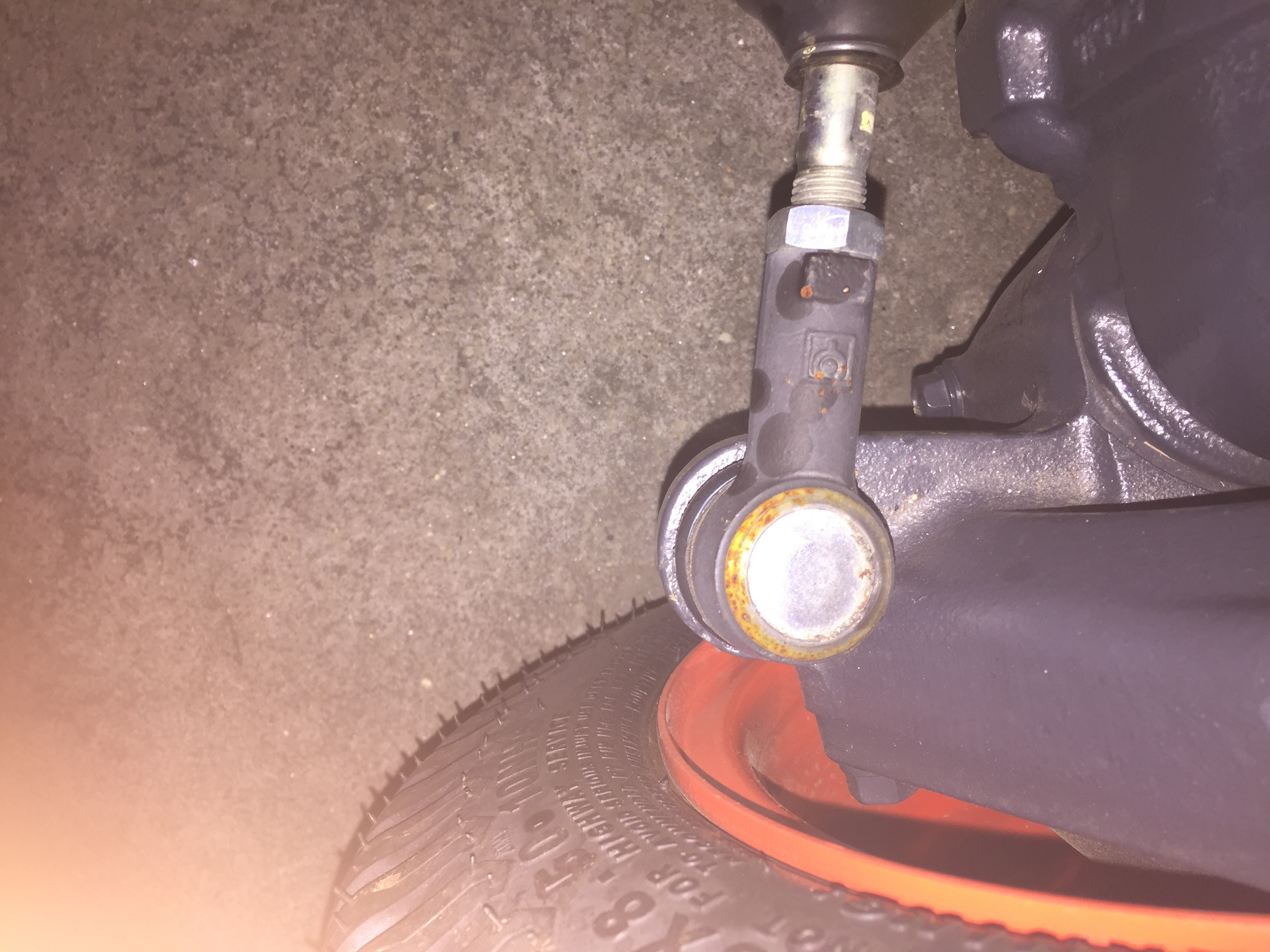

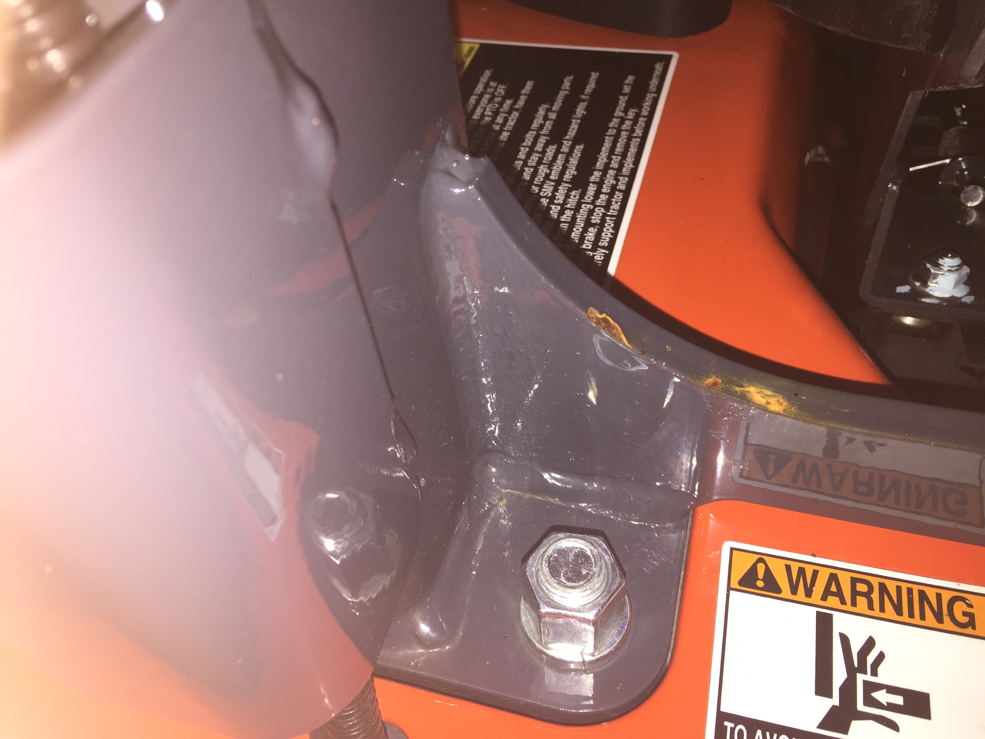

I looked carefully at all the photos, and none of that rust is serious or out of the ordinary. It certainly wouldn't bother me. BX tractors come partially assembled in an open-frame crate, and may sit outside at the Kubota plant or at the dealer for months before they are assembled for display or to sell to a customer. I didn't see any fading; if it was a real exposure problem, the orange paint would look faded or chalky, but the orange paint on that tractor looks great to me.
I wouldn't worry about it at all. I don't think another tractor will be any different.
The B and BX's are in a plastic covered crate.
