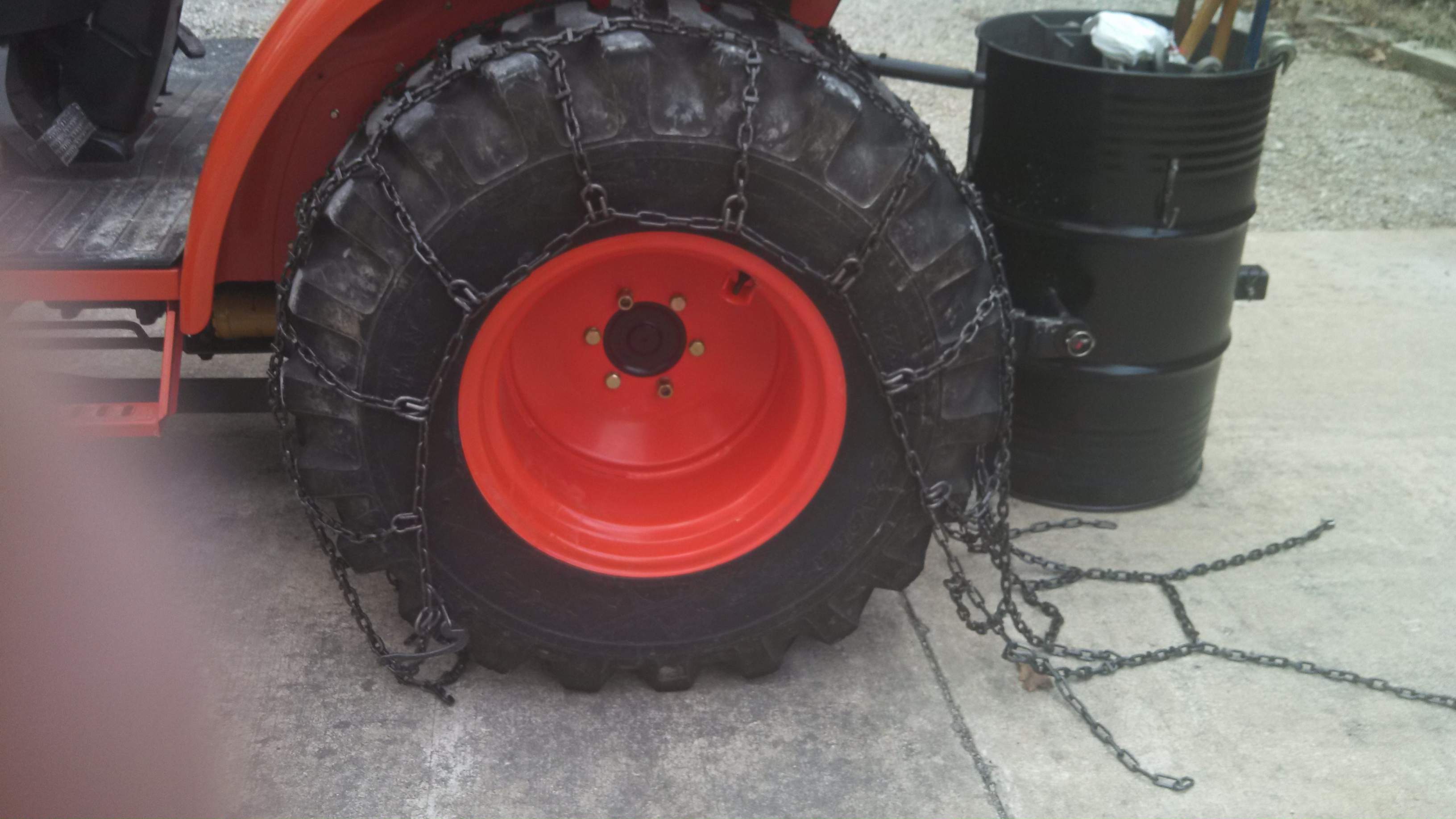

I also noticed 2 wheel bolts on a rear tire were installed backwards
Two of the wheel "bolts" of every Kubota are always installed backwards. They are studs so you can mount the wheel. My Kioti is the same.

Trust me on that one.. Two bolts stick out and have nuts on the outside, the remainder are are screwed into the axle hub. This is done for a reason. Go to the kubota (or any tractor lot) and look at the wheels....
   / I bought a brand new tractor with rust, fading and electrical issue. Paranoid? #69
On the lack of trans fluid on a cold dipstick, I don't think many --or any--show it till warm. Mine doesn't show but instead you have to warm the tractor up, shut it down and then check it. I have a B7800. If you fill cold you will overfill.
If you didn't have two studs on the wheel, you would never get a wheel back on. The two studs make life much easier. I believe all of mine are that way. I have a Brillion cultimulcher that doesn't have that setup and a wheel change is a frustrating experience.
