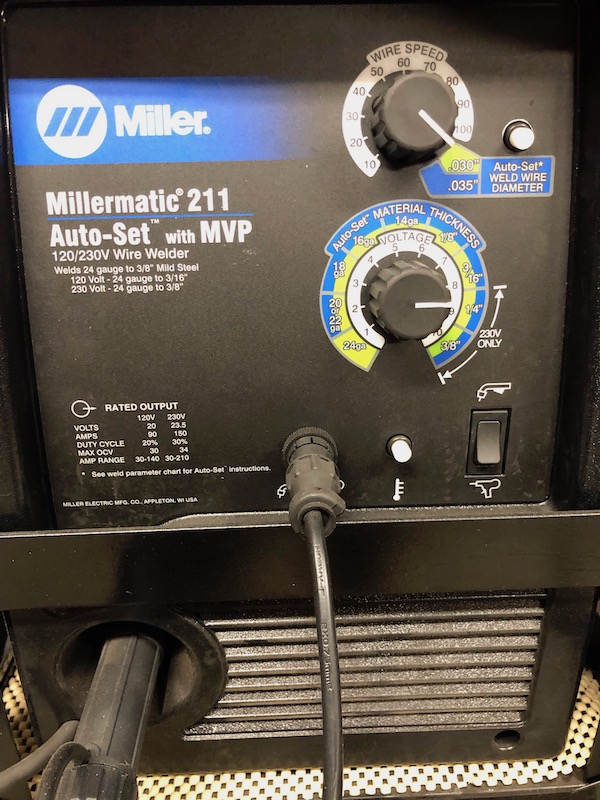

I like the Miller online table but I still wish there was a conversion chart that showed what the numbers on my 211MVP gauges meant in terms of IPM and Voltage.
:anyone:
So are you saying you have no way of knowing your IPM or actual voltage?
Then the online calculator is of no value to you, correct? Im not familiar with that machine.
   / I can Weld, I can't weld, I can Weld, This is getting very frustrating. #45
Yep, exactly. Here is my panel.
You tell me!

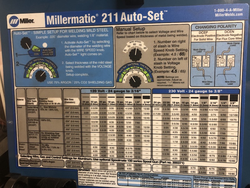

In fairness, on the inside cover I have this extremely handy chart... but I would still like to know IPM and Volts! :smiley_aafz:
I'm not complaining about the performance of this machine... it is far better than my capabilities no doubt. Just wish I knew the 'numbers'.

Door chart should be pretty darn close, maybe better the generic online calculator... Finds the values for my HH140 spot on...
