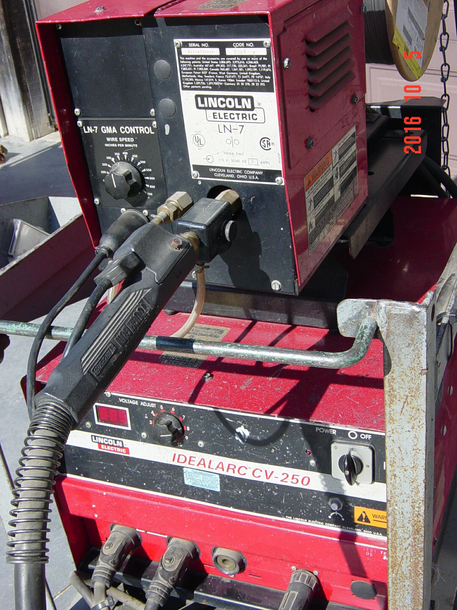

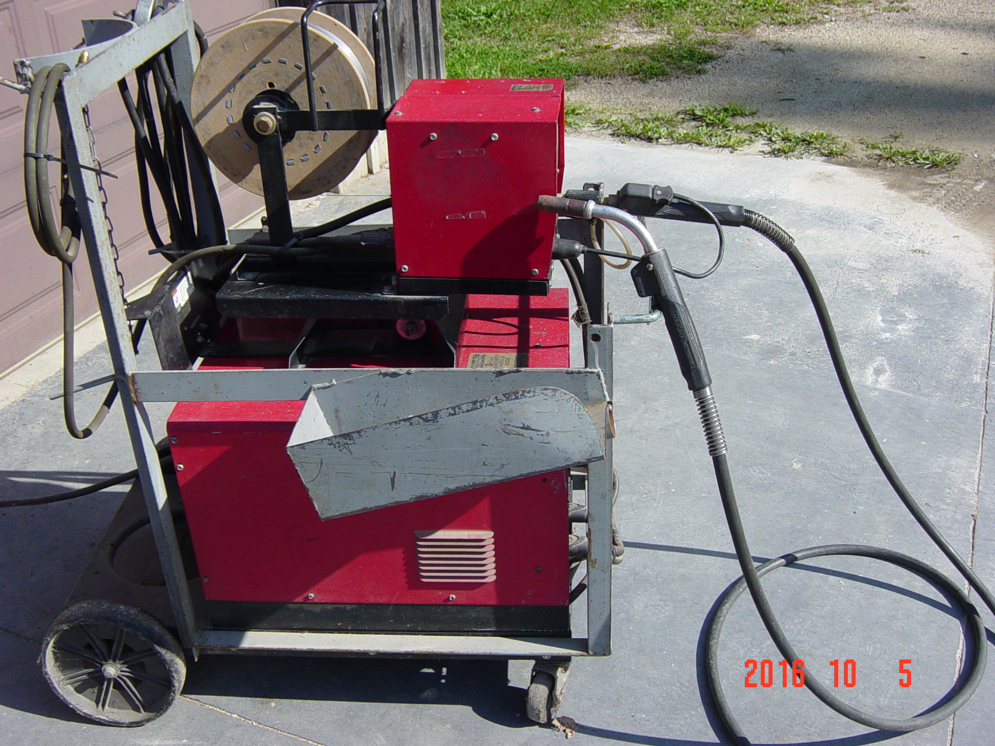

Yes, all good suggestions. I like the idea of having a "real" welder try my machine, but I take enough of their time already. I did run it past one this morning and he questioned a possible issue with my liner or feed roller settings.
Funny, I had issues with my Big three phase Lincoln, running off a converter.
A certified and life long welder used it to weld a very heavy chunk of pipe for me and thought it didn't have enough power.
Funny, I had issues with my Big three phase Lincoln, running off a converter at 600 volts.
A certified and life long welder used it to weld a very heavy chunk of pipe for me and thought it didn't have enough power. DSC04378.JPG
SOLD that welder because the computer didn't like the fake phase and stopping and starting the rotary converter was a pain.
