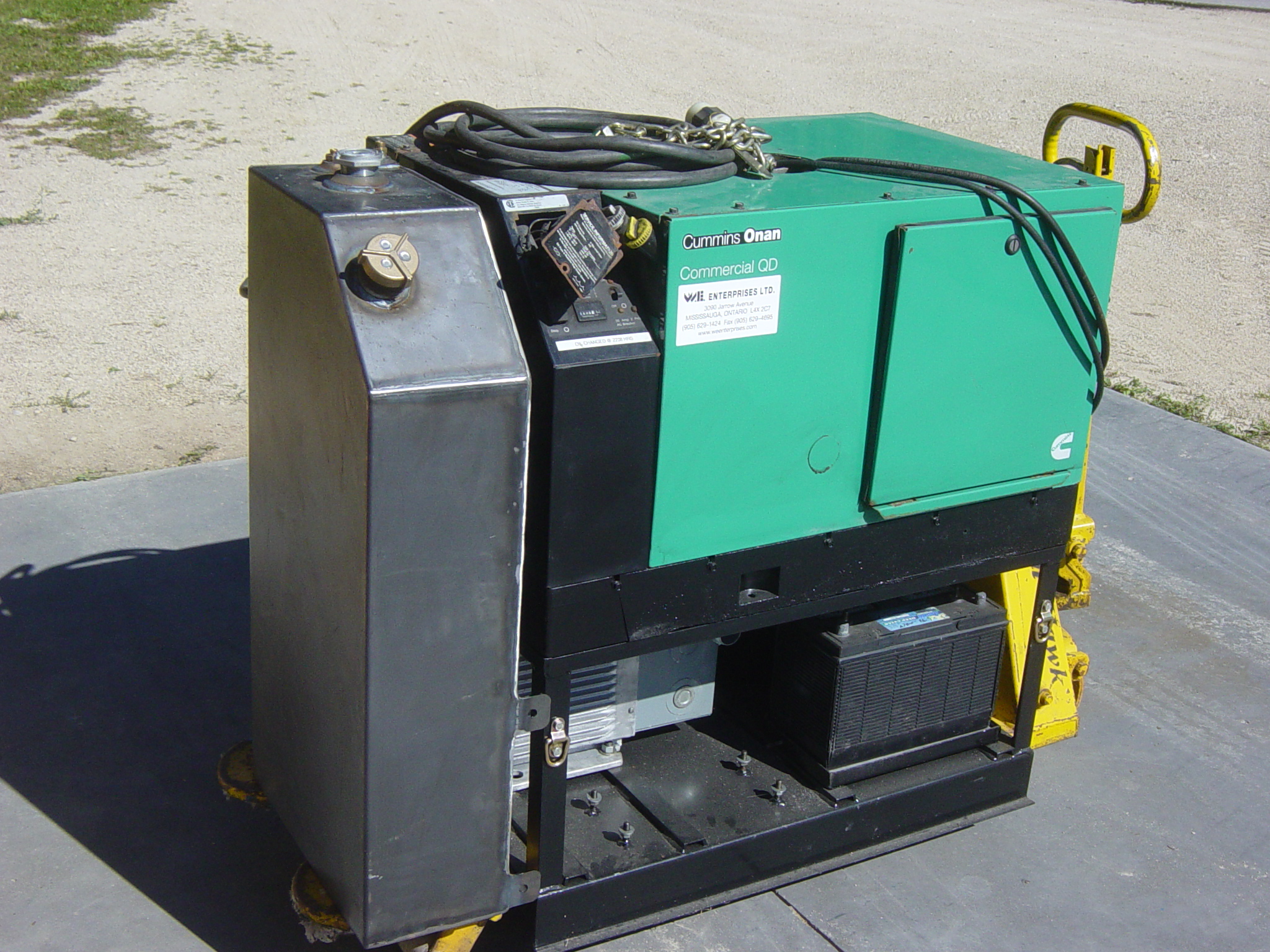

Had some frustration on the weekend. Had a fuel tank laser cut, formed and welded, but I screwed it up and had to make corrections for the mounting tabs. 10 or 12 gauge mild steel.
I couldn't get that Lincoln to weld right on this thing that matters to me, to save my life.
As usual, most of the time, the 035 just explodes when starting the arc and fuses in a ball to the tip.
Then, it sounds more like a torch, without the sizzle, probably like spray transfer but ugly.
So, consulted the chart, which I didn't know was there. And kind of got it sounding like a MIG should, but it seriously seemed to lack any power. Checked the electrical jumpers again, in case I had selected the wrong voltage (running on 230 single phase).
I got it to weld, but with my stitching habit, learned from stick, there was way too much filler, but not too bad a looking weld.
As far as the light goes. It was in bright sunlight, and I couldn't see bugger all. Just the ARC.
Testing the thing for leaks was way more fun! My friends welds were flawless, and I was interested to learn that he had used the same welder I have at their shop.
Needed a diver in the water for this more comprehensive test. lol Told the Lady friend to look for me on the next property if she blows!

It was meant to be part of my "quick and easy" conversion of a mobile Onan Generator to Stationary use.
   / I can Weld, I can't weld, I can Weld, This is getting very frustrating. #79
Nice! I figured it was something like that with the orientation of mounts and fittings.
