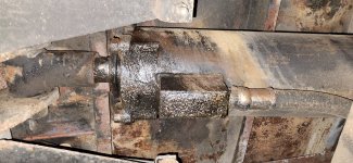

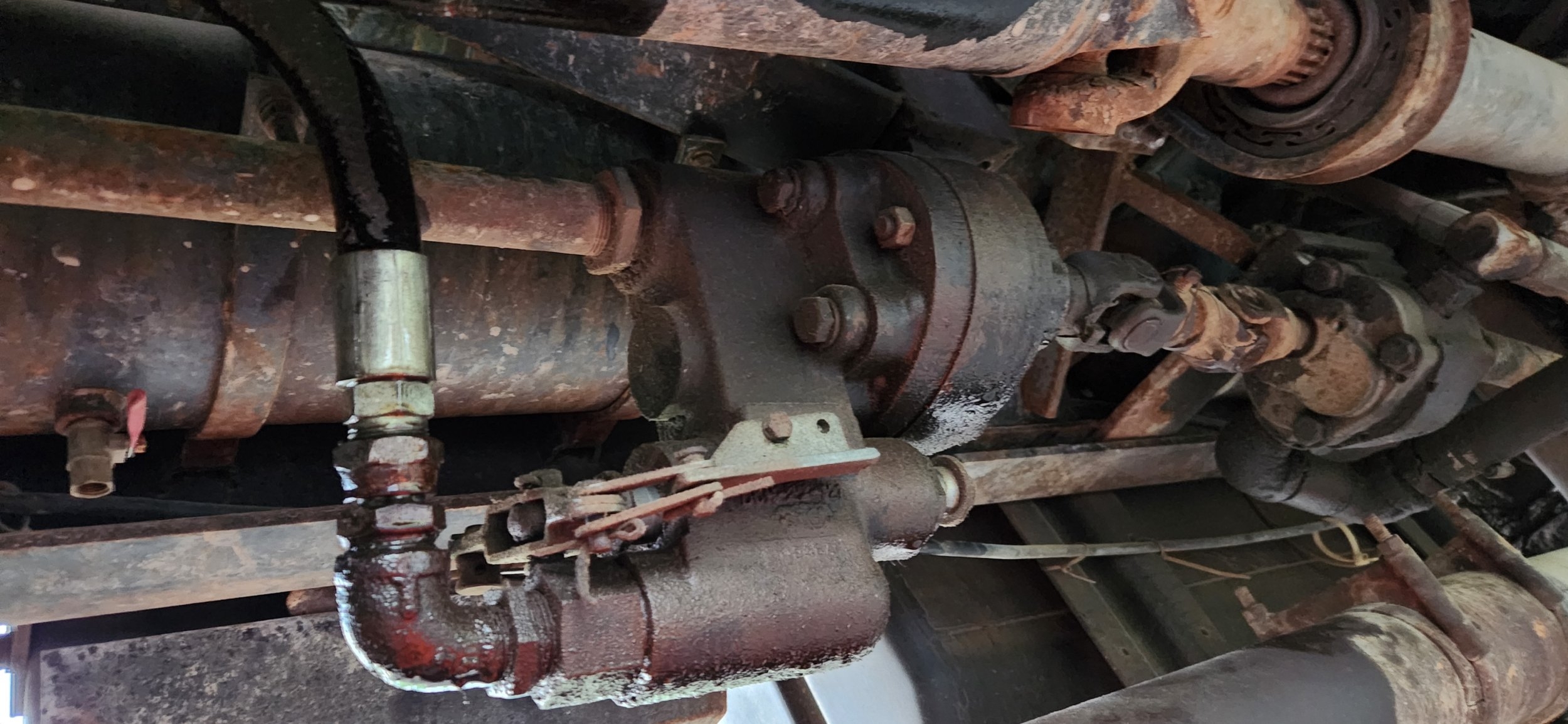

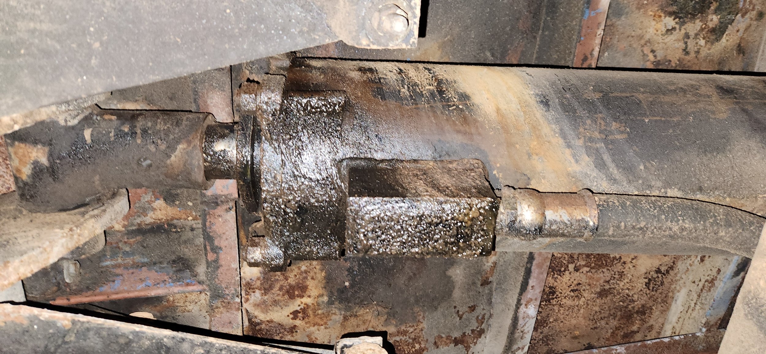

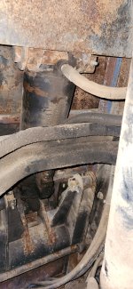

I have moved many, many loads with the truck so far. It's developing an issue. I didn't notice until it got pretty bad but the clutch peddle has developed a lot of play and does not disengage the clutch until the peddle is on the floor. It is a mechanical linkage that runs straight down through the floor.
Can anyone give me a starting place? I was so tired and hot yesterday when I noticed it that I didn't have it in me to crawl under the truck to do much investigation. Please tell me there is a linkage that can be adjusted...

The linkage should not need to be adjusted unless someone has already moved it. The clutch needs adjusted not the linkage. On the bottom of the bellhousing it has a inspection cover its probably missing. Bump the engine around till the adjuster is straight down and adjust the clutch. It could have a lock that has to be removed just according to the style clutch. But to adjuste have someone hold it to the floor or get a bar and hold the pedal down and adjust the clutch. Adjust it till you have about a 1/2" free play.
So sorry you were hot and tired. The rest of us were cool and well rested.
Have a look at the linkage underneath and decide for yourself. 1-2" of Free Travel should be about right.

I'm lost now... what do i adjust? It looks like the allrod of the linkage is clean on the ends. Maybe try to tighten that a bit i guess?
