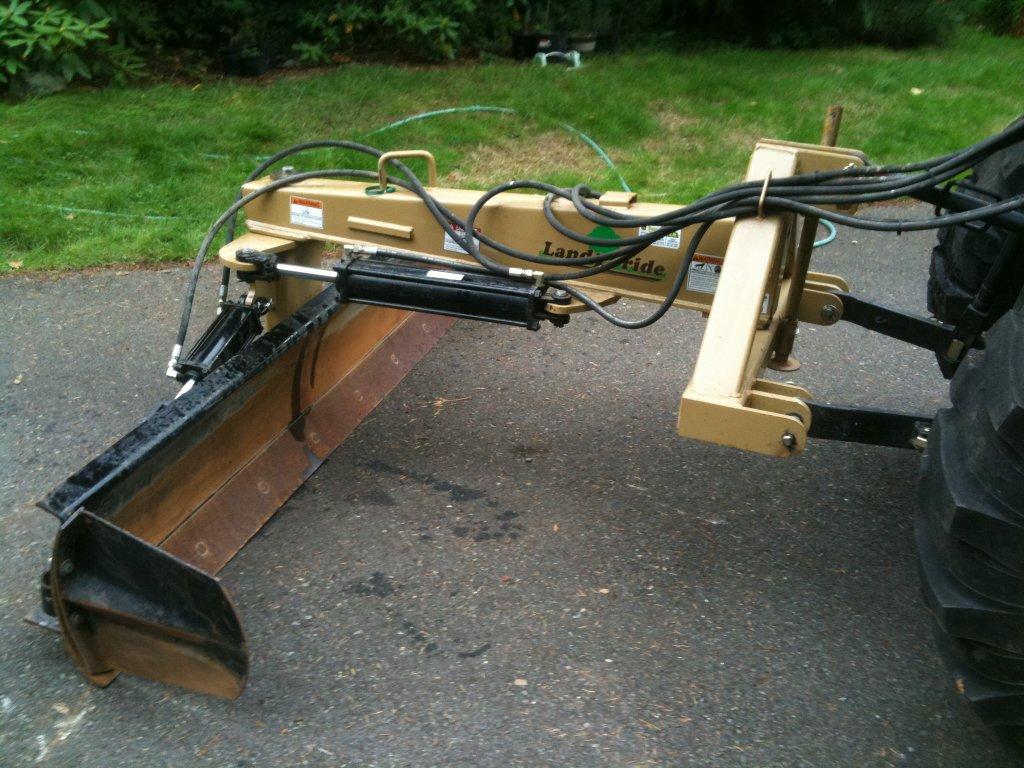

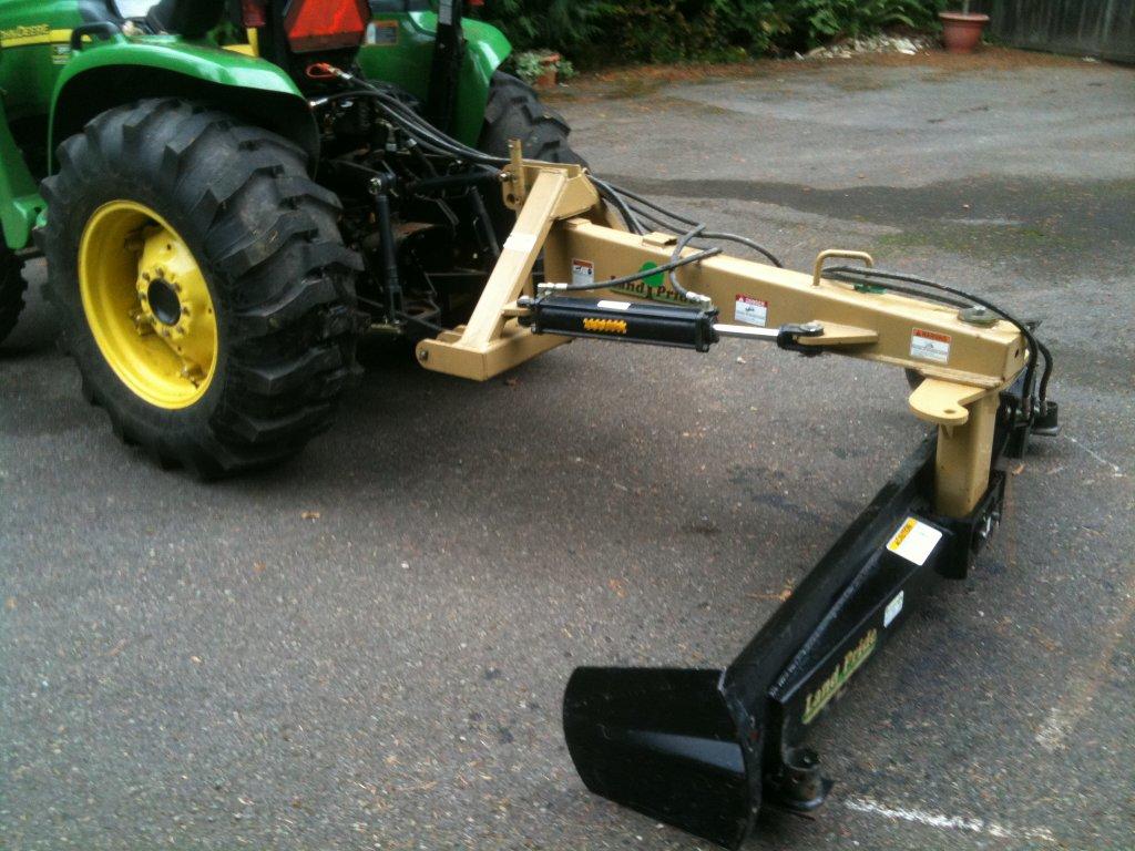

Rear Blade I nearly forgot. Pictures of my landpride RBT3584

   / I nearly forgot. Pictures of my landpride RBT3584

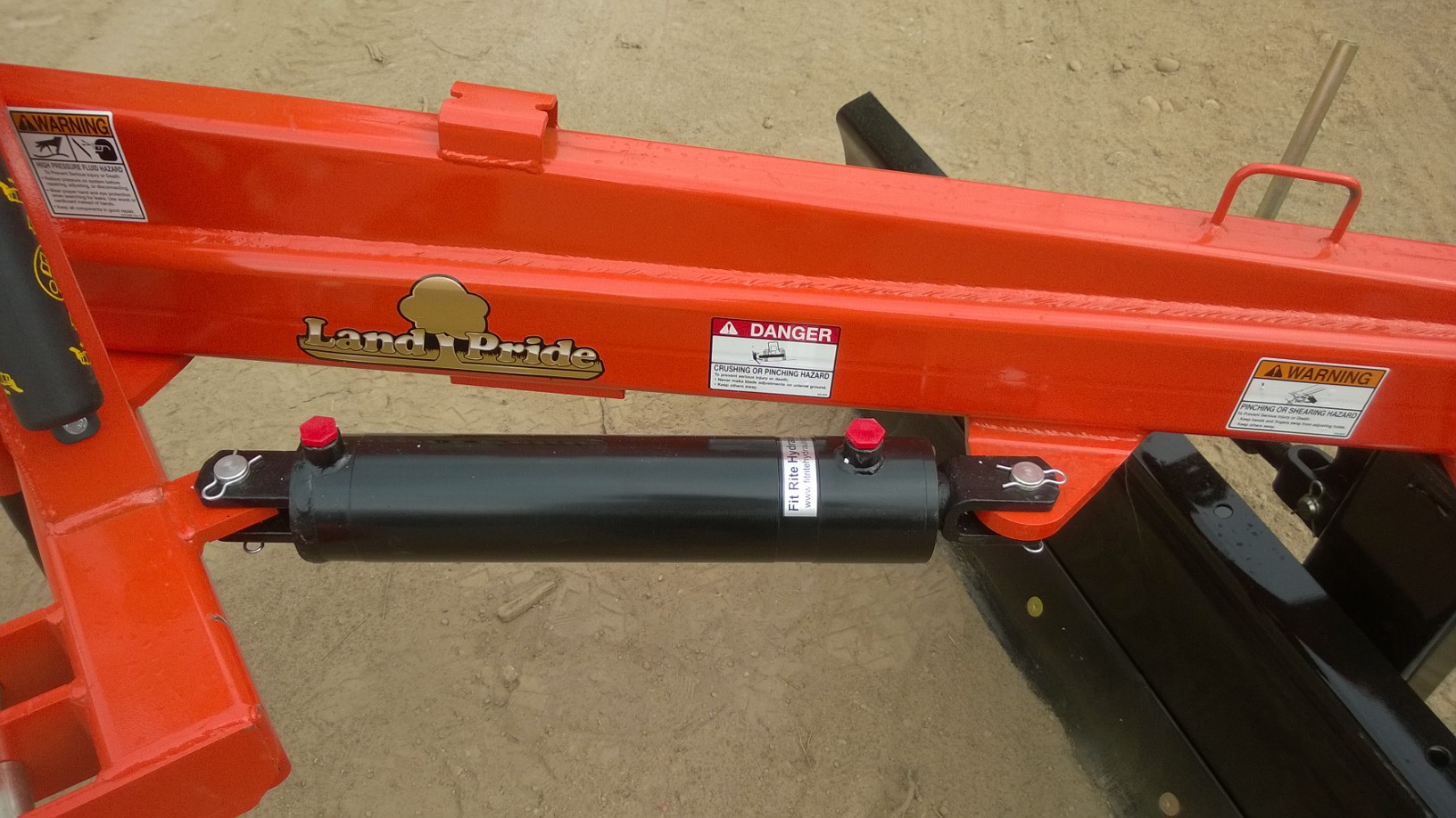

Got my rbt3584 this morning.
Ordered it without offset and angle and I bought a pair of cylinders from Brian. His cylinders came well packed looking well made and even included spare pins and clips which is a great touch as I am sure I'll have one disappear at some point.
I'd love pics of how folks have done the hoses that work out best in terms of full movement, not catchin on things etc. The pic that came with the hyrdaulics show the ports on the outside which I like the idea of, but mine came with ports up.
So what seems to work best? The OP's offset had hose connection facing eachother (on top) and the angle looked to be both pointed to the side (same direction as hoses).
A dumb question: can I move the cylinder before I attach the hoses to make it the right length to fit on the blade (I an thinking the angle hydraulic, the offset was easy to move the whole blade) or do I need to attach the hydraulics first to extend the shaft to attach it?
Here's a pic of on of the cylinders on my new blade.

Since you bought the cylinders from Brian I will defer to him for the answer to your question.
What I will tell you is that when I got my RBT4096, used, to ensure that I did not contaminate my hydraulics I did a thorough cleaning/flushing of the old oil from the cylinders and hoses and it involved multiple movements of the cylinders full range without any problem at all not connected to anything other than a drain bucket.
Here is a set showing the routing on mine. Came this way works well.

Yes you can move the cylinders without having the hoses attached, you will need to take the plugs out though. I would point the 90s at each other, run the hoses to meet at the center of the cylinder and then run them up along the boom through the hitch and up to the female couplers together. Do the same thing for both cylinders. This keeps the hoses together & neat.
Try routing them a few different ways and see what looks like works best. Seems like everyone has a different idea of how this should be done. Plus your hoses are not a mile long like the LP hoses are. :rolleyes: So you can only do so much. ;)
