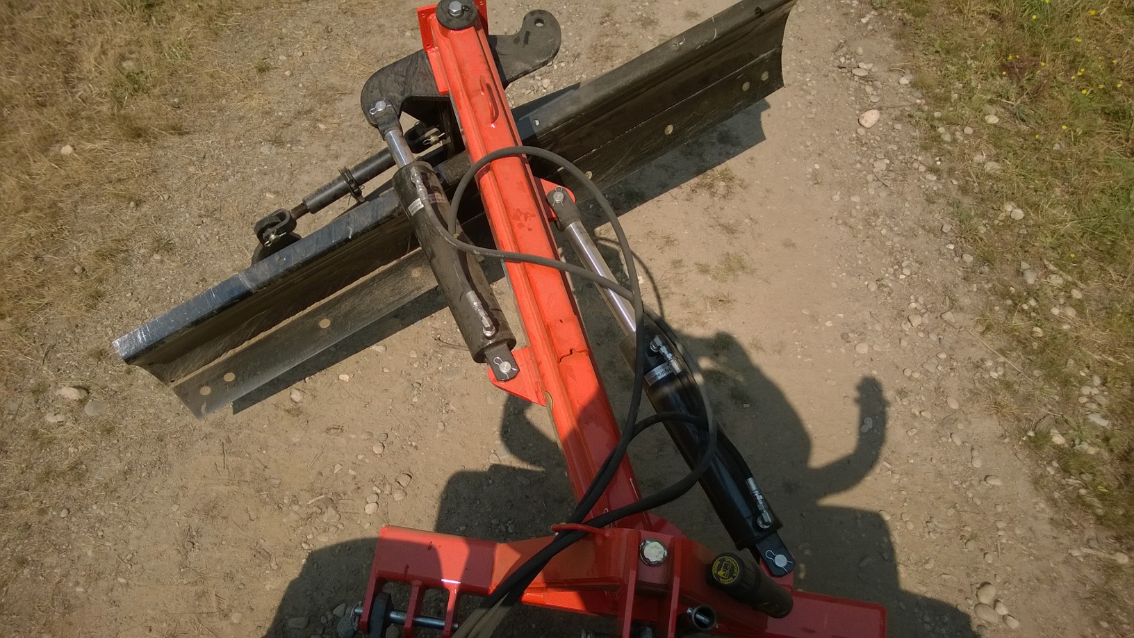

first try. Not quite sure what to do with the set of hoses not plugged in (only have one extra remotes for offset and angle).

Yes you can move the cylinders without having the hoses attached, you will need to take the plugs out though.
That was my mistake, I couldn't believe how hard the cylinder was to move when I took it out of the box :eek: I almost thought it was froze up or something was wrong, then I finally realized I needed to take those plastic plugs out :laughing:
You were smart to order the cylinders from Brian, I saved half the cost and got a better cylinder to boot. Mine already had the angle and tilt, but not the hydraulic offset, and you can really tell the difference between them.

Man, I love those blades. They are one NICE IMPLEMENT. :cool::thumbsup: Hoses look good to me. Maybe try a few zip ties to bundle the hoses together from about the empty bracket on the top of the boom for the angle hoses.
Not sure how high your 3pt lifts the blade with the boom level to the ground, but if that is high enough for most of your moving around, set the top link, unplug it and then plug the offset cylinder in. That way you have tilt, offset and angle for working the blade.
If you need to constantly use the top link to get the blade up high enough for transport, then that may not be a good alternative for now. :(
Need to get a diverter system to be able to have all 4 units available at once. I've needed to do that to my big tractor for years now, have everything to do it just sitting here, no time to do it though. :(
Let us know if my ideas, if you choose to try them, work out for you. Maybe a few more pictures too. ;)

I am pretty impressed with both the blade and the cylinders. Blade is kind of expensive but I am glad I spent the extra bucks rather than go the economy route like EA or something. This thing seems pretty well made, although I haven't used the gauge wheel yet.
Adding the cylinders are a trivial install and I recommend anyone getting the blade to get the offset and angle from Brian. I thought it would be a bit of a hassle but it wasn't. He packaged the stuff awesomely and had hoses and angle connectors and spare pins and clips all supplied. And shipping the blade without the adjusters to me was no problem because LP simply screwed a couple 2 x 4 struts in place of the adjusters.
What I am working on first is ditching and crowning some narrow and very unlevel (in all directions) roads in my woods. So there is a learning curve to find which top, tilt, offset and angle work best at any one moment.

I may be wrong,:confused3: but I would guess that out in you woods may not be the right place to try out the gauge wheel system. :eek: What I have found with my RBT45108 is that the blade works best with the boom parallel to the ground. That has the camber of the cutting edge where it works best in my opinion. Once that is set with the top link, my top link doesn't get moved again except for transport. But that is me and my conditions, your conditions are different I am sure.

For now I am not using the gauge wheel in the tight winding roads in my woods. Once done I may take a pass across the center with the gauge wheel though.
I'll pay attention tomorrow as I work some more, and it could be that your advise to keep the top link "fixed" will work for me. I would love to have the offset and angle both connected.
Where I have been using the top link dynamically is it gives me yet another way to tweak where the blade is physically with the blade tilted and angled and offset to the side. I can't describe (don't quite understand yet) the dynamic of tweaking the top under these conditions, but it definitely changes the position of the blade relative to the ground which sometimes seems useful.
Basically I need more time with the blade to better understand the interrelationships. But I am pretty pleased with the potential, and it's a completely different purposed tool for me from my BB.
Also the advice folks had not to have the manual offset (like I had planned to) seems like good advise. Under certain unlevel conditions, offsetting the blade manually would be a wrestling match.
