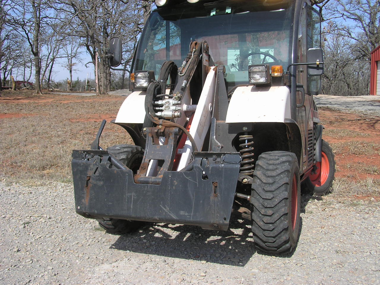

I just received this email from Titan. I think it speaks for itself. As a lot of you said they recognize and deal with problems in a fair way.
Hi Gordon,
Thanks for contacting Titan! I do apologize for the fit issues you had with our mount plate. Glad to hear you were able to fabricate it to work though. Normally in this scenario you should call us so we can discuss options, but I can understand if you had a time constraint. We would be willing to offer you a 25% partial refund off your order for the inconvenience. I'll wait for you to respond before I proceed.
Thanks,
John
gg
   / I Need to Custom Fit a TiTan SSQA Plate-Advise Welcome #45
Update - Titan shipped a nice SSQA plate that was received at my work location on Wednesday, just as they promised. The plate was quite a bit nicer than the first one. The build is done in time for the snow we might get tomorrow. The email Titan sent was interesting:
"Thanks for contacting Titan! I do apologize for the slight quality issue you are having with our mount plate. I was able to place an order for our United Attachment 3/8" mount plate to ship to you and sent you an email confirmation. These come from a manufacturer we use in the USA and have tend to have more accurate dimensions. I see that you have another ticket open as well. I will be closing that one as well. We appreciate your business and hope you have a great weekend ahead!"
   / I Need to Custom Fit a TiTan SSQA Plate-Advise Welcome #46
It sounds like all of their imported stock questionable so they are sourcing them from a USA fab shop.
   / I Need to Custom Fit a TiTan SSQA Plate-Advise Welcome #47
I also had a small fitment issue. I fixed it and called titan regarding it. I now just build my own. It's easy and I clamp it to the quick attach setup so nothing moves while burning it in. I've made 6 so far with no problems. The titan plate had an issue at the bottom where the pin slides through and the top angle was too short of a plate piece. I just cut the bottom and welded it back together and added plate to lengthen the top angle. Haven't had issues with that plate. The new plates have a wider angle piece on top so there is no chance of the quick attach sliding off. I've been experimenting with plate thickness and putting them to the test of bending. Most of my plates are 3/16 with 1/4 top angle and bottom angle. Nothing has moved on them and I cut and haul large hardwoods for splitting to heat my house and workshop.
   / I Need to Custom Fit a TiTan SSQA Plate-Advise Welcome #48
Wow, I'm glad I found this thread. I too ordered a QA plate from Titan around the same time as many of you, and also had problems fitting it. Strange thing is, I brought it to work and tried the plate on a Bobcat set up and it fit on their much better, granted that setup has been used for years and could be an older setup that's worn down. BUT I did take some measurements and found it was around a 1/2" short of the over all 18.5" they say it is. Luckily I haven't welded anything on it yet, as I've been busy with other projects, so I guess dropping them an email might help my problem.
