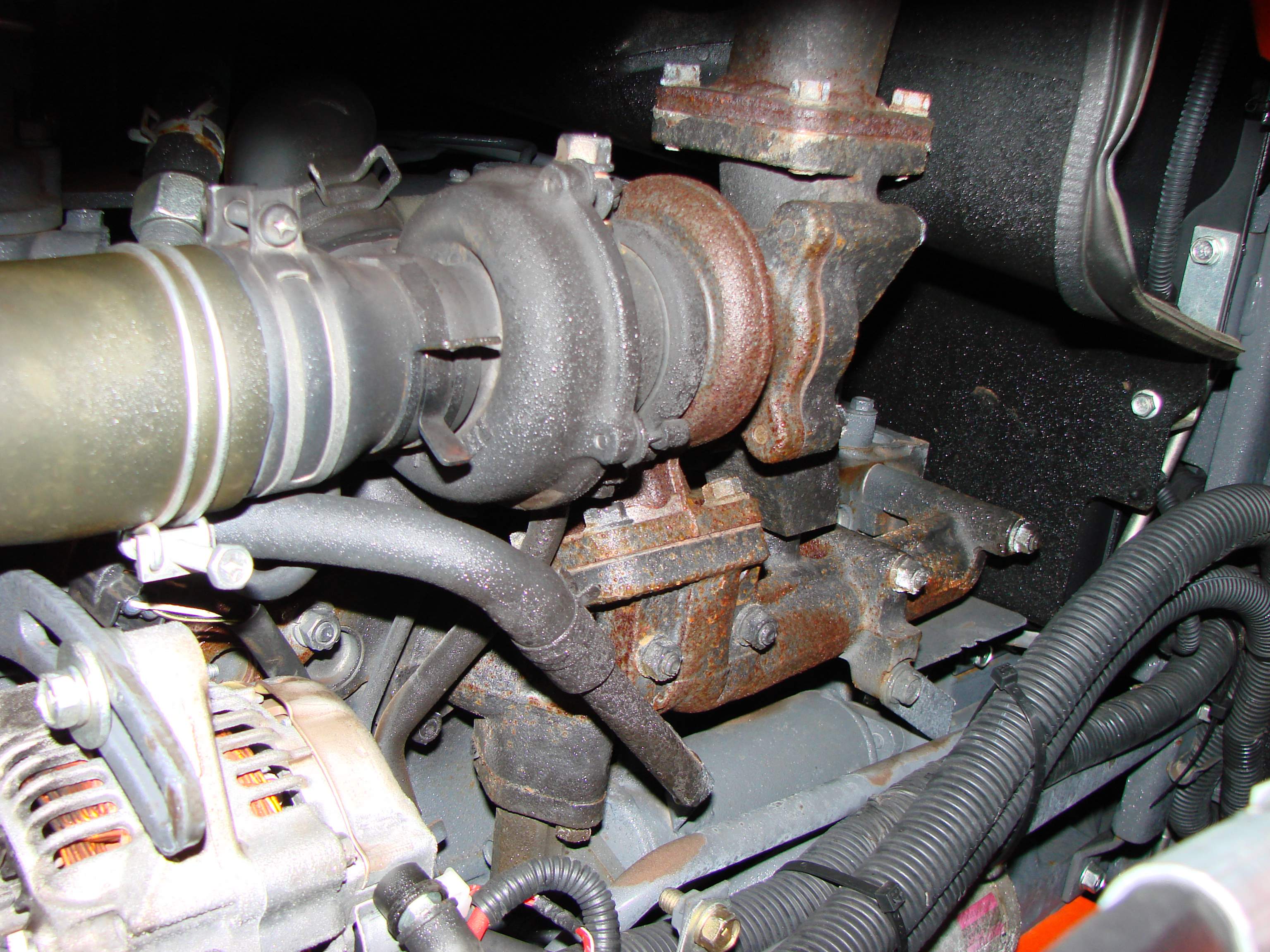

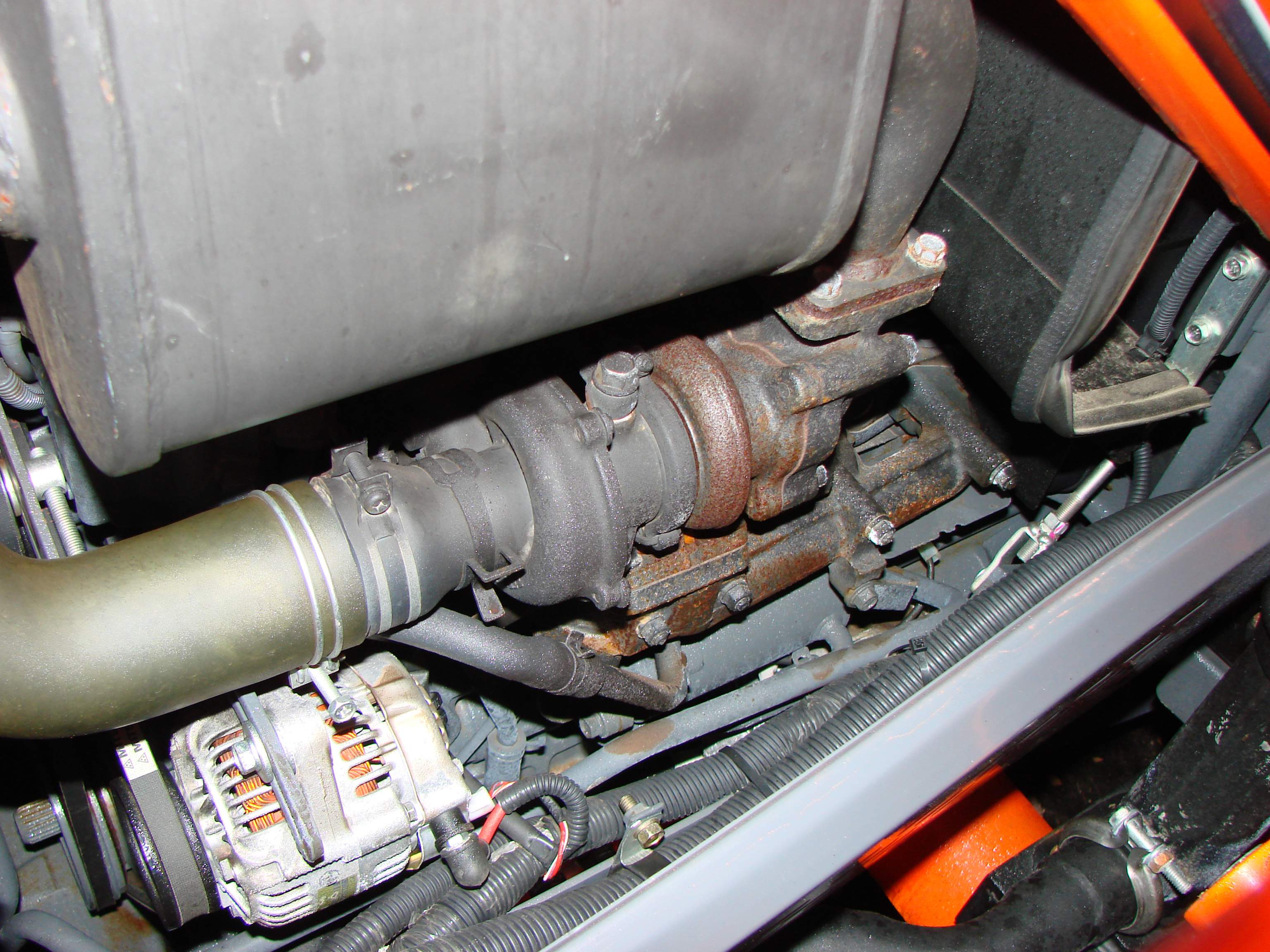

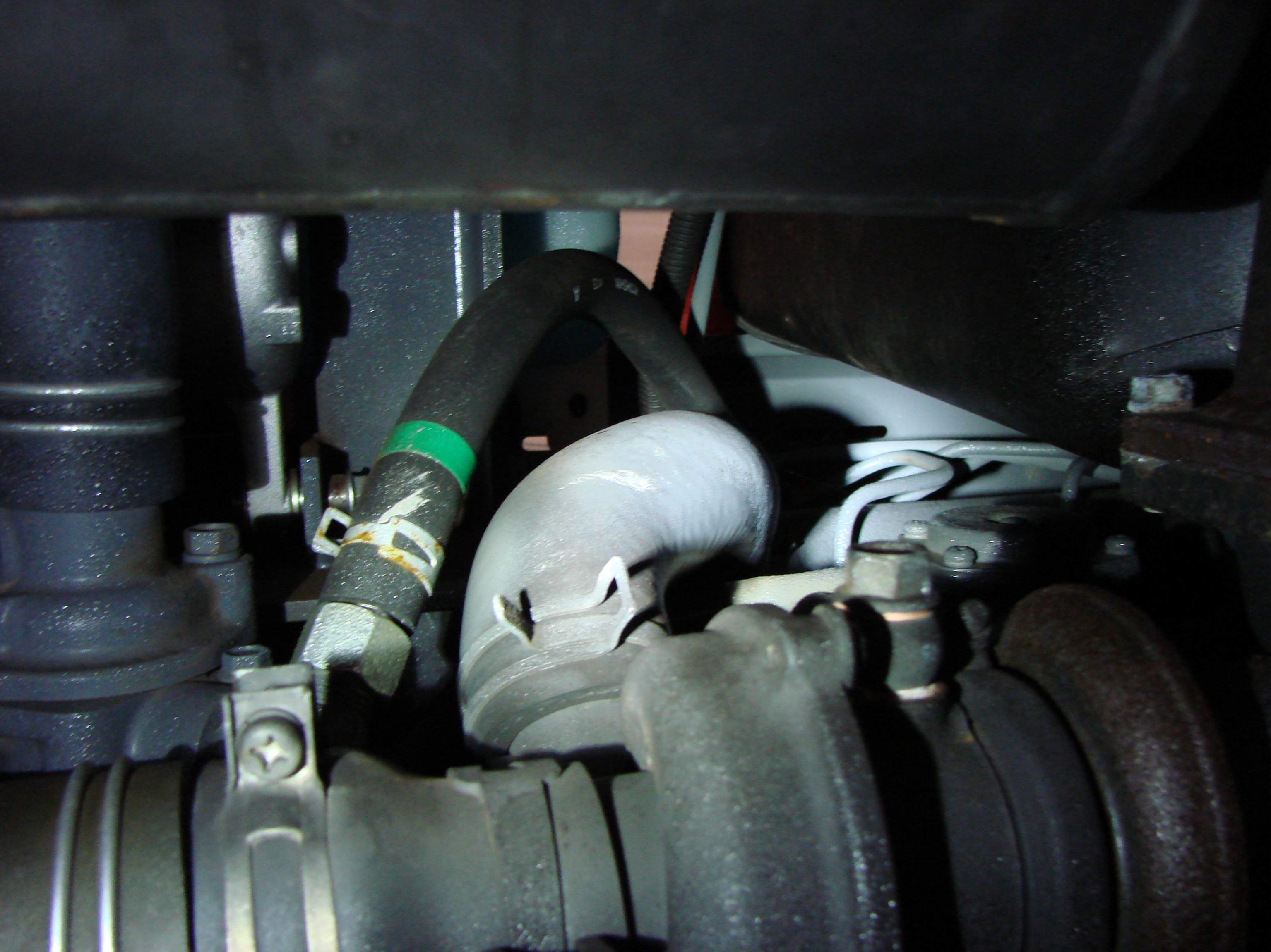

Anyway the turbo IS going on this thing. Why not just help me along? I'll take pix if you like but warning my work is not as neat as that guy 4Shorts. My welds look like bubble gum. I use too many wire ties but I use black ones.
Fred

Thank you. Coming from you that's a real compliment:rolleyes:. Bad welds or not about the only help I can offer you is detailed photos of our 5740's turbo set up and I do have the WSM for these tractors so if you don't have the WSM (Work Shop Manual) I can get you some info.

I wonder if one or two glow plugs have been cooked to oblivion by now. (hope not) Multiple repeat cycles can be hard on them (BTDT), and cyls not so preheated will smoke for a sec on startup. (I don't recall the OP's block heater status/existence ...)
Adding a turbo should increase o'all power some, but how will boost be regulated, if at all? Waste gate, digital control system w/MAP monitoring, etc(?), it sounds like more than adding a hi-perf air cleaner to a gas engine. Maybe anything left of the warranty doesn't really matter. :confused:
btw: PowerStroke guys tell me its easy to 'chip-up' their hp until the rods/bearings won't take any more. Were talking a two liter diesel here, and its limits may be discovered the hard way. :eek: At easily 1k lbs heavier (with cab) than my little NH (few hp less) it could take a hefty increase to make the L3940 a real workhorse. (Mine isn't) I'd have traded up by now, just for the simplicity of it. Gotta wonder if power would have seemed easier to put to ground with a gear/shuttle drive vs the HST.
Good luck, Fred! Sometimes ya just gotta 'jump in' to see what's up.
