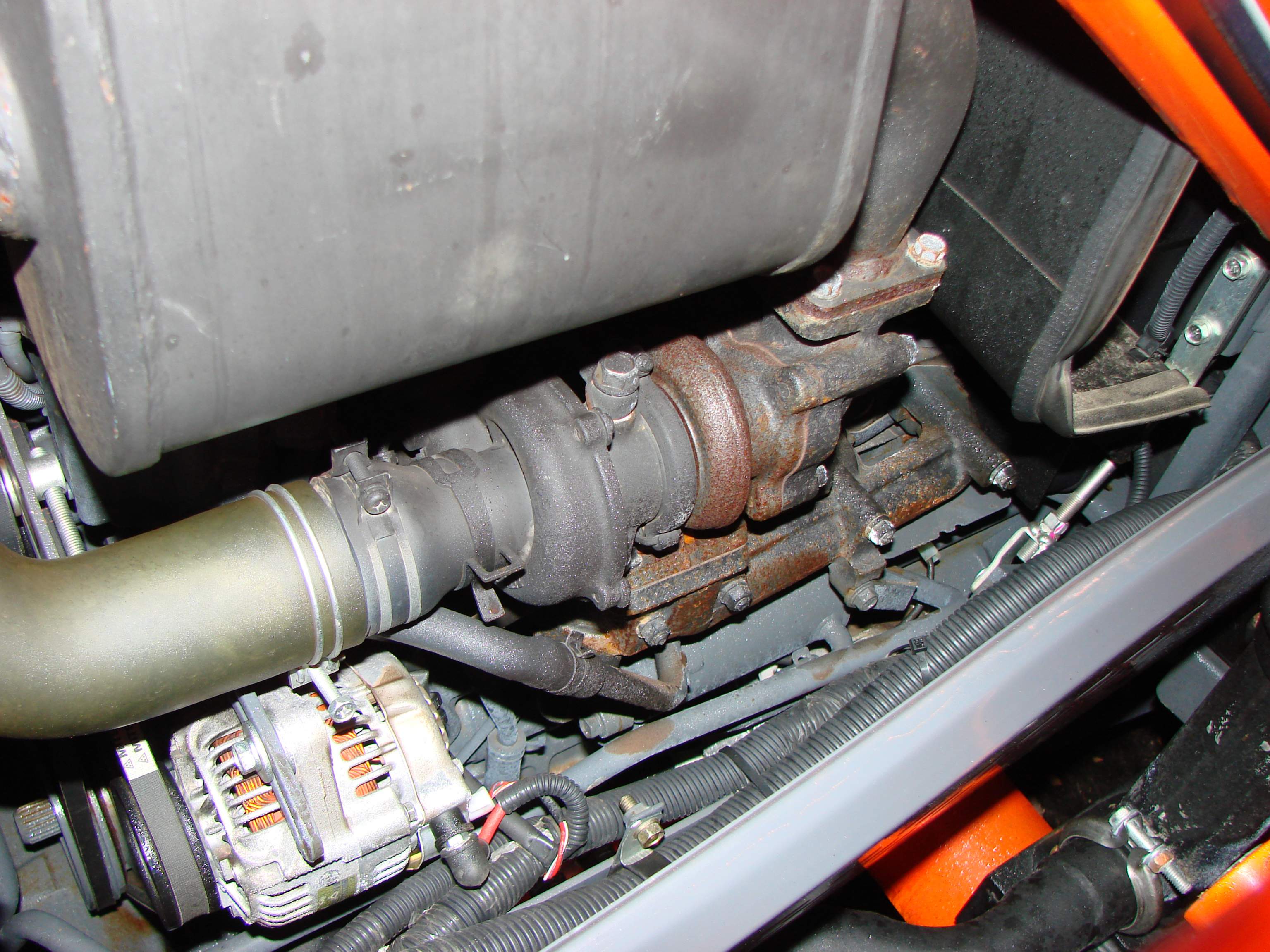

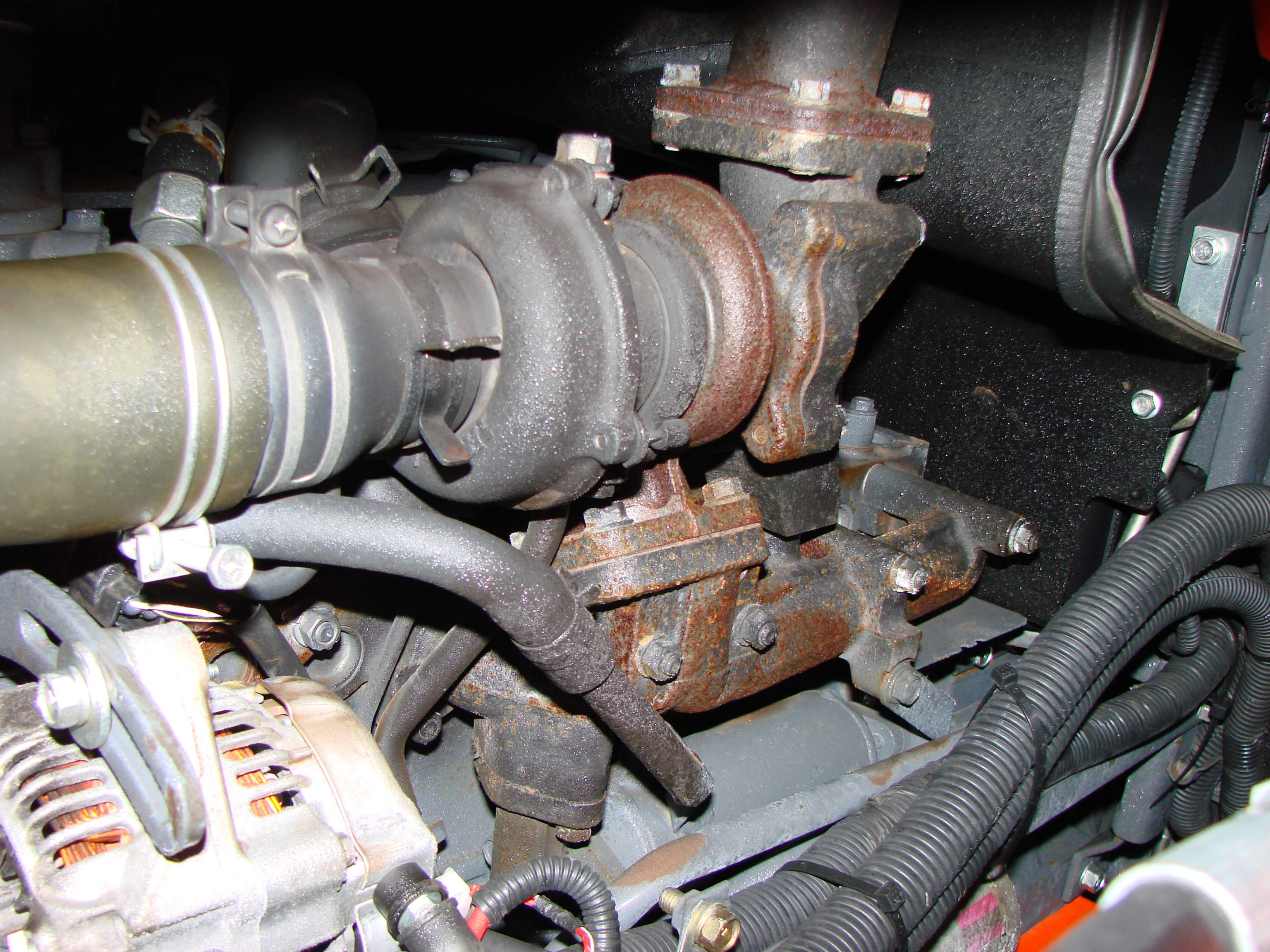

Not so sure about hotter combustion with the turbo. Heat does produce NOx, but engine makers added turbos to engines where they normally had N/A to reduce NOx, but some also added cooled EGR. With the turbo you are pumping in more air. Depending on how much fuel you are able to increase you might actually decrease combustion temperatures. My mechanical injection Tier 3 engines had cold start advance to help starting. Those were actually the highest peak combustion pressures we saw and had to use head gaskets capable of the high starting combustion pressure. My larger FADEC controlled engines had it all taken care of by the computer and my engines so equipped never had head gasket problems. As long as you don't go overboard with turbo size you should be in great shape. Remember too that higher horsepower means higher heat rejection into the cooling system so you will need to watch your temps closely until you get a feel. What a fun winter project. Me - all I get to do is go out and plow snow once a day.

Many folks on this forum blow snow at lesser than rated RPM that's why I started slow.

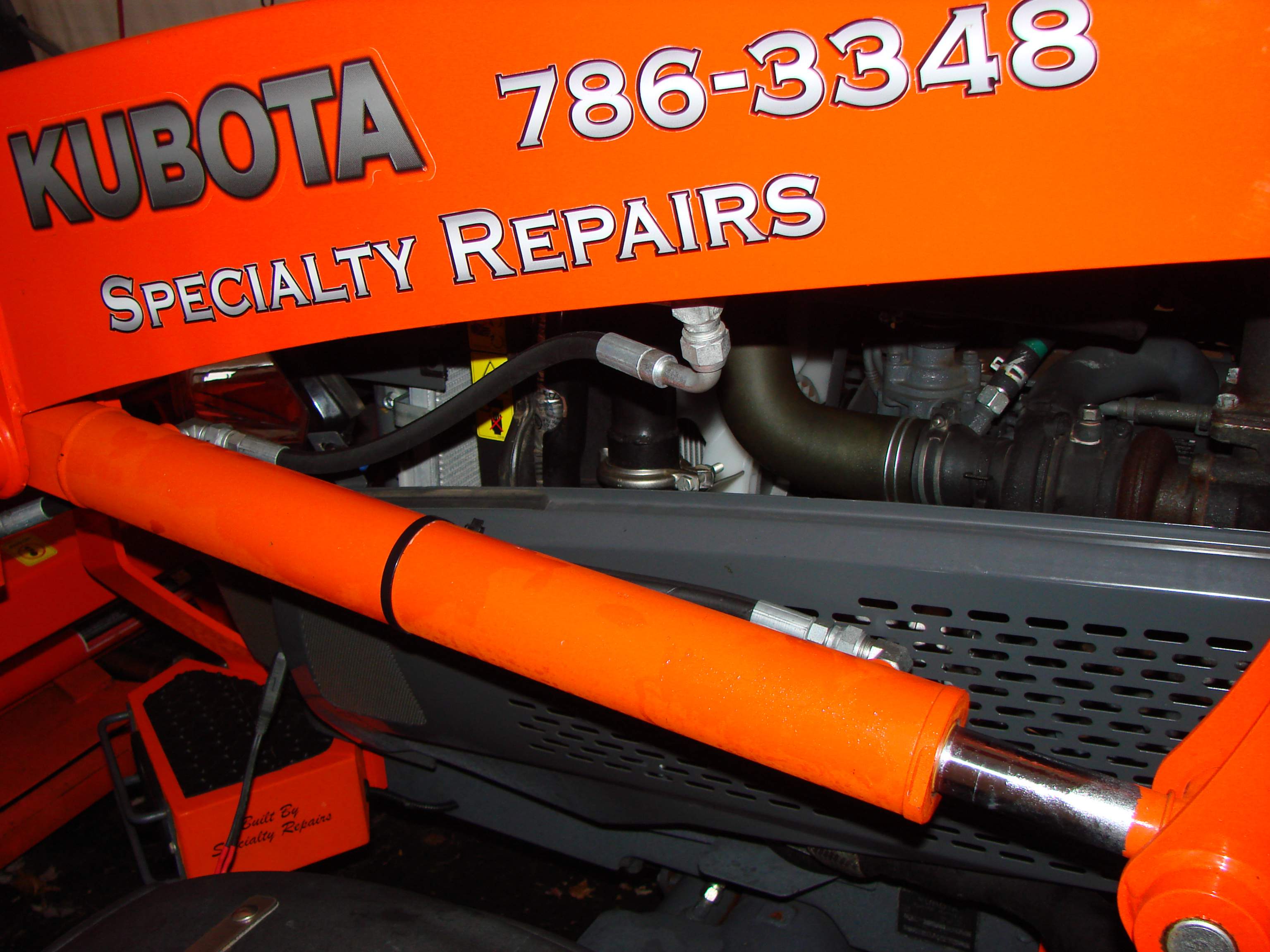

This V-2003 engine has no balance shaft unlike it's 2.2, 2.4 liter cousins. At full tilt it feels like the things coming undone. I can turn the radio up but that barely works.
I chose the turbo that fits the Bobcat skidsteer with same V-2003 engine, I wish I had engineering background I have NO idea how to look at A/R ratios and wheel sizes.

Why would you turbocharge something and kill the warranty when neither you nor the dealership has solved the fact it doesn't even start correctly?
I still agree - the expectations are screwed up if there isn't something wrong with the tractor. I have a L3650, also 40hp and a similarly rated PTO output. I moved 550 yards of top soil out of hills and flattened it in a day with a 6' box blade. I lift way over what its rated for, move my 13,000 boat + trailer into position as it's much easier to navigate than the crew cab truck. Move 10,000 lb dump trailer around with soil/gravel, the last load I picked up and spread was 5.4 tons into a 10k gross weight trailer. Even run a 6' KK tiller on a couple acres.
4300 hours on the original engine and it still has plenty of power. Starts INSTANTLY in cold weather with proper glow plug usage, and restarts instantly when it's still warm no matter how cold.
I personally wouldn't ruin the tractor by hacking a turbo onto it, but that's a matter of personal preference and it's yours to make however you will enjoy it. But to hot rod the thing when it doesn't even start right is insanity to me.
