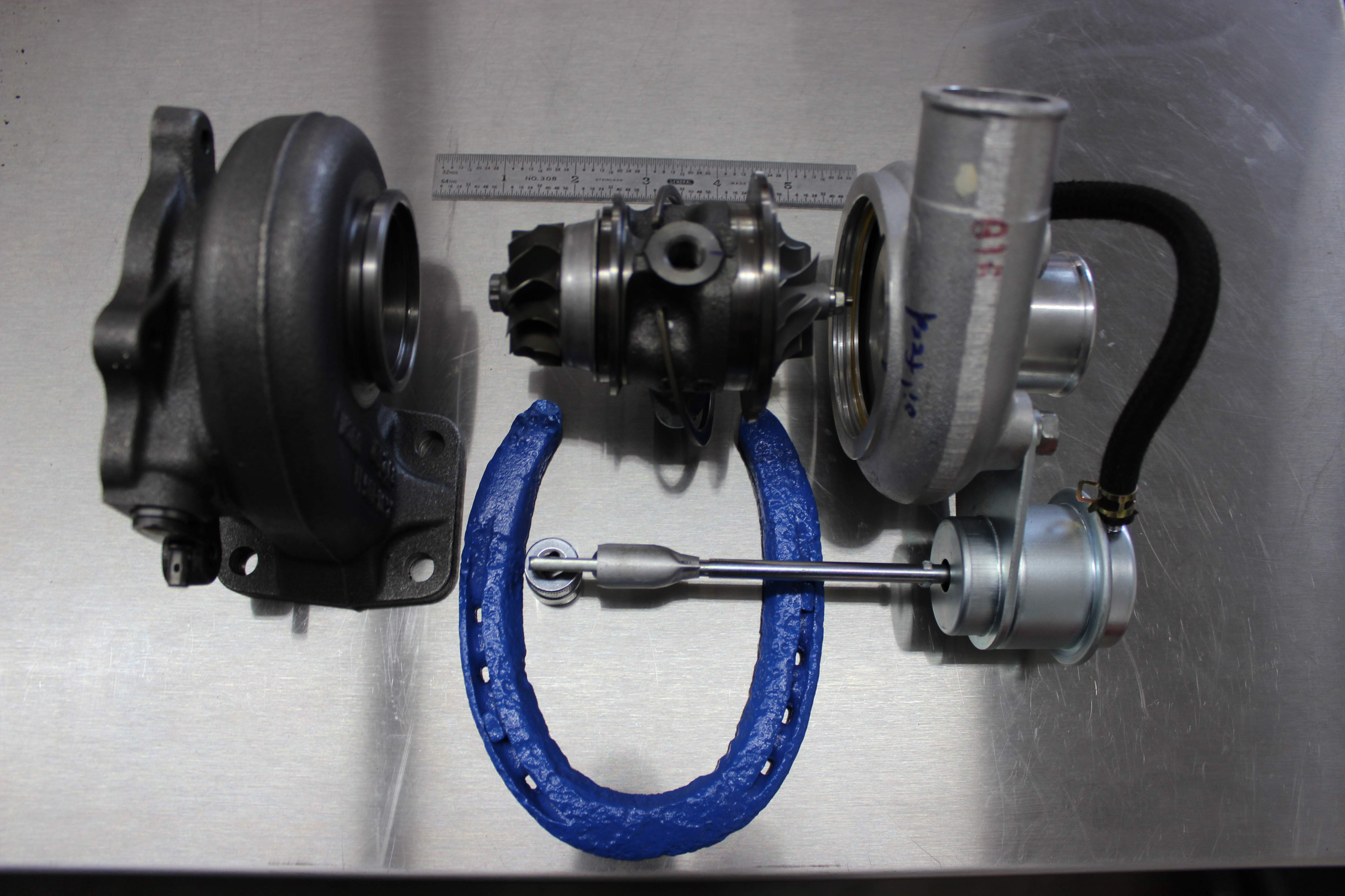

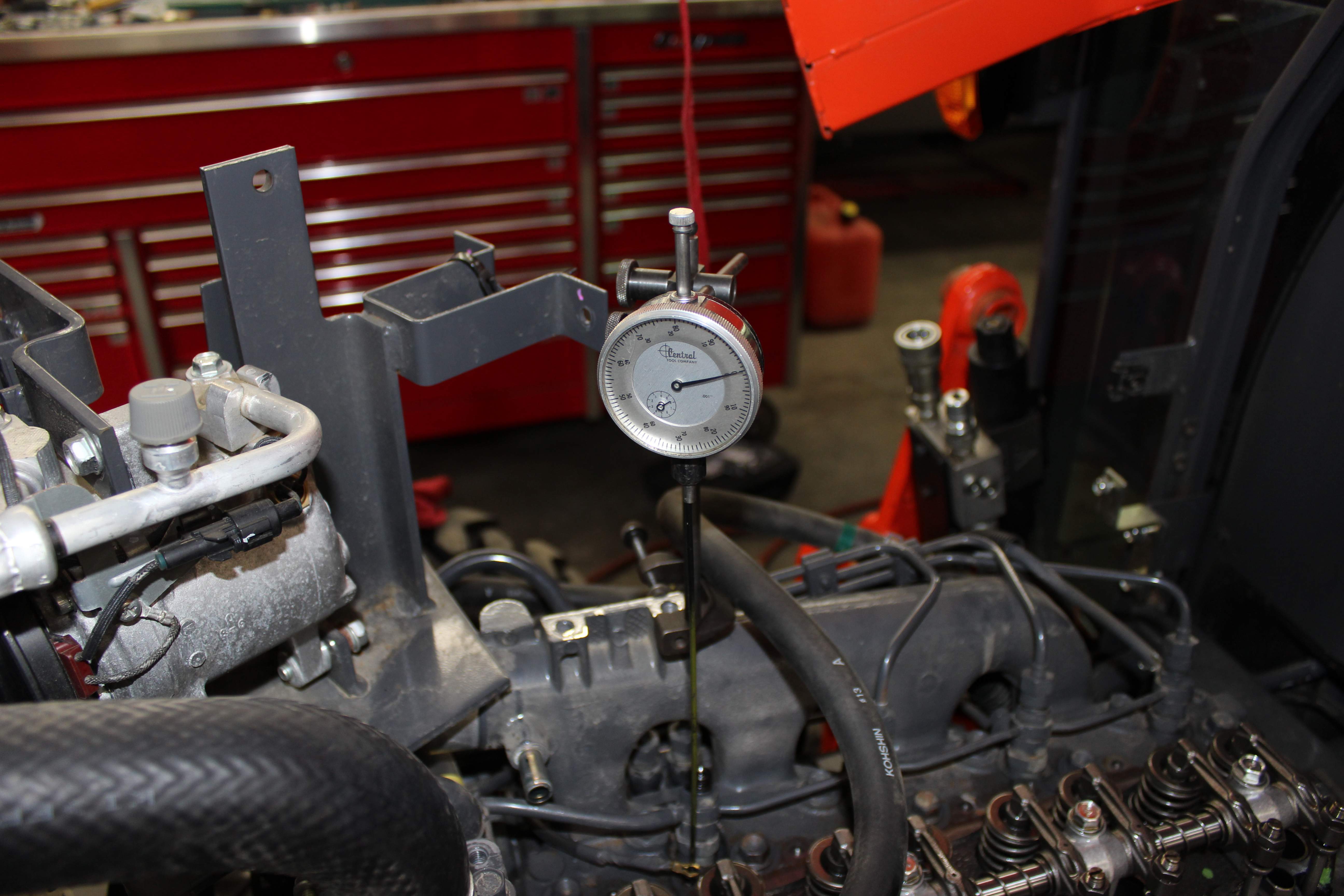

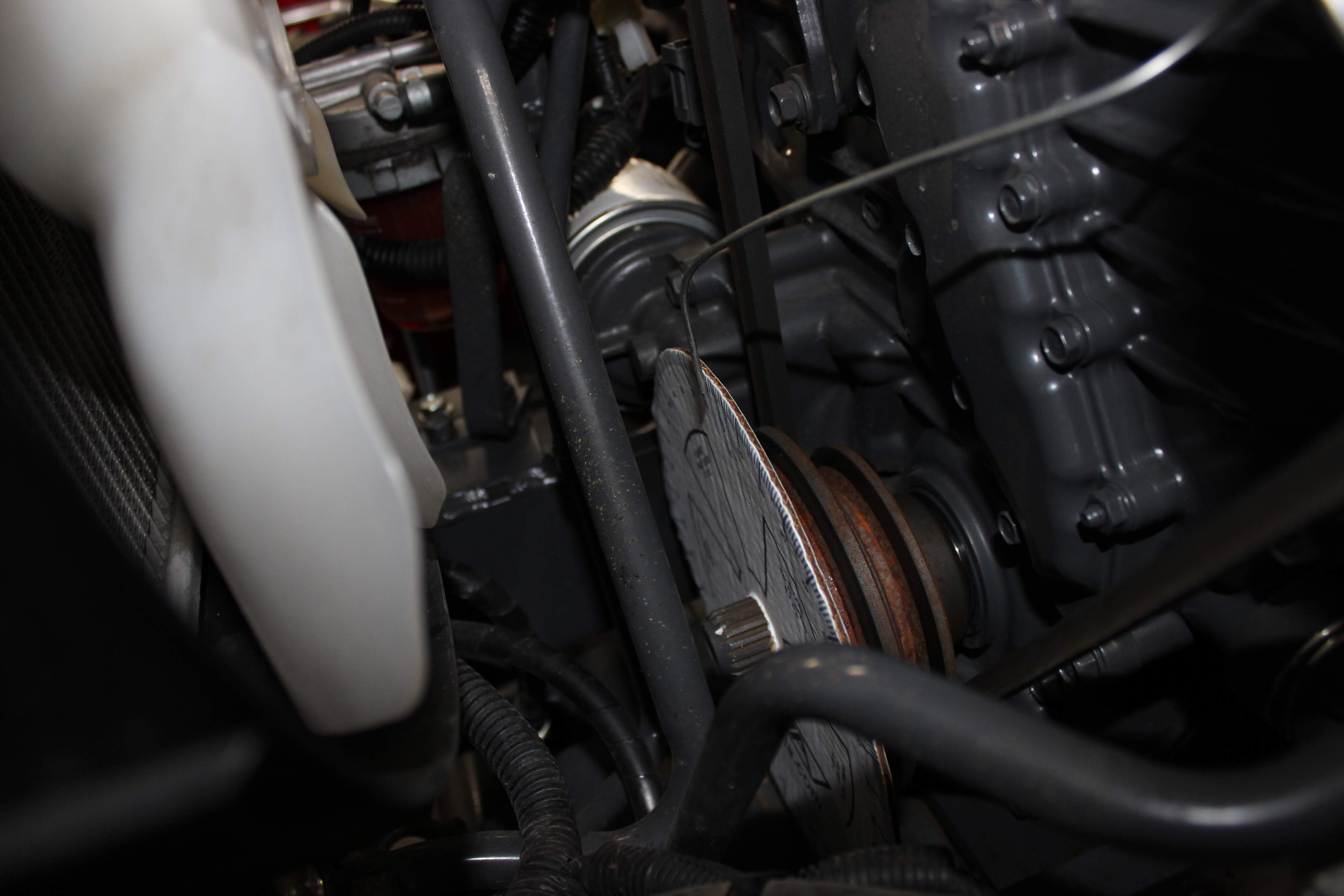

Tore things apart this morning at 5AM. Pulled the fuel tank and A/C bracket, valve cover. Glow plugs ohm fine (0.6 each) and I will do a baseline compression check and timing, valve adj. check before I put it back together. Gonna be a challenge to fit this all and make it look nice and still be able to remove it without remorse if it doesn't work. I see the 5740 has an external EGR to keep NOX down. I think the turbo makes combustion hotter formulating much more NOX. Thanks for the photo, much help.

This has been discussed in another thread but the poor starting is a result of a timing issue. Kubota retards the timing for emissions. You might want to check that out.

just when you do all this make sure the timing is correct as an injector pump being off just slightly will cause drastic power and performance losses
kuboman - do you know if Kubota put in a cold start timing advance circuit? if so, then this circuit is suspect in Fred's machine.
