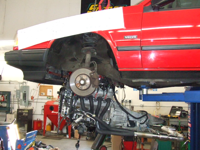

Aaron my Volvo never ran right until I did a V8 conversion on it LOL.
You guys gotta let up on me. You know you wanna see it happen.
Fred
   / I Still Hate My Tractor #102
LOL. Got a link to the build on it? I must say that my '97 V90 does well, but if I ever have more time and money than sense, it will get a TDI engine dropped into it to replace the straight 6 that currently occupies the engine bay...

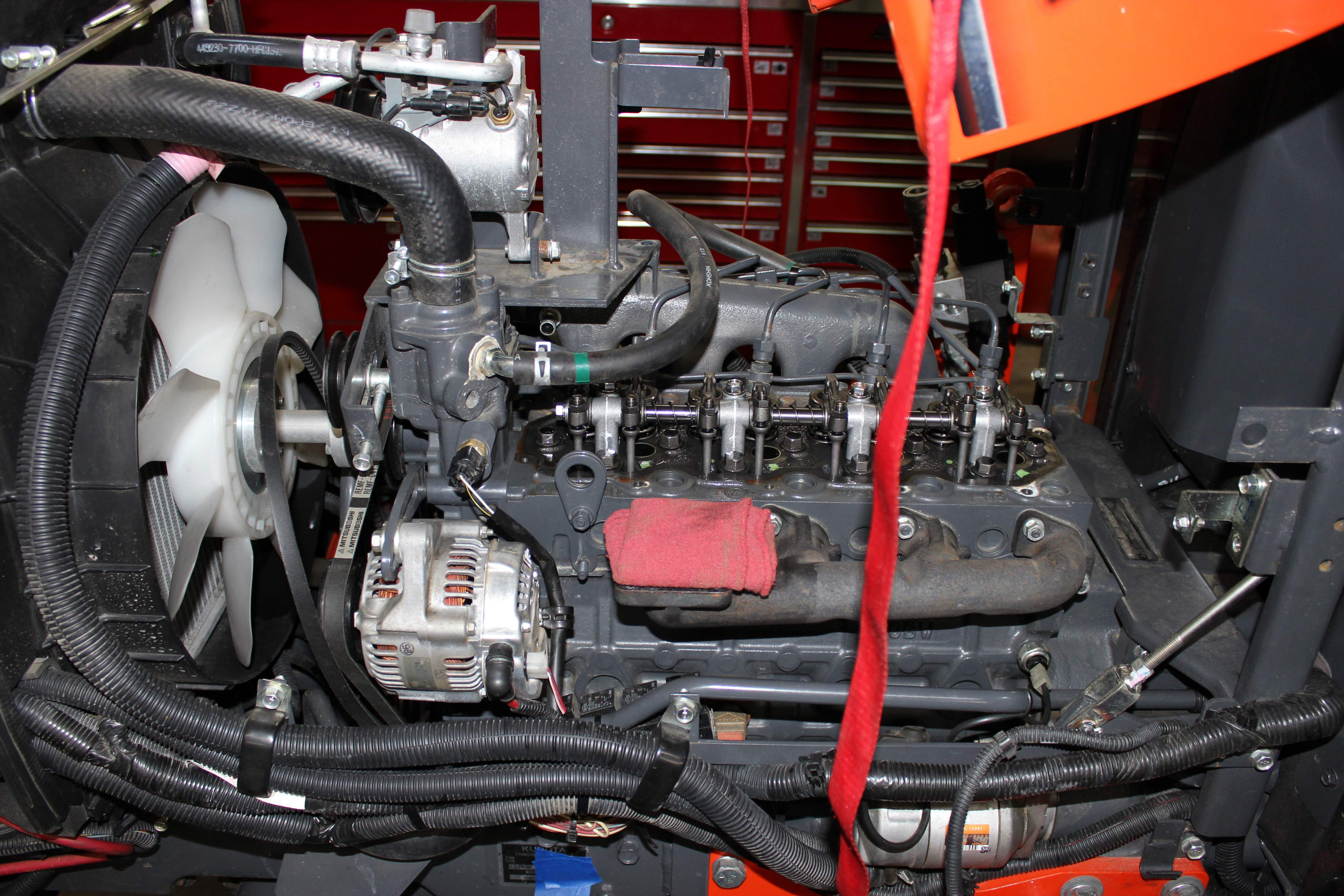

Shop manual for the 5740 (turbocharged) shows NO piston cooling jets either. So where are they? Nobody has been able to show me that any Kubota has them. None of the parts pix show piston cooling jets on any of their engines.
Dealer dyno proved this machine and showed me it was within 5% of advertised. I have not checked timing, another good point. The dealer simply gave me all the hoopla that this machine is what it is, an unbroken, working properly unit. It's mine now, I'll deal with it.
Fred
Tore things apart this morning at 5AM. Pulled the fuel tank and A/C bracket, valve cover. Glow plugs ohm fine (0.6 each) and I will do a baseline compression check and timing, valve adj. check before I put it back together. Gonna be a challenge to fit this all and make it look nice and still be able to remove it without remorse if it doesn't work. I see the 5740 has an external EGR to keep NOX down. I think the turbo makes combustion hotter formulating much more NOX. Thanks for the photo, much help.
This Kubota engine is very basic and timeless unlike this new stuff coming down the line.
Why are you checking this stuff if it made within 5% of its advertised power? There is nothing wrong with it.
