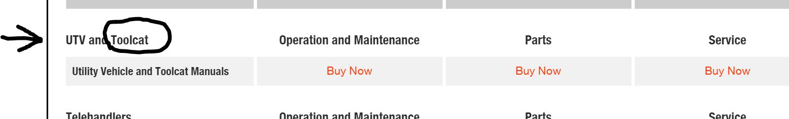

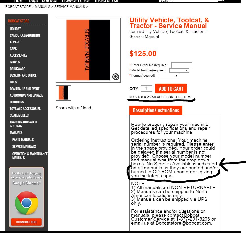

Sounds like you need a Service Manual and a Parts Manual: Manuals - Bobcat Company
Disregard the "NO STOCK AVAILABLE FOR THIS ITEM"
   / If you have Toolcat questions, ask them here... #307
True story, I just need to convince my boss of that. We are likely trading this one out next season, so he tends to balk at that.
