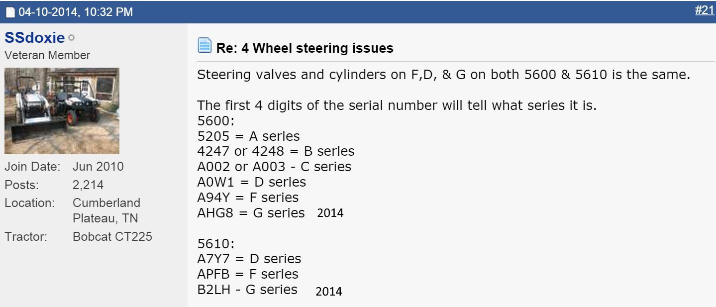

looking at a 2004 with just under 700 hours. are there any special procedures that i need to know to test the drive motors or anything else before i go look at this machine?
Is it a Series A or Series B?
Here is some info from an old thread: http://www.tractorbynet.com/forums/toolcat/67393-vs-b-vs-c-series.html
And the SN breakdown:
