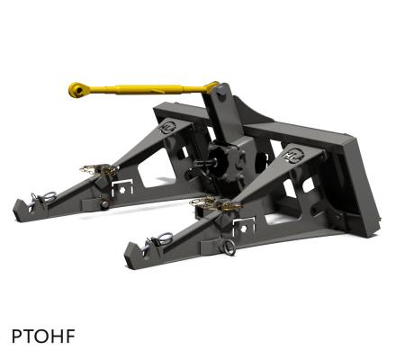

i asked him to figure a rental for 6 months on the 5600 first to see if i like that model. i could sure use the bed for a lot of stuff but that three point and PTO on the back has me thinking. i use a herd seeder for grass seeding my pastures and it requires a PTO,but i have been looking at hydraulic motors 540 rpm with the pto shaft and think i could convert it to a front mount on the 5600. just thinkin!
   / If you have Toolcat questions, ask them here... #478
Yep, copy this type: HLA Attachments - PTO Adapter 3 Point Hitch
Or: Skid Steer Quick Attach Adapter | Skid Steer Solutions
Be sure you use a cushion valve to slow and stop the motor.
