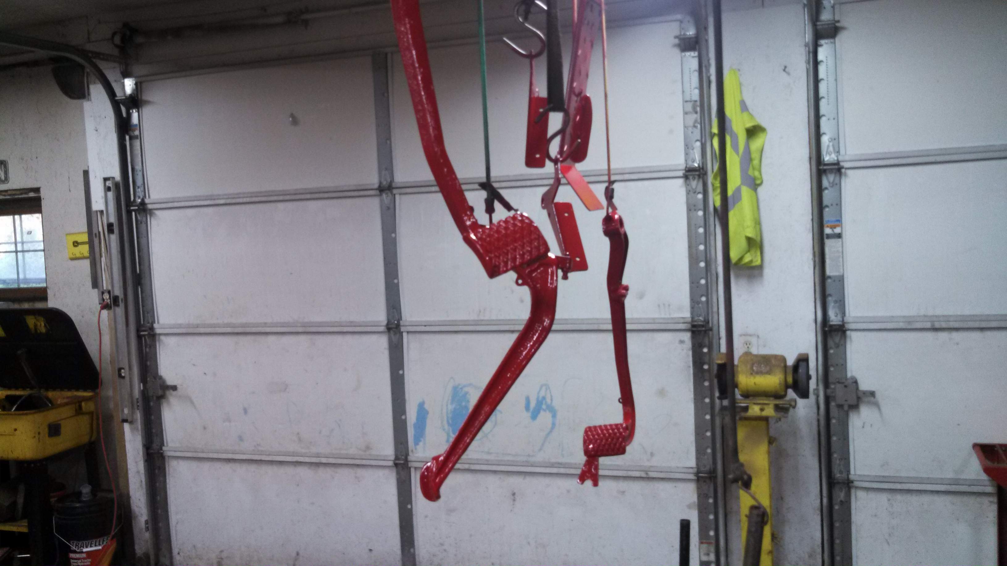

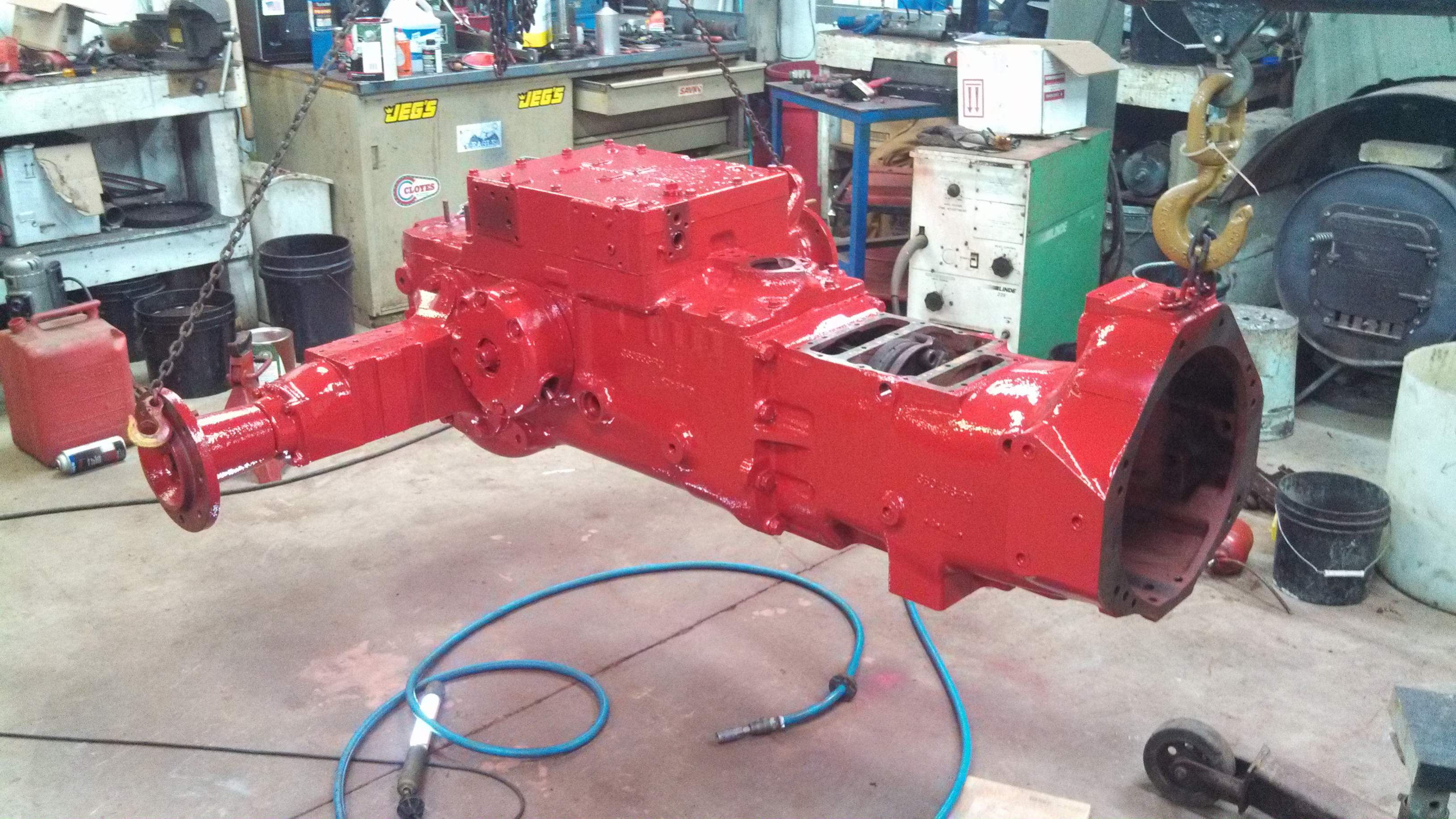

Got the rear main installed, and engine all cleaned and prepped, and then painted. As well as some other accessories and what not.
Here is a pic of the shifter cover painted. Can hardly tell it was ever broke
And the rest of the painting done this morning
   / IH 300 Utility....My new project
#45
got the engine back on

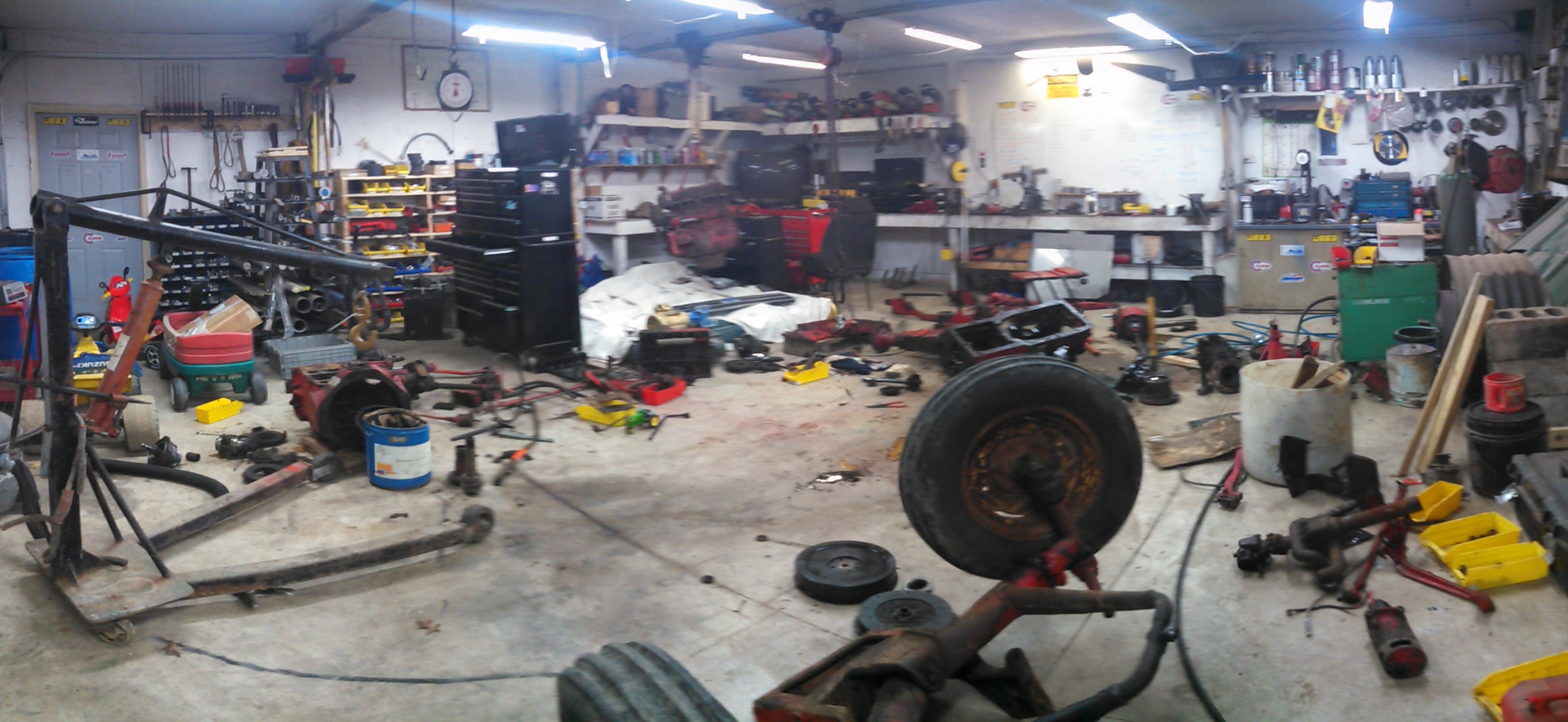

Just out of curiosity, why do you have a hardness tester in your shop. I used to use one frequently, but never needed one for my tractors!
#47
Wow, good eye. I cannot believe you spotted that with all of the clutter.
No real reason to have it, but it is handy for checking things before or after machining, or whatnot. The factory machine shop I used to work at had it. That placed closed last year and there were ALOT of things up for grabs that other plants did not want, all you had to do was request it. Things like nice wilton bench vise, hose real, electric cord reel, LED light real, old mag drill, puller set, Rockwell tester, to name a few.
Some of the pics you might be able to see the small steel rack with lots of round stock, pipe, and other short pieces. I made the rack while at work there, and got to take it home with me as well as everything on it when they closed. Not to mention the 45 or so 3ph electric motors that are under the white tarp that I have no clue what I am going to do with yet....
IT was a really good place to work, and they treated us real well when we left, cause everything I took, was just going to be thrown into a steel dumpster.

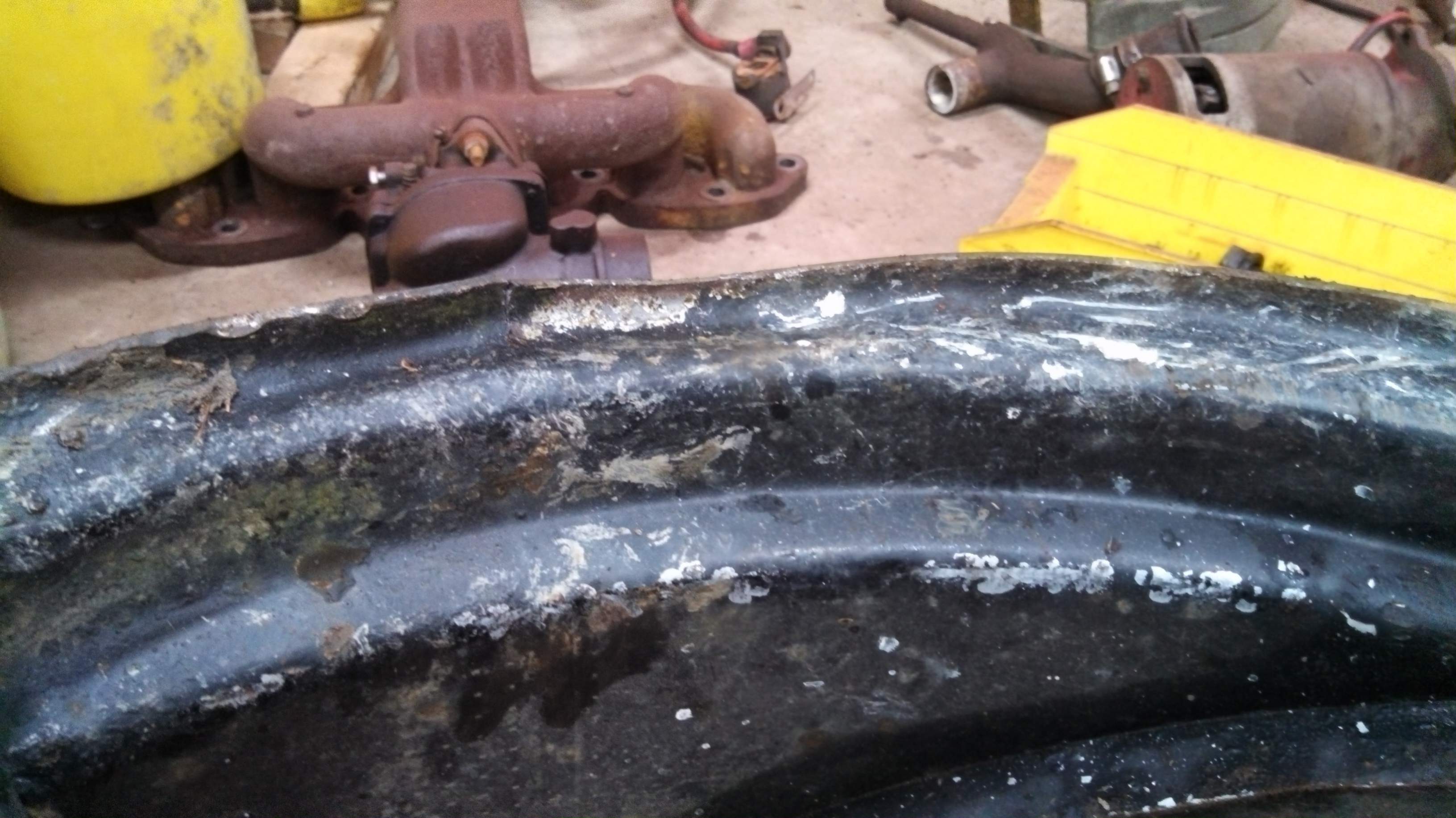

Here is the rims That need some TLC
IMG_20131025_114528_657.jpgIMG_20131025_114534_808.jpgIMG_20131025_114552_327.jpgIMG_20131025_125858_944.jpg

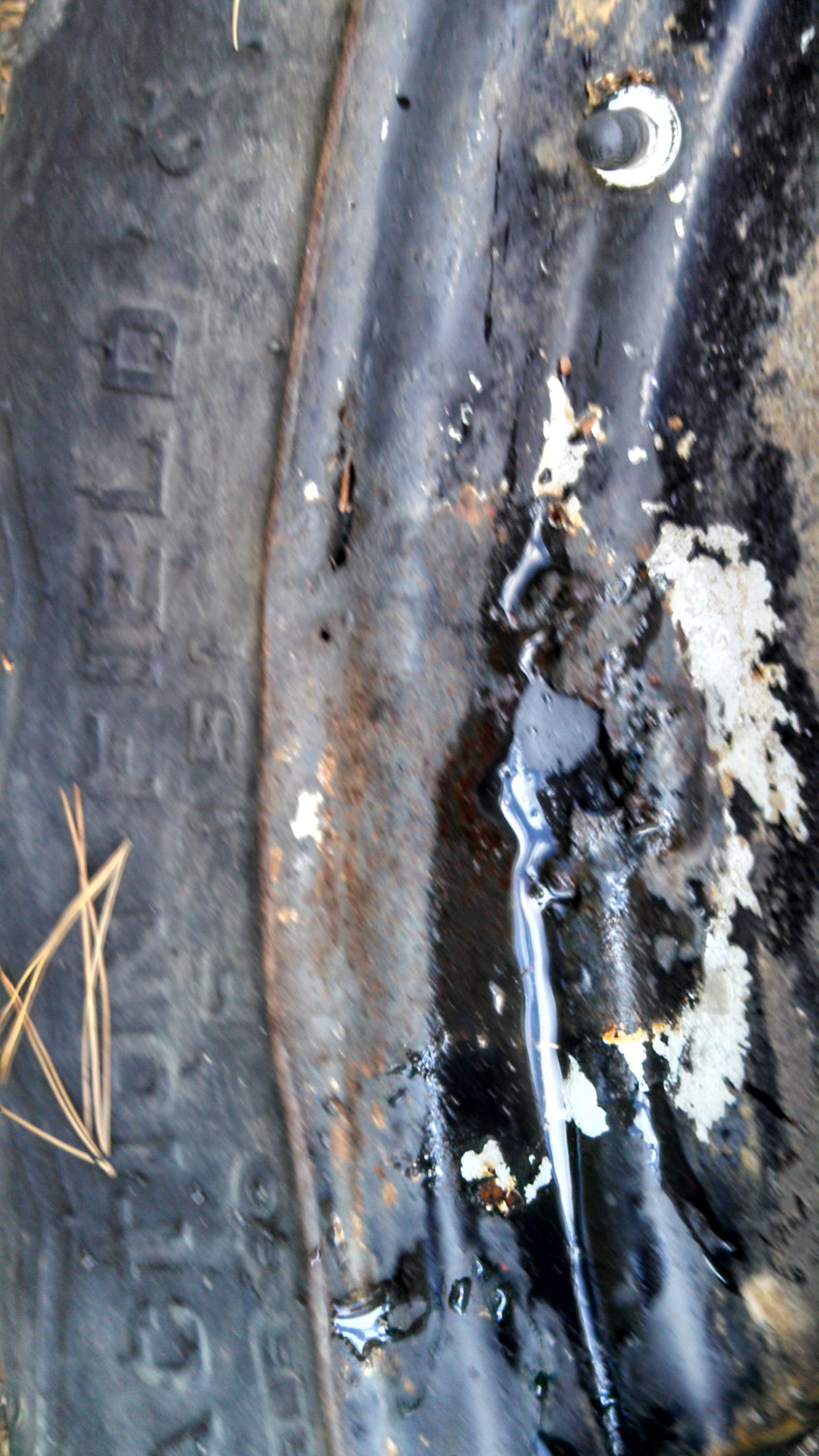

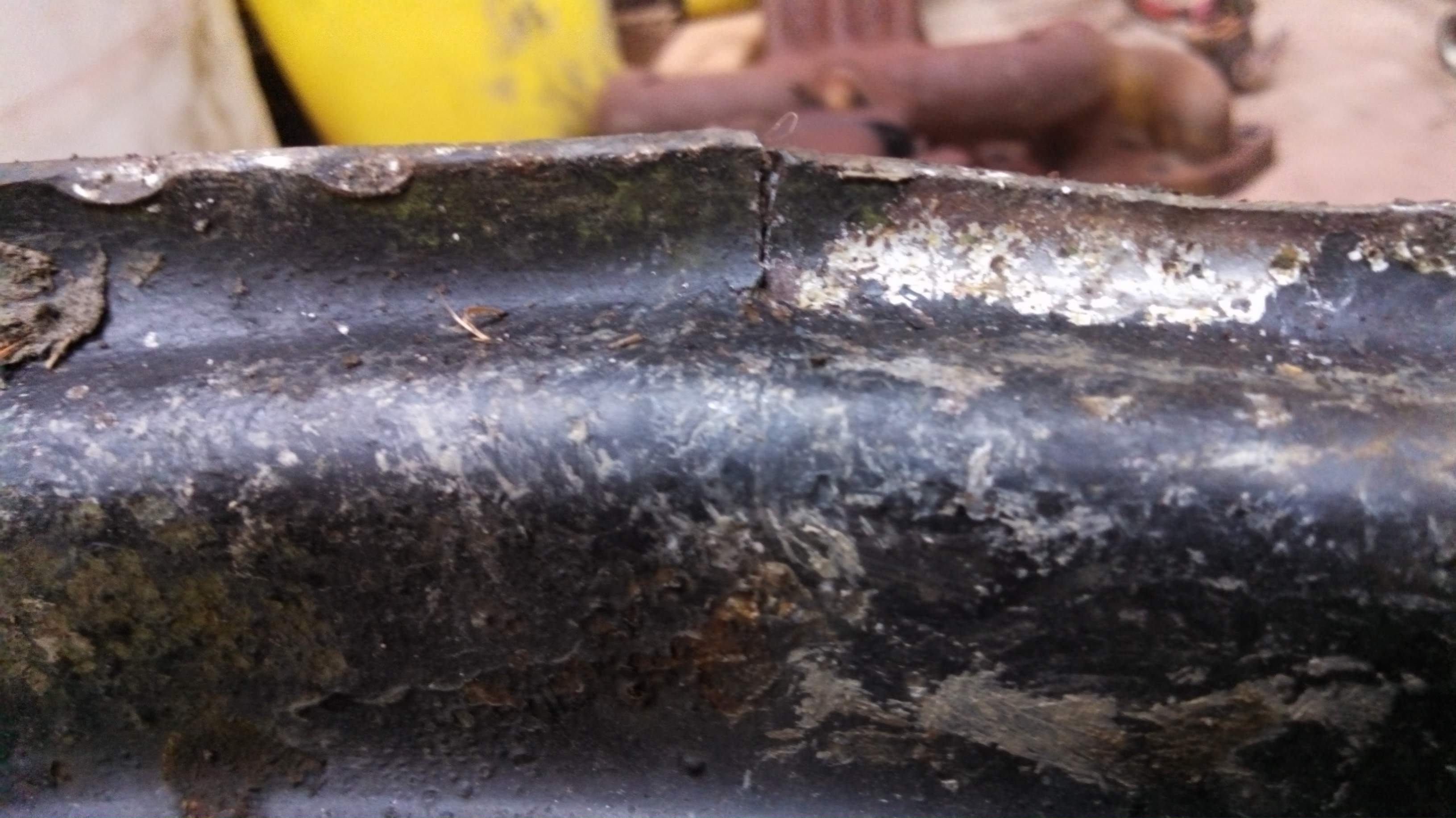

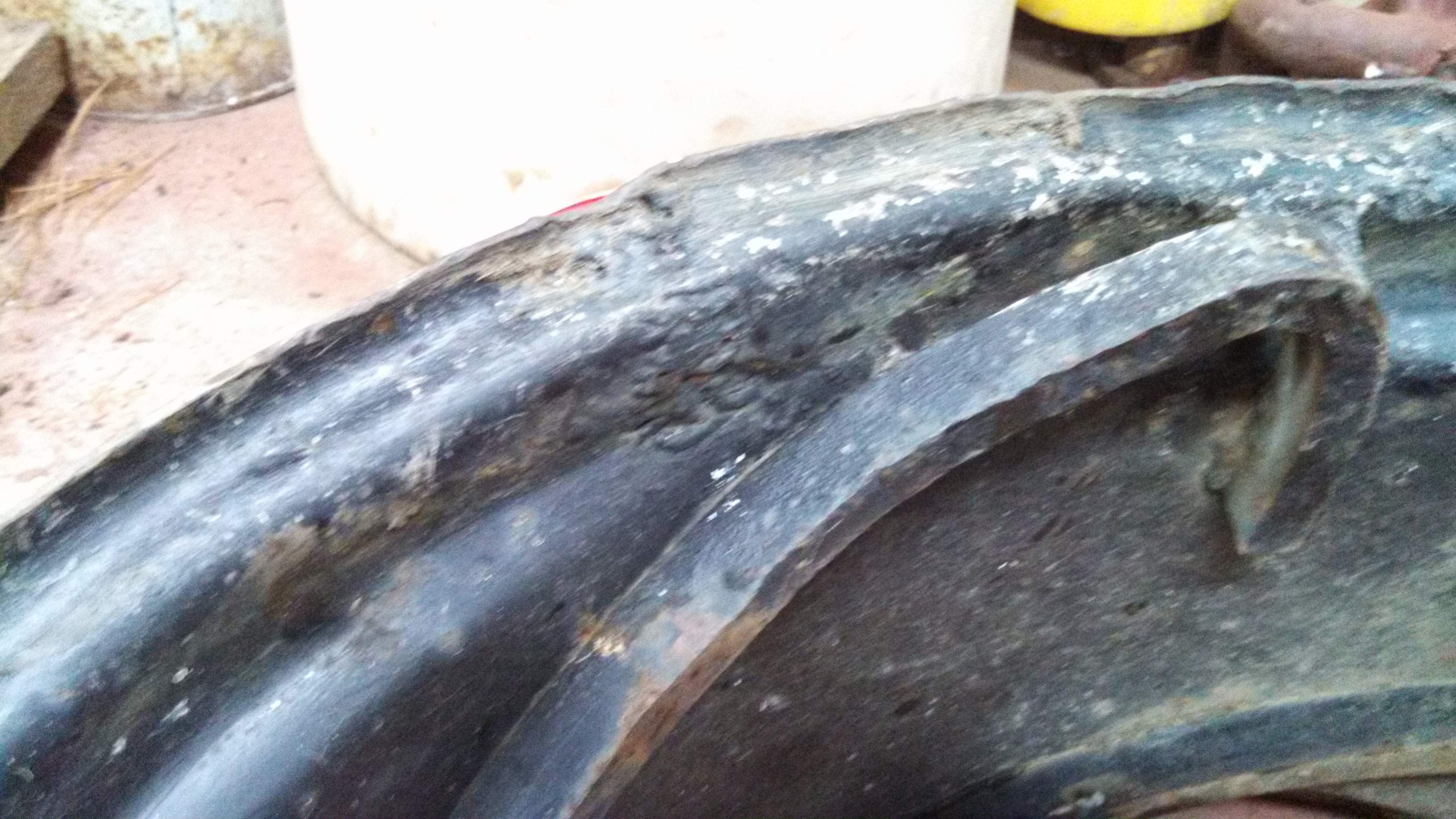

I think I am going to revert to plan B on the rims/tires....
The rims are worse than I though. Totally ate up on the inside. But the worst part, they are tweaked pretty good. On a flat floor, a good 1/2" tweaked. The center dish is also tweaked just as bad. And this is only the first rim I broke down. Not sure on the other...
A guy near me has a set of 23.1x26 combine tires with matching bolt pattern, center hole is the right size, and 9" offset should clear my fenders plenty. They are 8-ply, 50% tread or so, and not weather checked. Am going tomorrow to look at them unless anyone thinks this is a terrible idea?? They will make the rear axle sit about 5" higher, as the tires are about 10" bigger, but I like the 8-ply for doding bushhogging....
Asking price is $300, which I think I could sell my 28" tires and whats left of the rims for that. Cause 28" tires seem pretty scarce around here. We looked for months for a pair of tires for my brothers TO30. And I know I would have paid $300+ for these tires 3-4 months ago.
   / IH 300 Utility....My new project #60
good call.
many times I have spent way too much time to save a rim that should have been trashed. ain't worth it.
easuer and time better spent searching want adds finding cheap older tires on good rims. have made some good buys at auctions and sales getting average rubber, but good rims and centers.. sometiems for the price of scrap weight almost.
