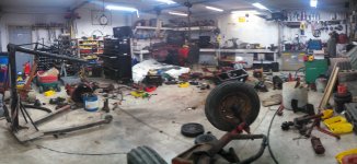

Here is a update panorama shot of the shop. Can you spot the tractor?:laughing:
So far here is what I need
Engine tune up kit....................................$50
Ignition switch..........................................$20
Choke cable..............................................$15
Tach cable.................................................$15
Gauge cluster.............................................$70
All tie-rods.................................................$100
Center ball stud/pivot..................................$50
Lots of seals...............................................$150
Misc TA components...................................$200
TA clutch components...............................$200
Clutch and throwout bearing.........................$150
A few other odds and ends..........................$200
Paint and supplies.......................................$100
Puts me just shy of 2k with the purchase price. I think (hope) it will be worth 2x's that or close to it once restored and done right.
There are a ton of other odds and ends to fix, like broken/striped fastners, etc. But mechanically, everything was great. All the bearings feel great, and all of the gears look great.
