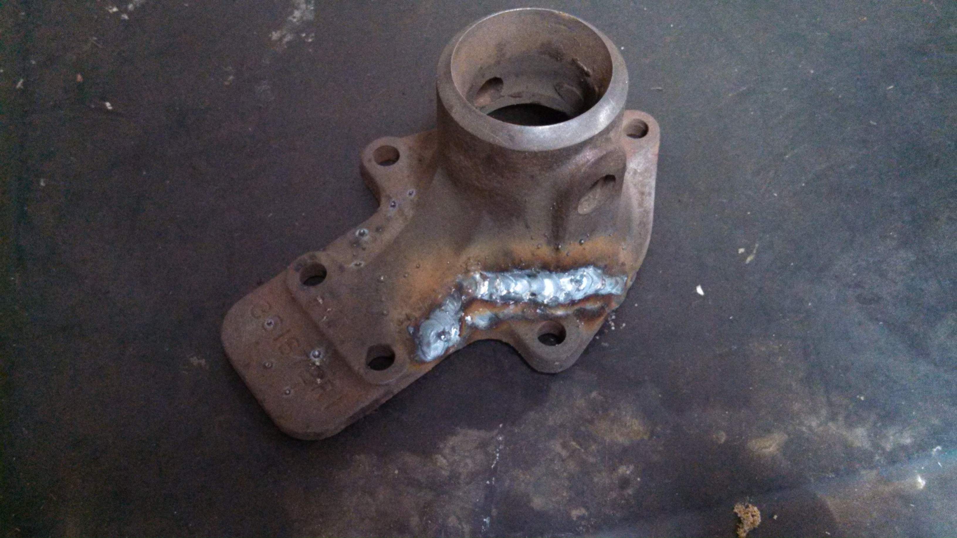

Still need to source two more parts and I'm set (I think).
Still need the shifter top cover, as mine is broken, but may end up just welding it. And also need to find the small 4-bolt cover that goes over the TA clutch. May try a few more junkyards and see if they will sell for a decent price. But nothing on ebay or online that I have found.

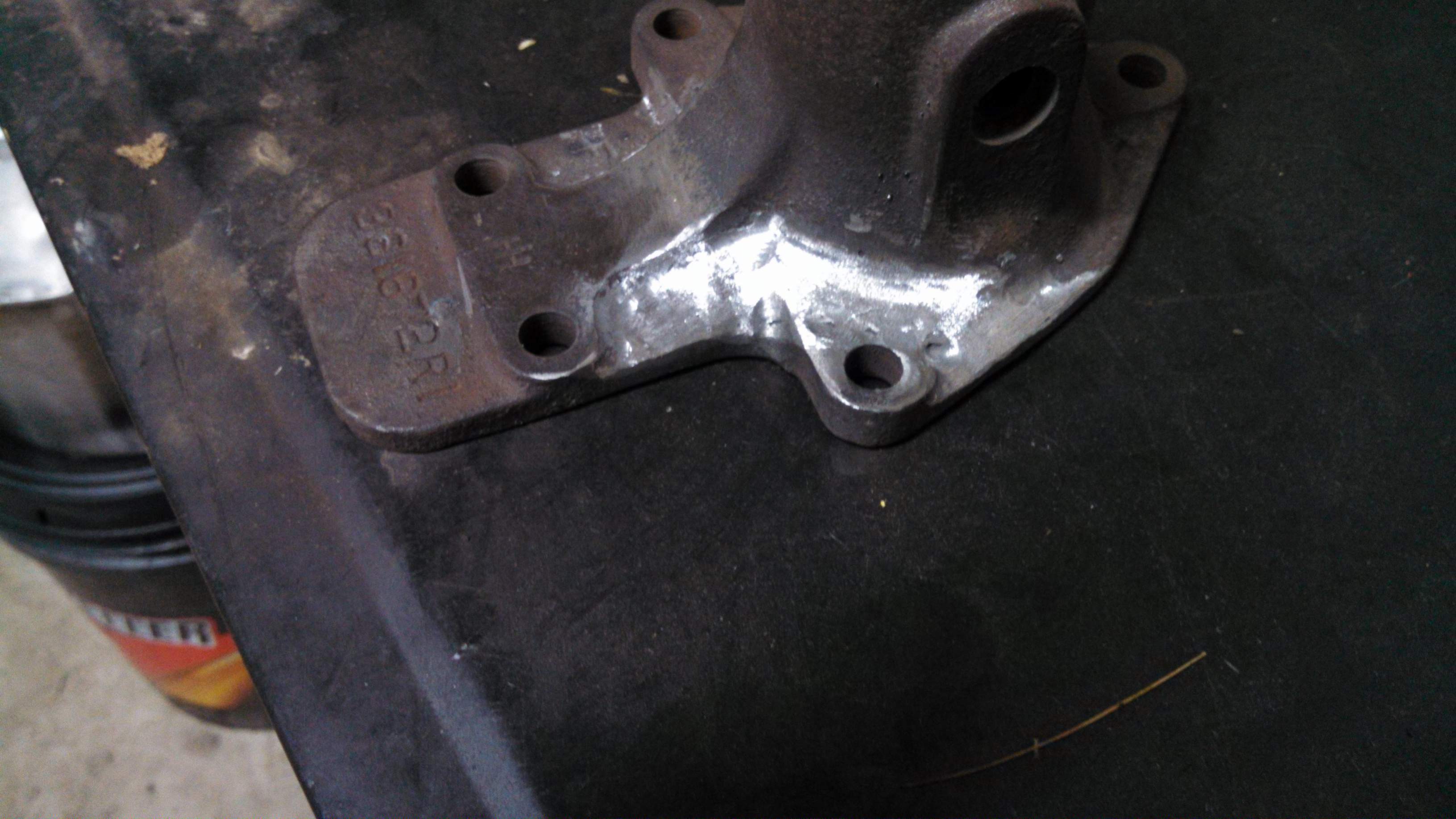

Well I welded the shifter cover. It turned out good so I don't need one of those anymore. And will probably just make the ta cover.
Got all of the accessories off the engine today as well as the pan and rear main seal. Also sand blasted lots of other parts. Tomorrow is gonna be a lot of cleaning but hope to shoot some more primer tomorrow when I get the engine prepped and the rear main/pan back together.

Here is how the shifter turned out:
