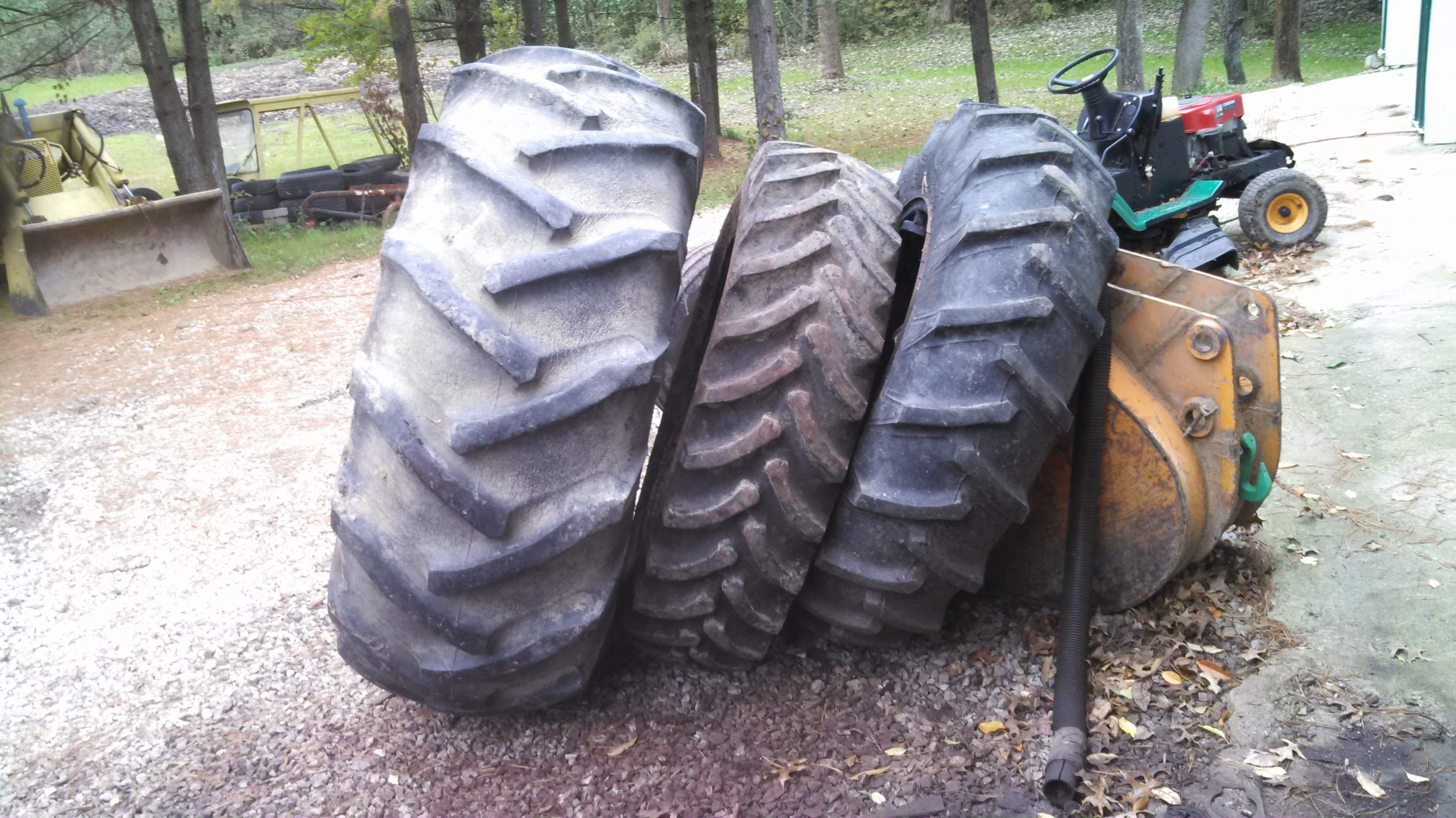

Got the larger tires today. MAN they are HUGH:confused2:
I am going to try to run them in the narrowest setting. In the narrow position, its a 14" offset, which should give a 82" width. The other way would be 90. Looks like the only think I will have to do is make a plate to offset the fenders closer to the tractor. Just measuring, it looks like I will need about 1" or so. But I will mount the tires first and then modify the fenders to fit

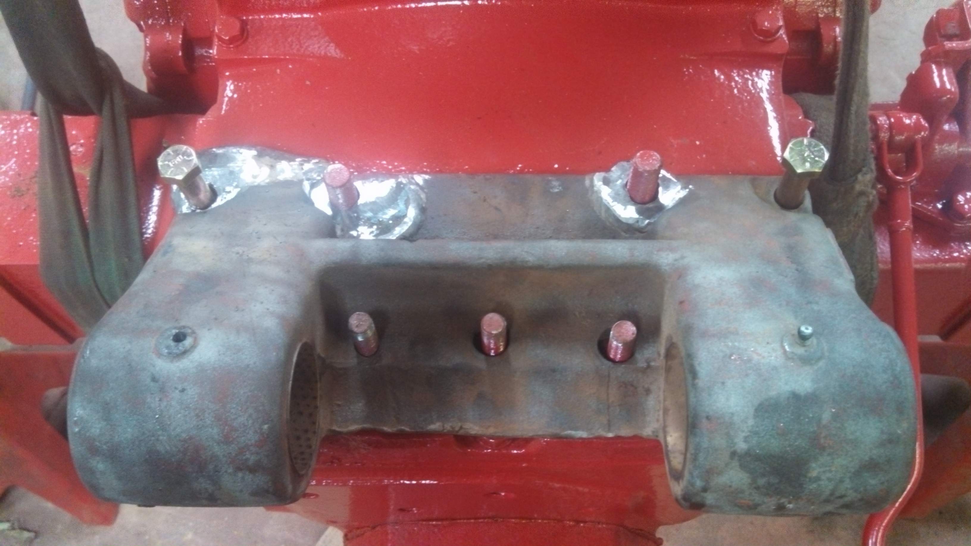

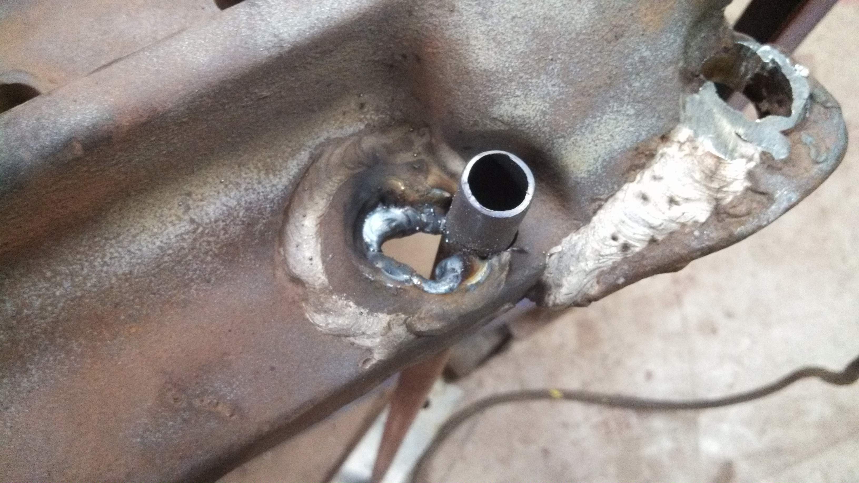

#64

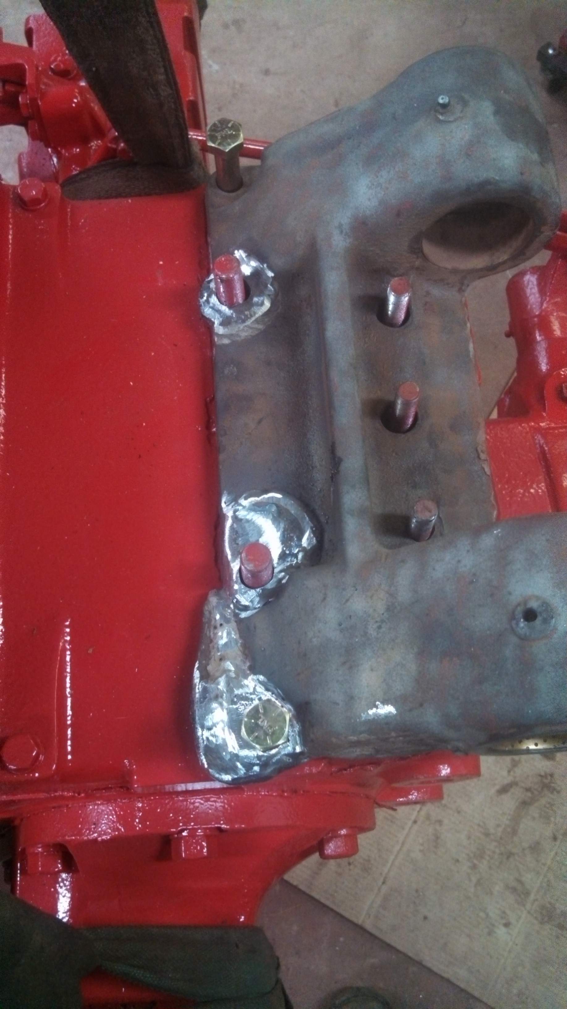

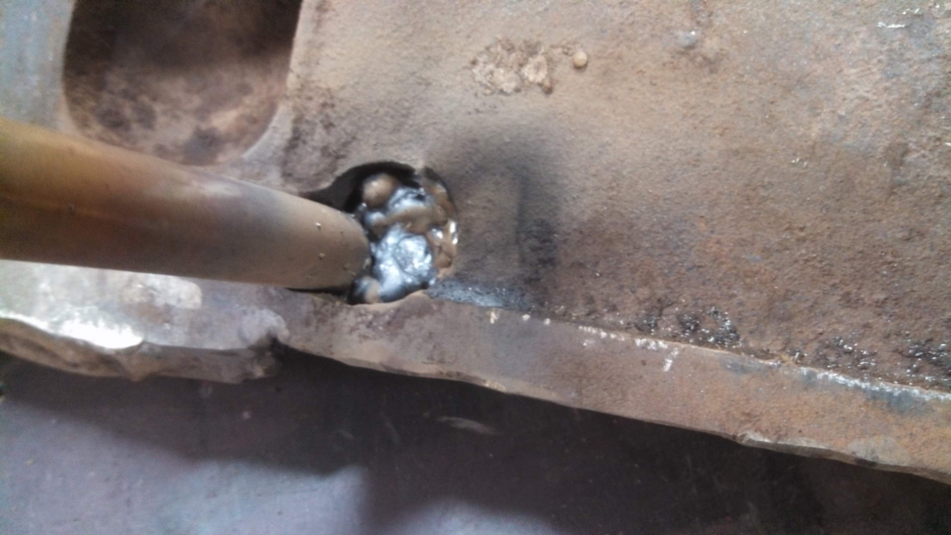

After I picked the tires up this morning, I started working on the fast hitch. Cause I forgot that tires need to be off to assemble it. It has been broken and repaired in the past, and holes larger than they were supposed to be cause bolts broke off in the rear end top-cover, and they re-drilled and tapped beside the old hole, and then just welded a washer to the hitch to partially cover the old hole.
I repaired the rear end cover already. I filled in their repair holes, extracted the old broken bolts, and then used all-thread for studs, with a nut and washer on the bottom and then welded. No pics of that but they certainly shouldnt pull through.
So with relocating the studs to the correct position, I had to now fix the hitch part that bolts to it...
IMG_20131026_143850_227.jpgIMG_20131026_144208_045.jpgIMG_20131026_193903_144.jpgIMG_20131026_193913_088.jpg
I used a 5/8" OD copper pipe where the holes needed to be, then welded around it til the excess was filled in.

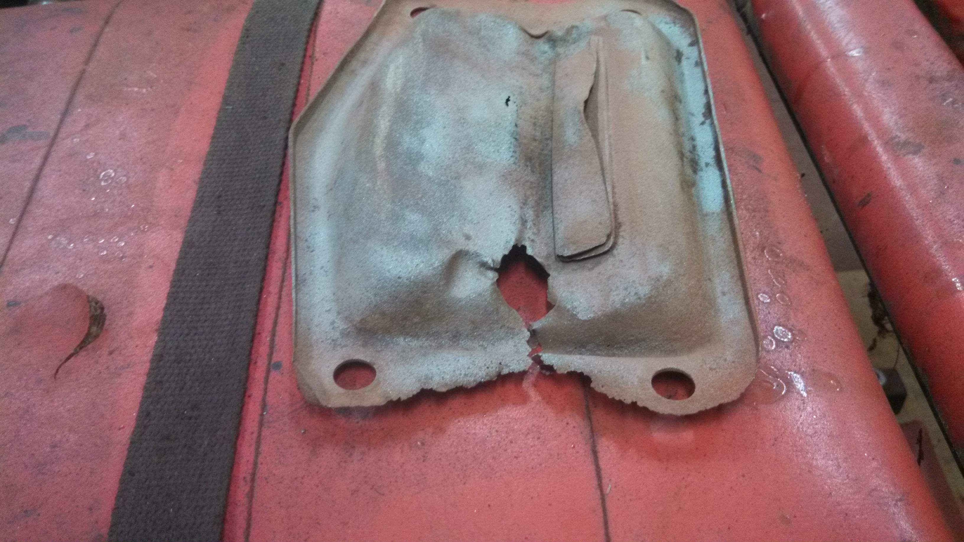

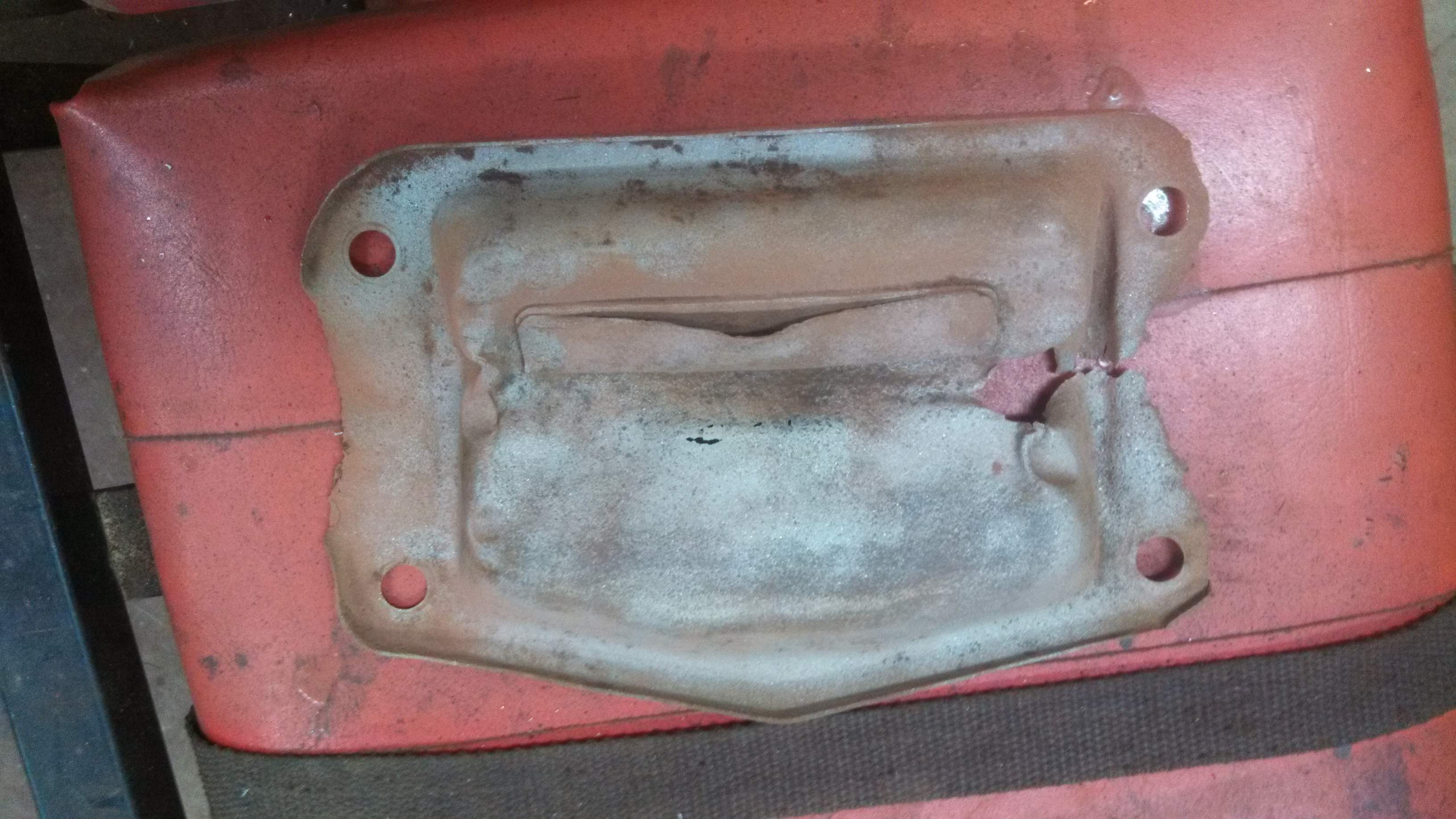

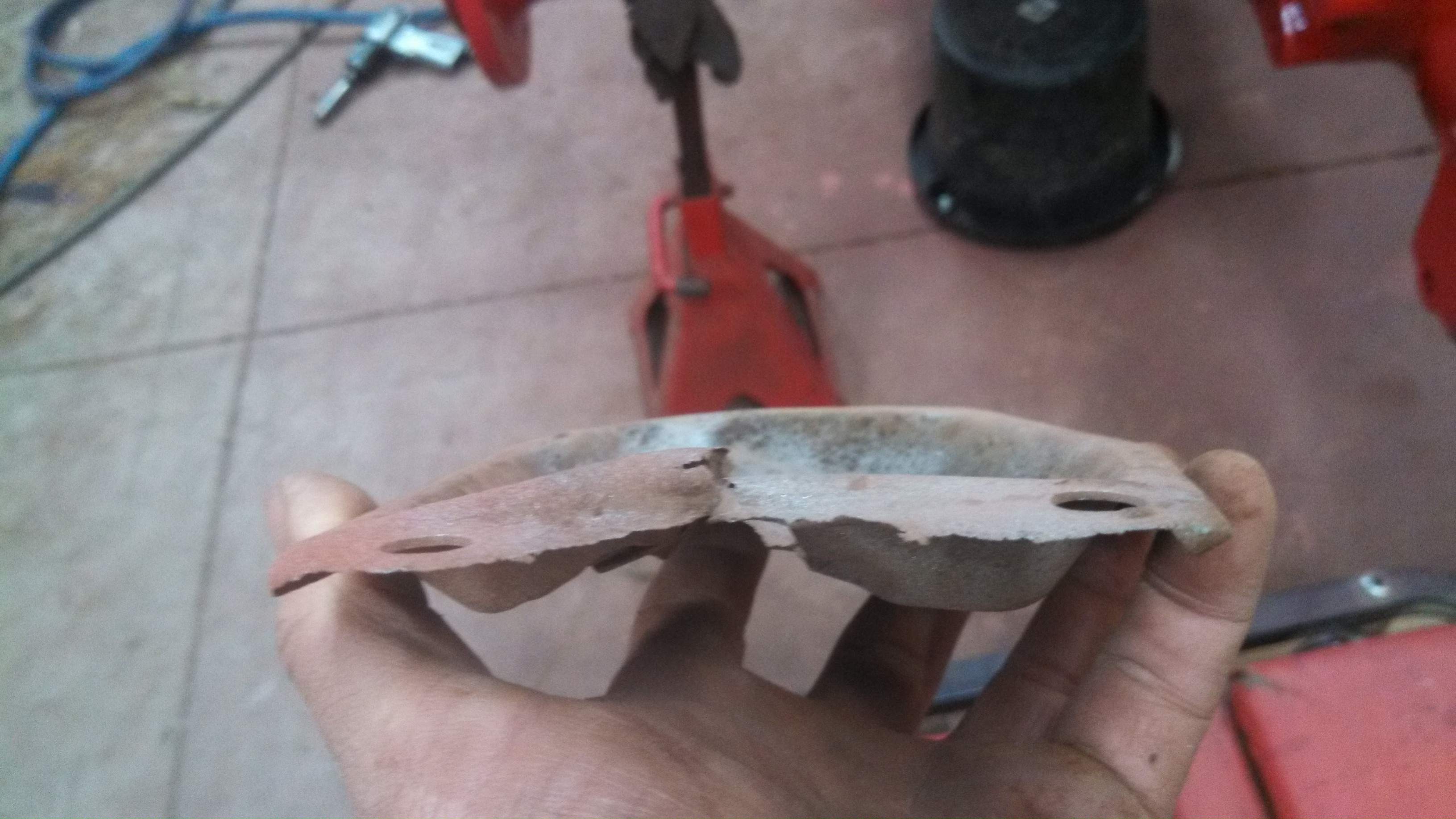

Tomorrows project, I may try to work on the TA clutch cover. I dont have much good stuff in the way of material to make one from scratch, cause it fits in a tight area between the battery tray and steering box, so I may try to salvage this

just remember that those large tires will change you're gearing making for a higher low gear and may be harder to move around slow trying to hitch something up to it
