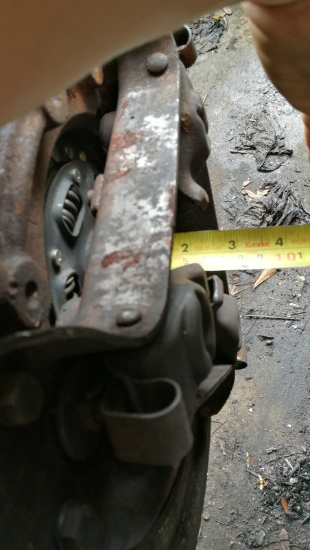

I refere to the splinedboss of the clutchplate
So the distance from the splined boss of the clutch plate to the tip of the fingers should be 50mm?
Sorry for the confusion and thank you for patience
   / IH 484 clutch shaft wear question #42
If you look at that spesial tool (pilotshaft) you wil see that that thick diameter can only rest against the clutchplate boss. From there to the fingers must be 50mm or near 2"
#43
Understood. Thank you for clarification. I will split the tractor next week and measure the distance to the fingers.

I got out to the tractor. Broke it in half again. Checked the old pressure plate . The fingers are 55 mm from the clutch boss. I installed a brand new pressure plate. The fingers were at the same distance. I checked the fork and it is installed correctly - that is the same way it came out. I also checked the clutch fork shaft and it does not have any cracks in the arm. I am at loss here.
   / IH 484 clutch shaft wear question #48
That 55....is it when installed and tightern on the flywheel or is that when its not installed ?
   / IH 484 clutch shaft wear question #50
The outside adjustible link must be allmost screwed out to about full lenth
