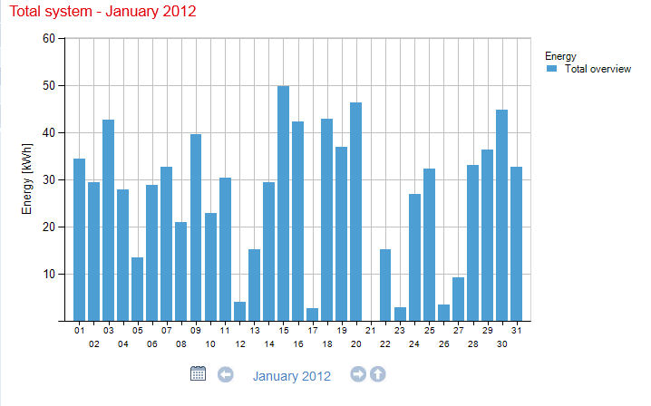

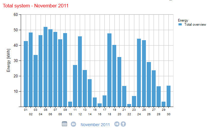

We put 5KW in panels, 6KW inverter to allow a little future expansion, and solar hot water. We did it partly to take our bill to $0.00, partly because we like the idea, and partly because our rates keep going up and up and up. And, we plan to be here for a while.
With your 5kw system, do you know how many kwh it is producing per month? Rob-d showed us his chart with a 6.4kw system and it looks like this month he will make ~700kwh. Any info in your set-up? And how much it is saving you per/month. And how much it cost you to install??
