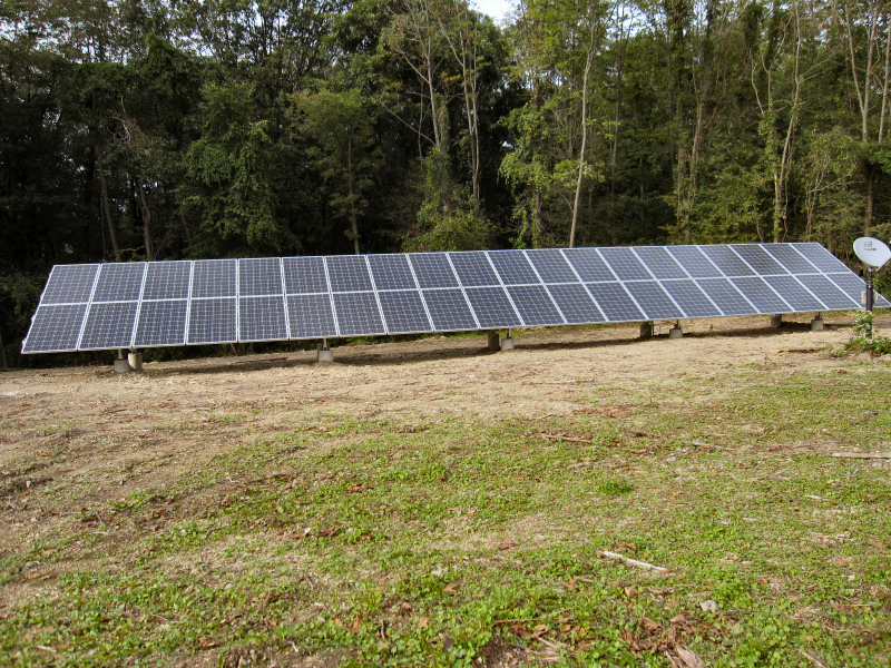

I have posted before about my home. I have about 2500 sq ft of semi earthbermed SIP construction home. When go through about 180kw/month. It has a 1.2kw array that is gridtied with battery backup in case of grid failure. Additionally we have a solar dhw system. Total expense before rebates etc was about $27k.We paid in the end about 2/3s of that.
The last few days we are close to 7 kw/day. I built a very energy concious home but the design has paid for itself. The solar will take time but should pay for itself as well.
We are just outside of Manchester, NH.
