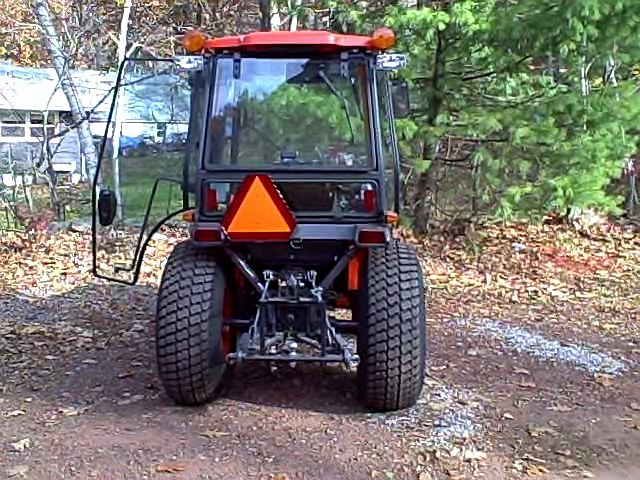

As mentioned, spacers can dramatically improve stability. Another source for spacers for your tractor is Bro-tek who makes add-ons for the Kubotas. The website is:
Bro-Tek: Tractor Add Ons
Information on the site is not up todate so it is best to contact the owner. I did that when considering spacers for my Kioti to increase clearance for tire chains. The website does not even indicate he makes spacers for my tractor. But I did get quoted a good price. In the end I did not need spacers because of modifcations I made to my chains.
Other good advice already given is to always use 4x4 on rough terrain. Also, keep the bucket as low as possible to increase stability. Sharp turns also reduce stability. Spend some time playing with the tractor until you get a feel for it and err on the side of caution.

Here's pics of what spacers did for my B3030. I had to add them because I couldn't run chains without em.
