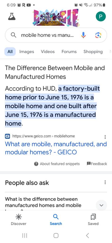

I've posted this same screenshot recently on another thread; mostly cause there is a lot of bad info out there. I hear all the time, a modular is xyz, but a mobile home is cba. It really all comes down to the building code/regulatory agency over them; a Manufactured home is regulated by HUD (with tie downs inspected by building department), and can be placed on a perm foundation, can have piers, can be on stilts, or old fashion tie downs, can be as small as 8-10 ft wide, and as much as 4 (most I've seen) sections wide, can have 2nd story/basement/ect.
Modular Homes are no different from a site build home as far as codes. Local-state building code; although the vast majority of the inspection is done at the plant. Some can be as little as 2 pieces; to many many modules. They can be placed on piers, stem walls, basements, raised in the air on wooden stilts, ect. Some/many retain the metal frame and/or axles; but others are craned from a delivery base onto a slab on grade or other foundation, with no 'trailer frame' remaining.
Both can run a huge diverse list of materials, specs, finishes, ect. Many manufacturered homes now use standard exterior/interior doors. I dont 'think' any still use the 1/8" wood paneling as the 1970s, or the 3/8" drywall of the late 80s/early 90s. Both are engineered, and meet a building code/windload, although it's not the exact same code mod vs man.
