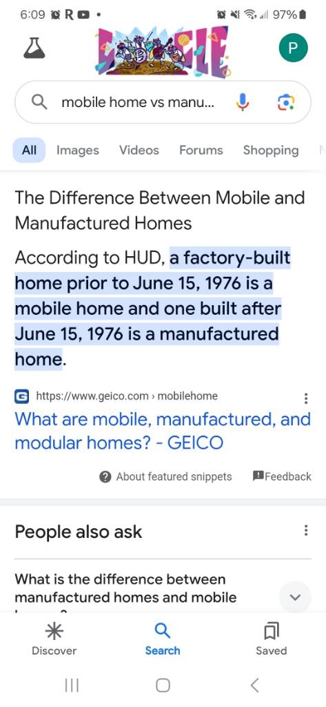

I've posted this same screenshot recently on another thread; mostly cause there is a lot of bad info out there. I hear all the time, a modular is xyz, but a mobile home is cba. It really all comes down to the building code/regulatory agency over them; a Manufactured home is regulated by HUD (with tie downs inspected by building department), and can be placed on a perm foundation, can have piers, can be on stilts, or old fashion tie downs, can be as small as 8-10 ft wide, and as much as 4 (most I've seen) sections wide, can have 2nd story/basement/ect.
Modular Homes are no different from a site build home as far as codes. Local-state building code; although the vast majority of the inspection is done at the plant. Some can be as little as 2 pieces; to many many modules. They can be placed on piers, stem walls, basements, raised in the air on wooden stilts, ect. Some/many retain the metal frame and/or axles; but others are craned from a delivery base onto a slab on grade or other foundation, with no 'trailer frame' remaining.
Both can run a huge diverse list of materials, specs, finishes, ect. Many manufacturered homes now use standard exterior/interior doors. I dont 'think' any still use the 1/8" wood paneling as the 1970s, or the 3/8" drywall of the late 80s/early 90s. Both are engineered, and meet a building code/windload, although it's not the exact same code mod vs man.View attachment 872624
Building codes are the minimum legal requirements. Build quality is far more than just the building codes.
Part of this thread is about what appears to be mobile tiny homes which do get different codes than the traditional frame houses. "Travel Trailers" typically have 1 1/2" framing, and minimum insulation. I don't know how those super-sized ones are built, but I don't have a lot of faith in them.
