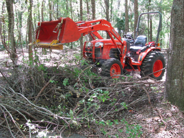

Rotary Cutters, AKA Bush Hogs, are among the most indestructible of tractor implements. Very few parts, relative to a Flail Mowers. Only two blades to sharpen and only an angle grinder required for the job.
Flails have many, many more parts. "Blades" are carbide "teeth". Carbide is difficult to sharpen. Read up on Flails. There are hundreds of TBN threads on Flail Mowers ~~~~ your circumstances may warrant a Flail rather than a 'Hog.
Rotary Mowers are probably 95% of the market, Flails 5%.
LINK: Google
Tillers are easy. Almost any small tractor can power a PTO tiller. If you only want a kitchen garden, consider a Ratchet Rake bucket attachment to open the ground. No PTO to fight and minimal space to store. The Ratchet Rake will be useful for your brush work.
Photos show Ratchet Rake on B3300SU.
LINK: Google
VIDEO: ratchet rake brush clearing - YouTube
