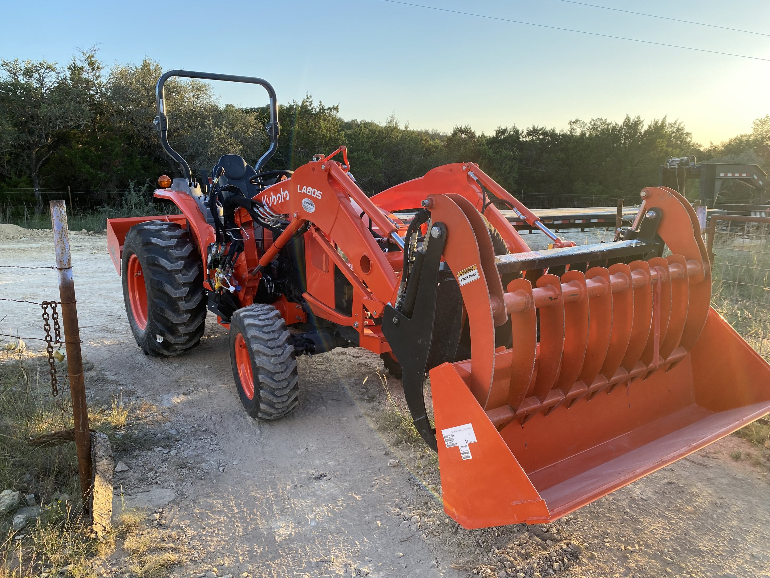

Scott - I just reread all the posts here. You are considering getting a grapple. BEFORE you get the grapple - modify your grill guard. Sticks, stobs, limbs, etc have a nasty way of causing damage to your grill, radiator or battery. This is my Land Pride SGC 1560 grapple and modified grill guard.

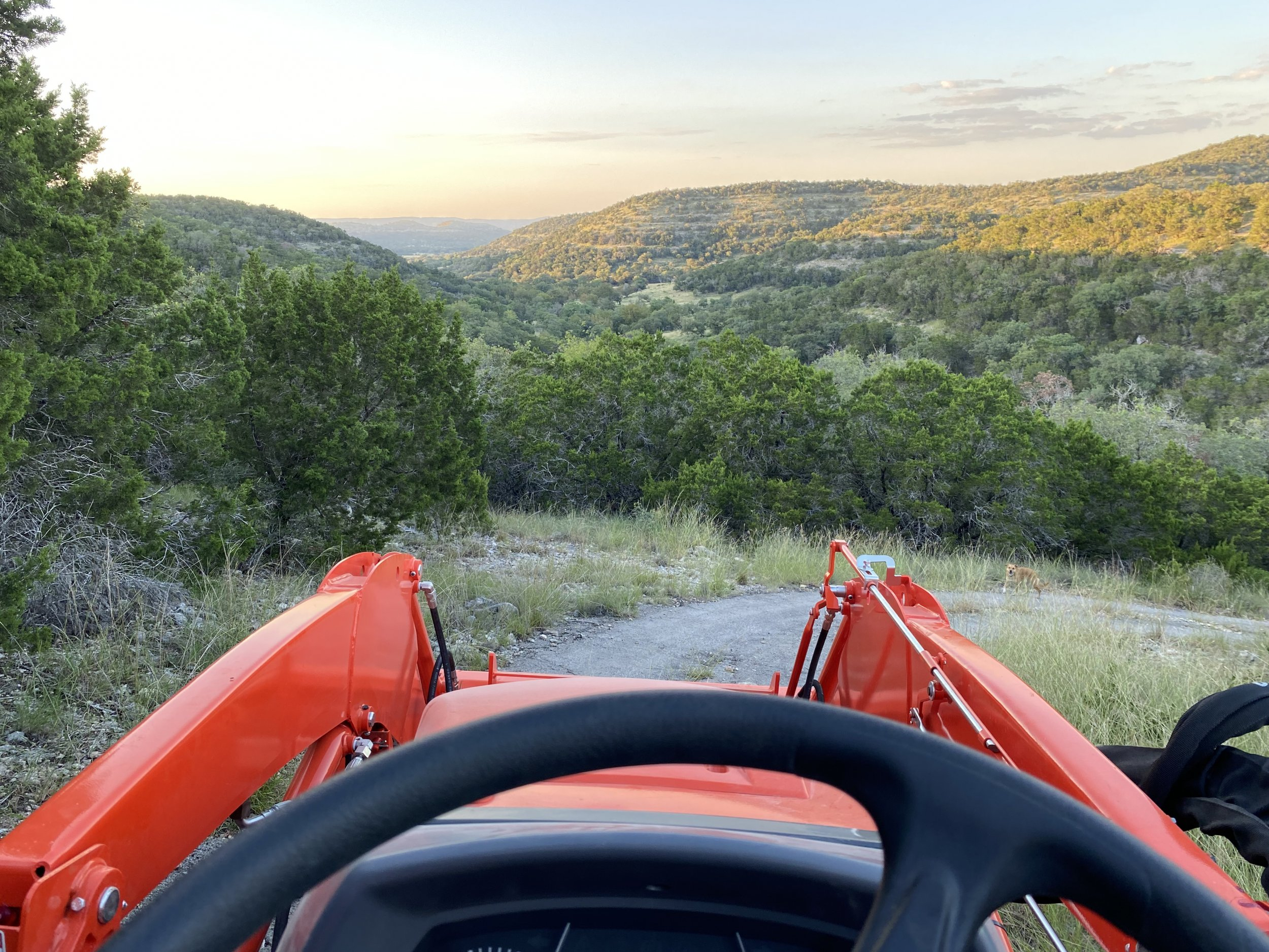

And since everyone likes new tractor pics.....
   / Initial attachments to get with new Kubota L3560LE? #54
Nice looking country. Nice looking tractor. Nice looking Gooseneck trailer. All looks good to me. Congratulations. Keep the ROPS up, seat belt snug, fuel clean, and dust out of the radiator. Enjoy your new best friend.
