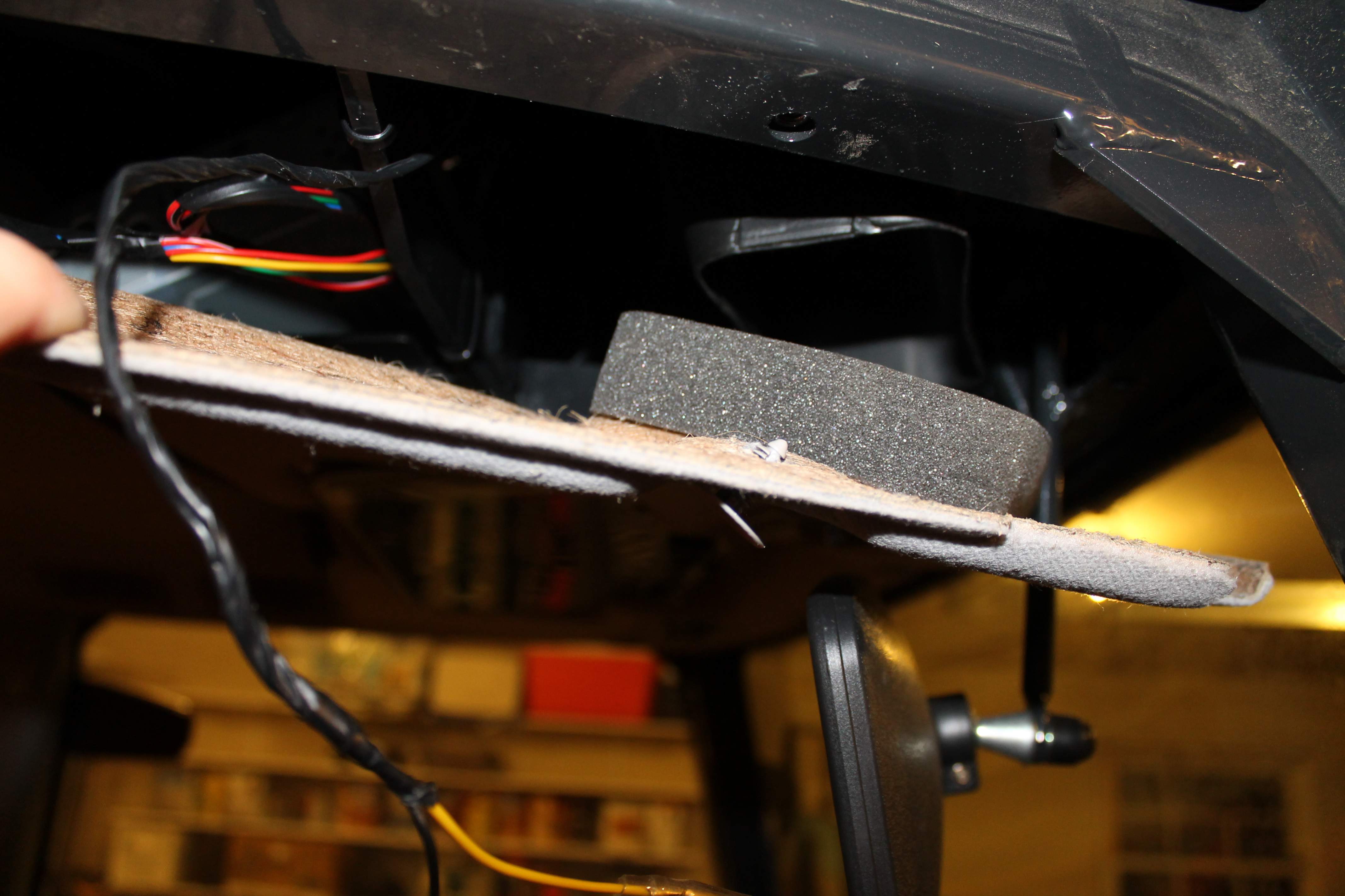

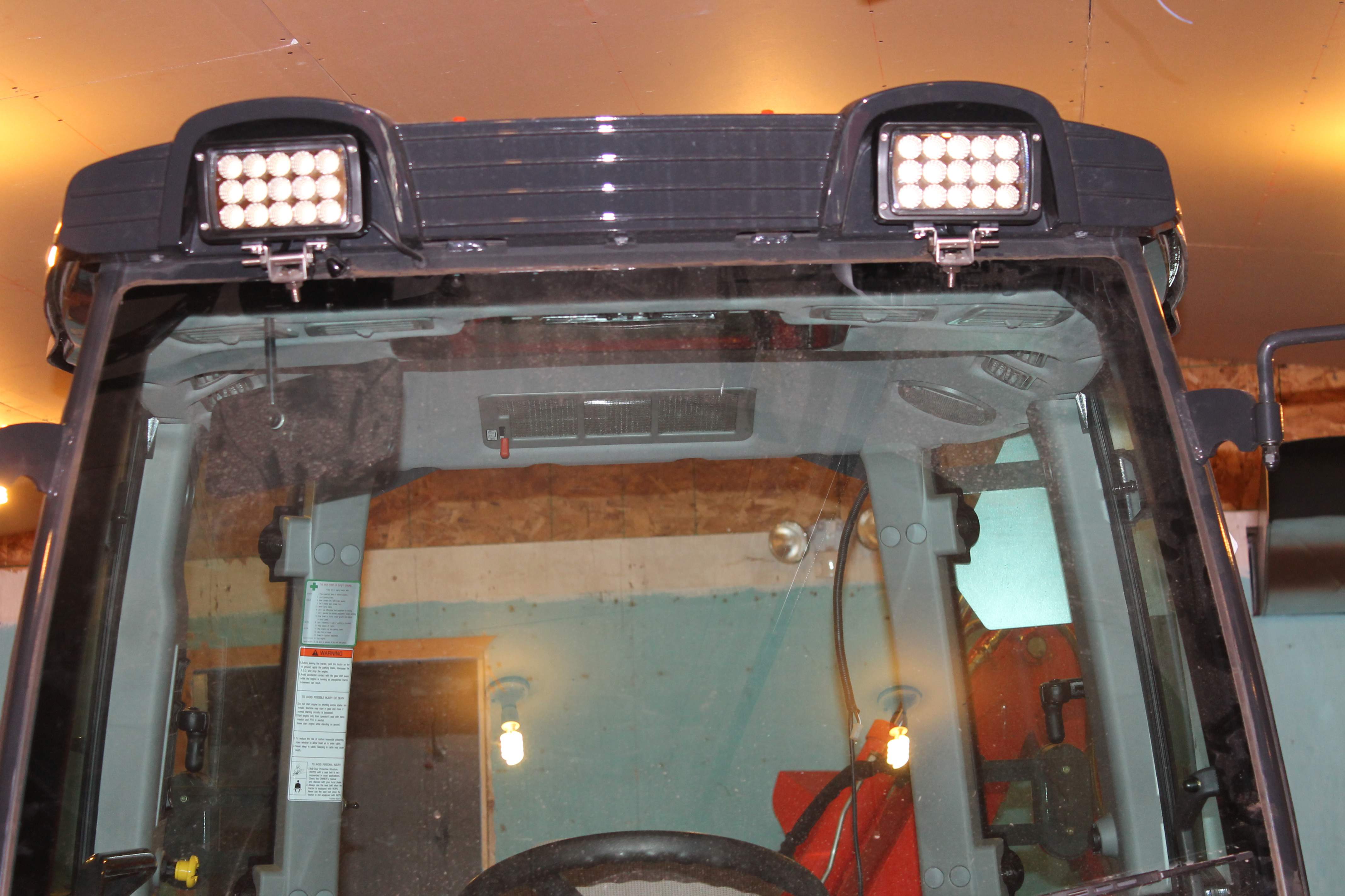

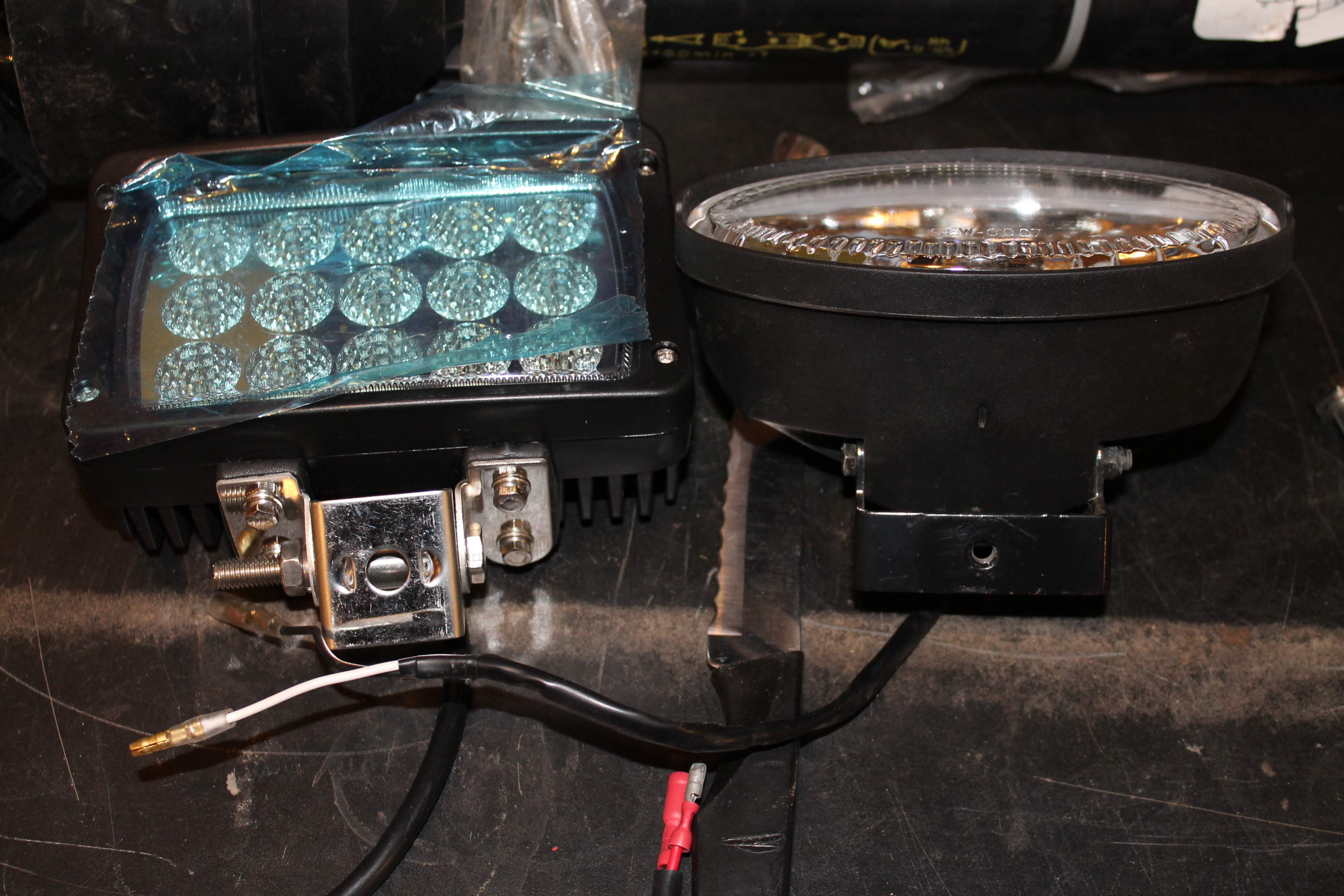

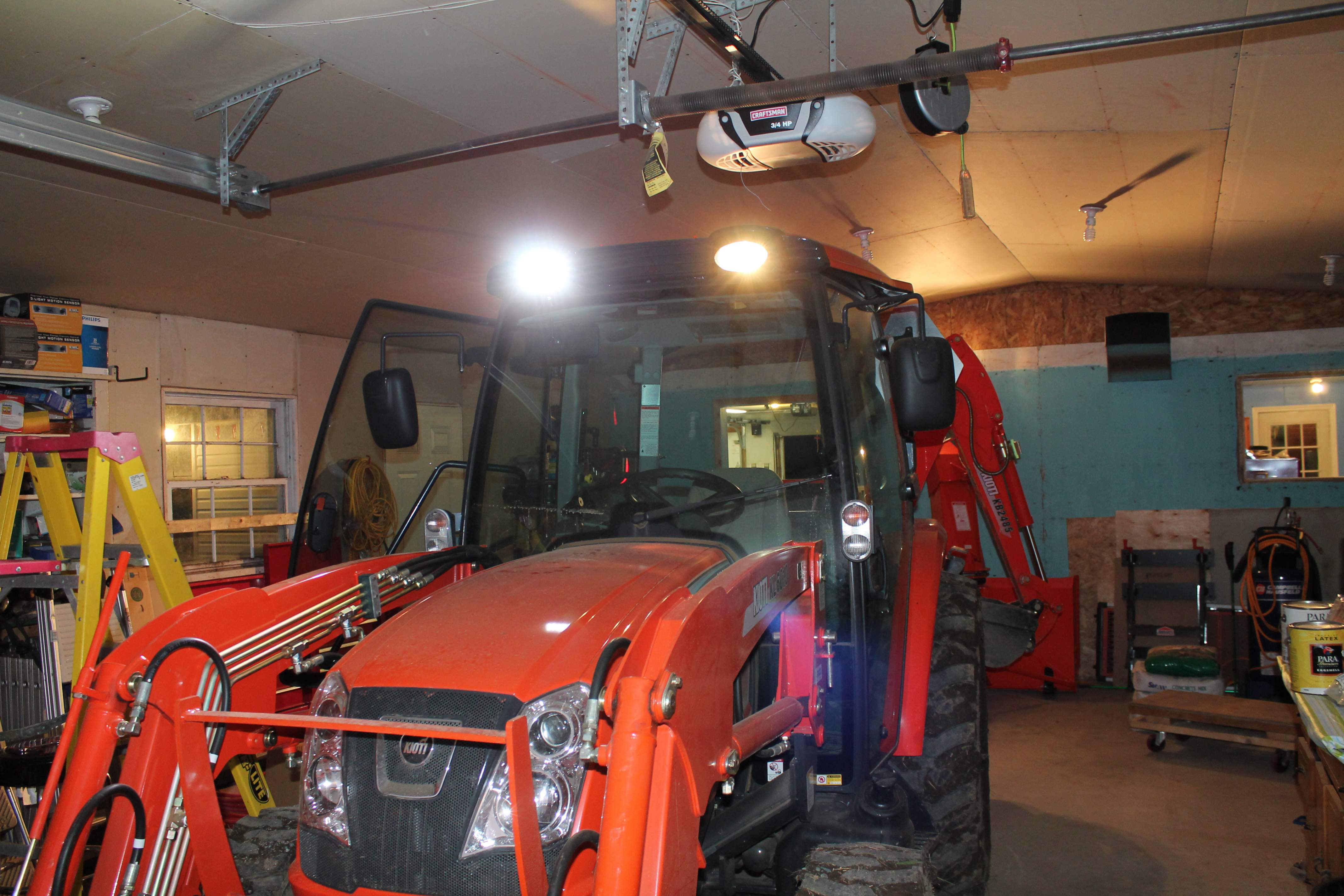

I have been a member of this forum for the past 10 years and the people here have always been there to help when I needed it so I'm semi-retired now and I would like to share and help whenever I can. I know there has been a few threads of LED light installations. This is my installation of 45 watt LEDs I got from China I installed on my new NX4510. Holy smokes what a huge difference is an understatement. I will try to post at least 2 pics per post only because they require large memory transfer. I have also been discussing the installation of a backup camera with Threepoint, Eric & Roger, I have it ready to be installed looking forward to that. Thanks you guys.

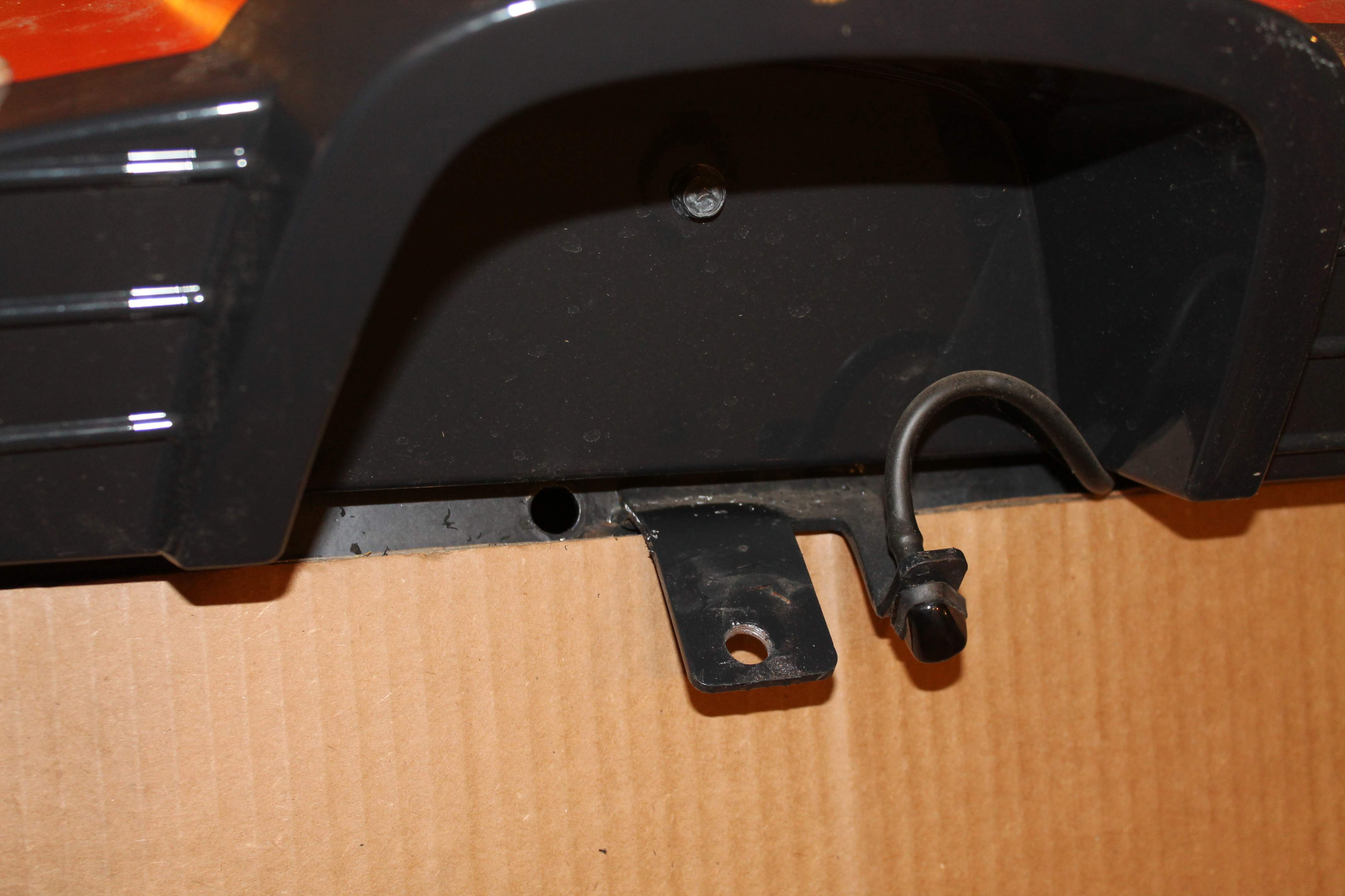

I had to bend the base bracket and drill for a larger bolt for the light to fit.

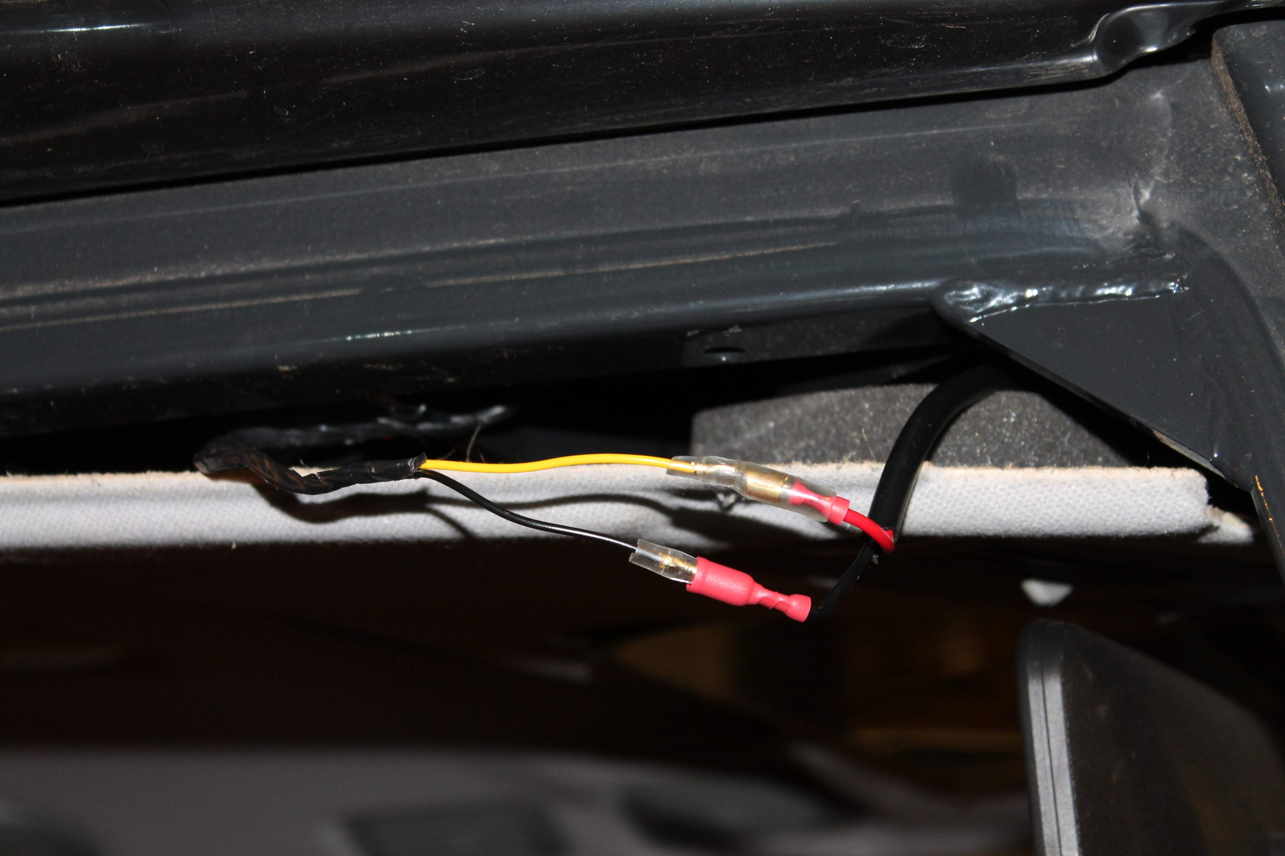

Just eased out the plastic pins out of the liner and bingo there it is. all the wiring the connectors were easy and 1,2, 3 same with the other side.

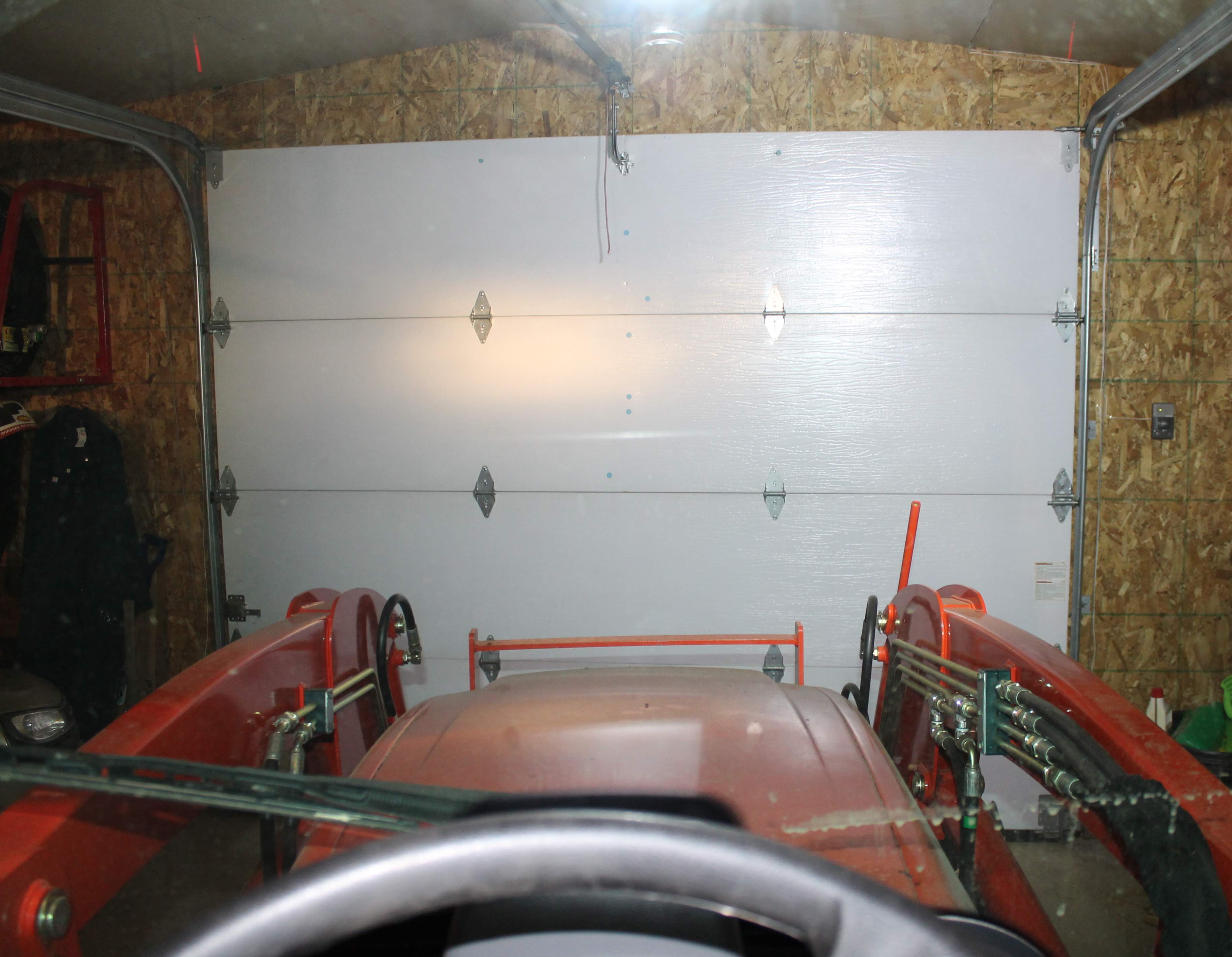

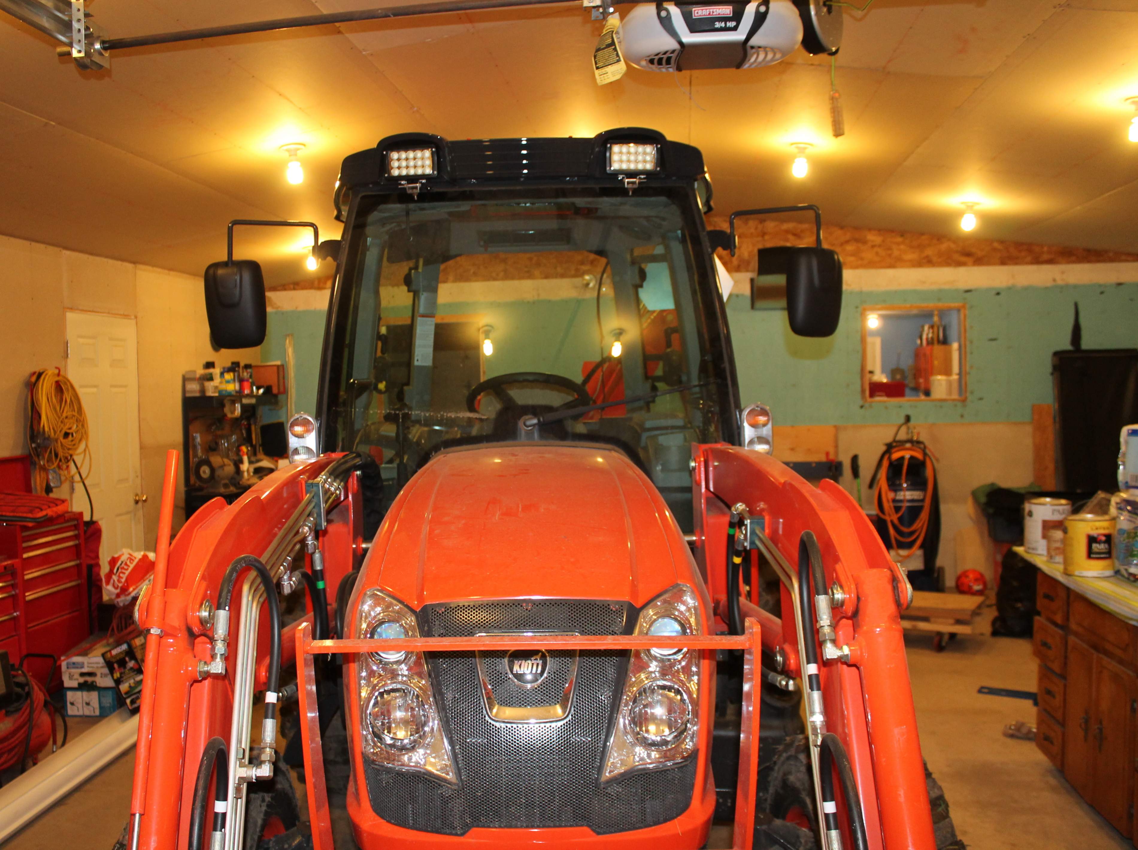

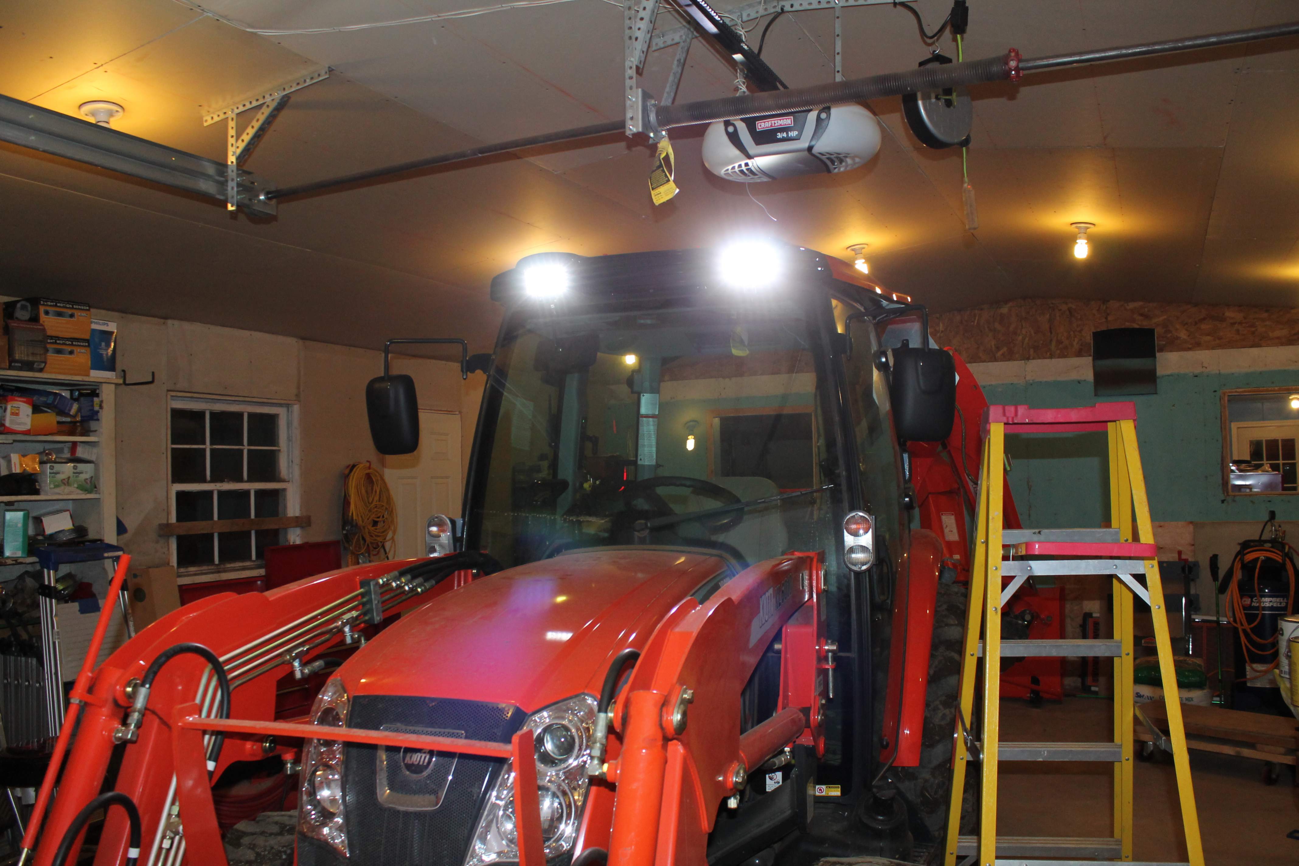

It's almost like the Tide commercial "I can see the difference can you see the difference"
   / Installation of New LED lights on my NX4510
I'm impressed :) and got 2 more going on the back. Eric you're an inspiration to upgrading.

I have a factory Radio/CD player with the DaeDong name on it (doesn't look expensive, depends on the dealer I guess) and absolutely no static or noise of any kind radio sounds beautiful. I got the lights shipped from China and cost me approximately $55 per light shipped and I believe this same light would be a heck of a lot more to purchase in an auto store not sure where else online. The lighting from these is absolutely amazing. Message me if you want the link. Cheers.

Thanks, Kevin. Did you use any special tool to ease out the plastic pins from the headliner? I was thinking something like this might make it less likely that I'll damage something: 5 Piece Upholstery and Trim Tool Set

This is the same light only I had to pay for shipping plus customs fees but worth it. just any kind of flat end tool even a flat screwdriver will do and don't forget the small 10mm bolt in the front corners.
