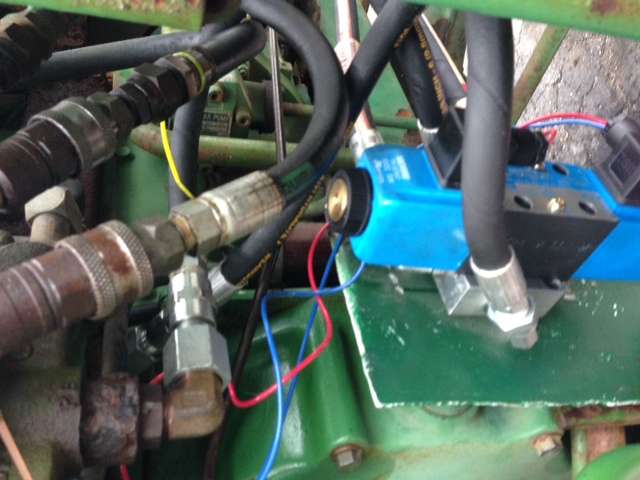

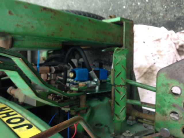

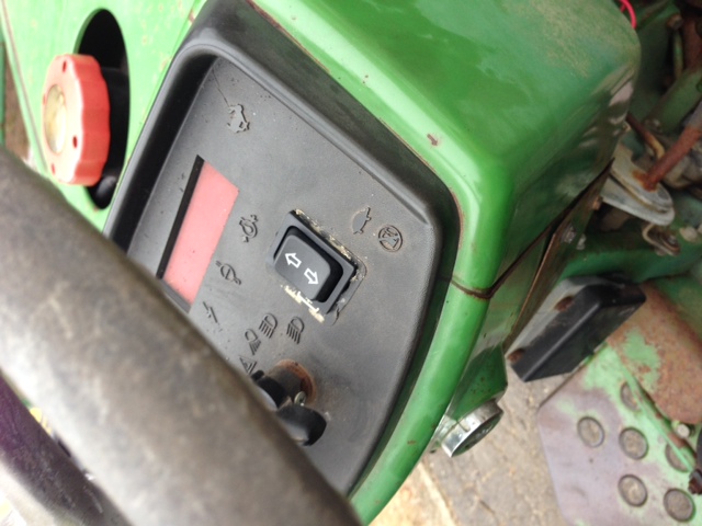

I finally got my 3rd function installed today. Thanks to Irsmun and JJ for all their help and guidance. It really wasn't as hard as I thought. The most difficult part was stopping all of the hydraulic leaks from the connections. I still have one tiny leak, but it's really hard to get to. I'm going to wait until the weather warms up a bit. My fingers were numb from the cold weather and the snow on the ground. I hooked up my snow plow and it works great. I just need to order a grapple now. I connected the switch to my dash and when I upgrade to a joystick, I'll move it. I just have to get wire protectors to make sure nothing happens to them.
