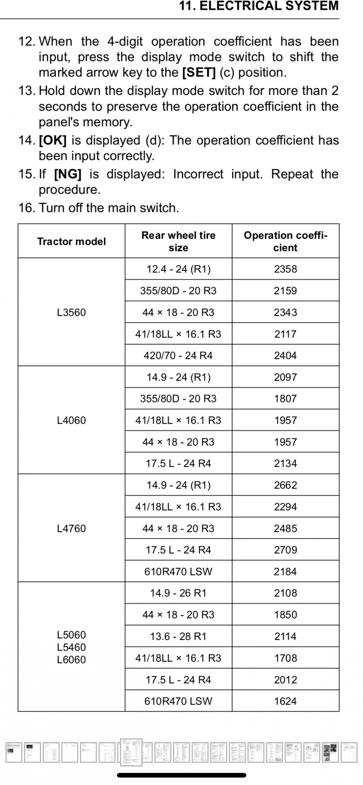

I have an L6060 with R4 tires that is displaying Kilometers per hour and needs to be changed to MPH. Can anyone help me out and confirm the correct letter on the service menu to change it to mph, and the letter for the coefficient of speed and the setting for R4 tires on an L6060?
Thanks
   / Intellipanel Display Setting #38
This is excellent, thanks for posting the full list. Can you confirm this is the most up to date? I have 14.9-26 r1 and my B setting was 1919 which isn't even in the list.
   / Intellipanel Display Setting #40
This is cool info i just did my 2021 L4060 it was not at the right setting it was just 1 minute to fix ,Thanks for this info .Am sure lot of tractor are not at the right setting you think the dealer can make that change before the tractor leave the dealership .
