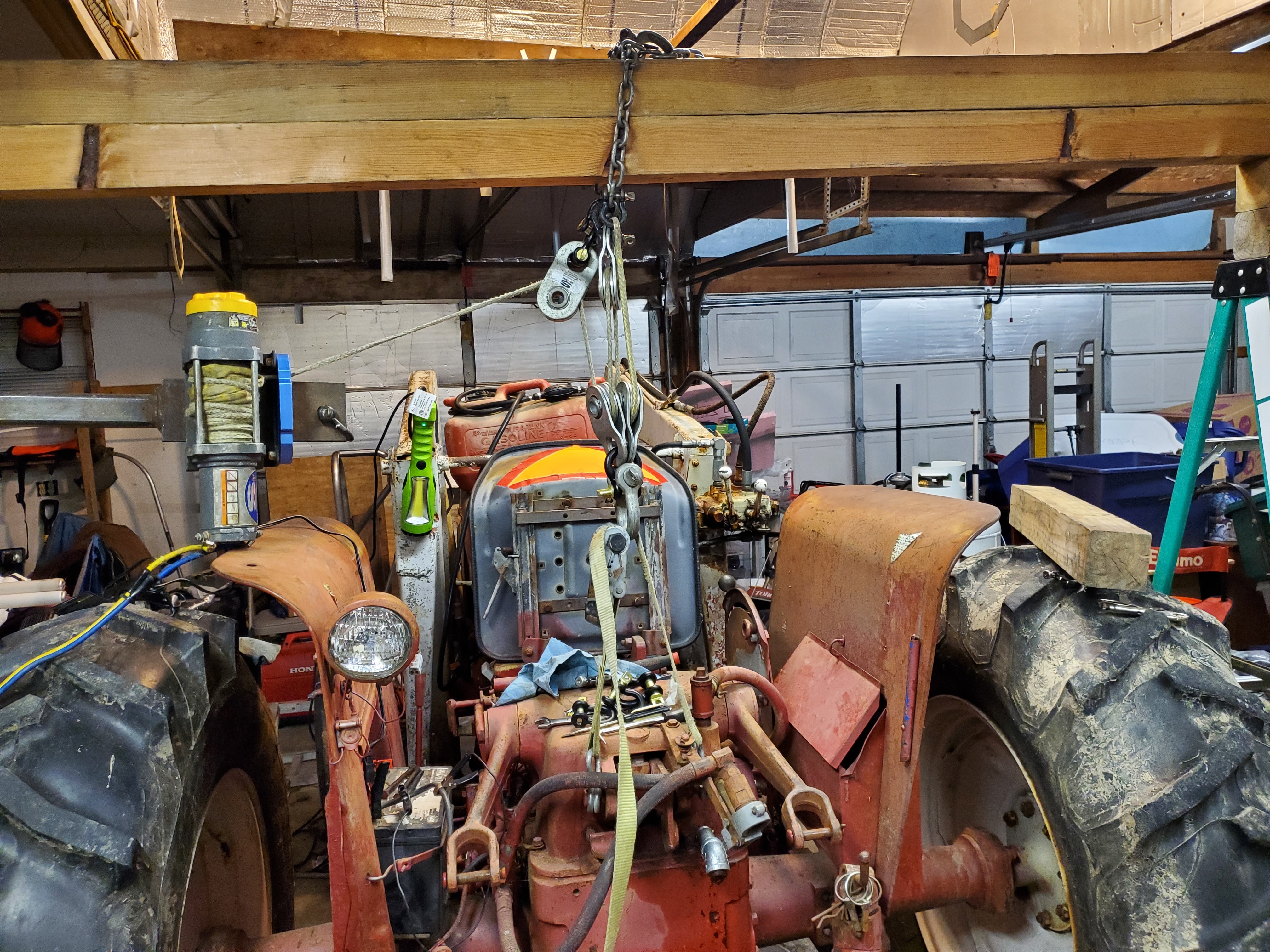

Does anyone have any ideas on how to get the lift housing separated from the rear end/transmission housing? My hoist is moving the whole tractor so I know I have an enormous amount of force on this thing. I tried all the hoist pressure with beating a pry bar between the two at the same time but was unable to get any sense of movement between the two.
I am lifting from only the rear of the housing where the top link attaches. I want to make sure I can break the castings apart first before I try to lift the whole assembly. So far no luck...

I would make sure all bolts are out (I see one still in place on left side where ground strap is) and lines are disconnected.
Then take a thin chisel or thick putty type knife and drive it between the mating surface in multiple places and that should break it free. If not try a pry bar.

The bolts are all completely unthreadded. I have them sitting in the holes to keep track of them - so they arent floating around somewhere else.
As to the putty knife - I can try that.
I did try a rotary hammer with a chisel (hammer only mode) for a while last night, also, with enough hoist pressure that the rear tires were just barely on the floor to keep the tractor from swinging with me pushing on it. No luck with that method, either.
I also dont want to damage the sealing surfaces wedging things between them.

I finally got the housing separated Sunday. I took as much weight on the hoist as I could with the rear tires barely on the ground so the machine wasn't swinging when I pushed on it, then kept hammering with the rotary hammer/chisel. I moved to the other corner - right side - and got the castings to start moving apart. Once they moved I set the tractor back down and blocked the gap with 1/8" steel tabs. From there I did a combination of hoist pressure and prying.
Now the hard part is that rear lift housing has to be completely removed from the tractor chassis in order to get enough clearance to get the shifter forks clear from the transmission casting. I can't move the hoist with the weight of the lift housing so the only option I have is to move the chassis. I can't move the chassis by pushing myself, or even with a couple people, and we don't have another machine so the next route is a winch. Since I can't push a rope I need to come up with a way to rig to both ends of the tractor. That is what the past couple days have shifted focus to - fabricating a rigging plate to bolt to the shop floor behind the tractor (against the rear shop wall). I'm using 5/8" wedge anchors, 4 of them perpendicular to the direction of pull. In 3000psi concrete they are rated to about 1300lbs each. I think the weakest link would be the concrete. That said, I doubt it is going to take that loading to roll the tractor. If the trans was locked and I had to drag the tires, maybe. Its just a heavy rolling load on mostly flat tires.
