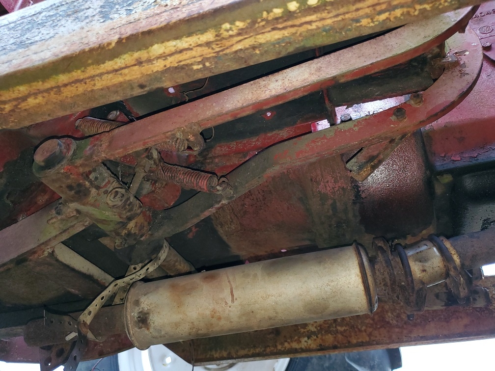

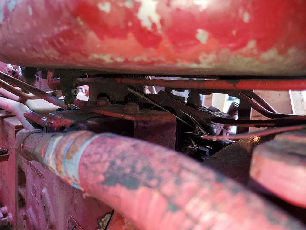

The left wheel brake seems stiff/sticky. It is harder to push and does not return like the right one.

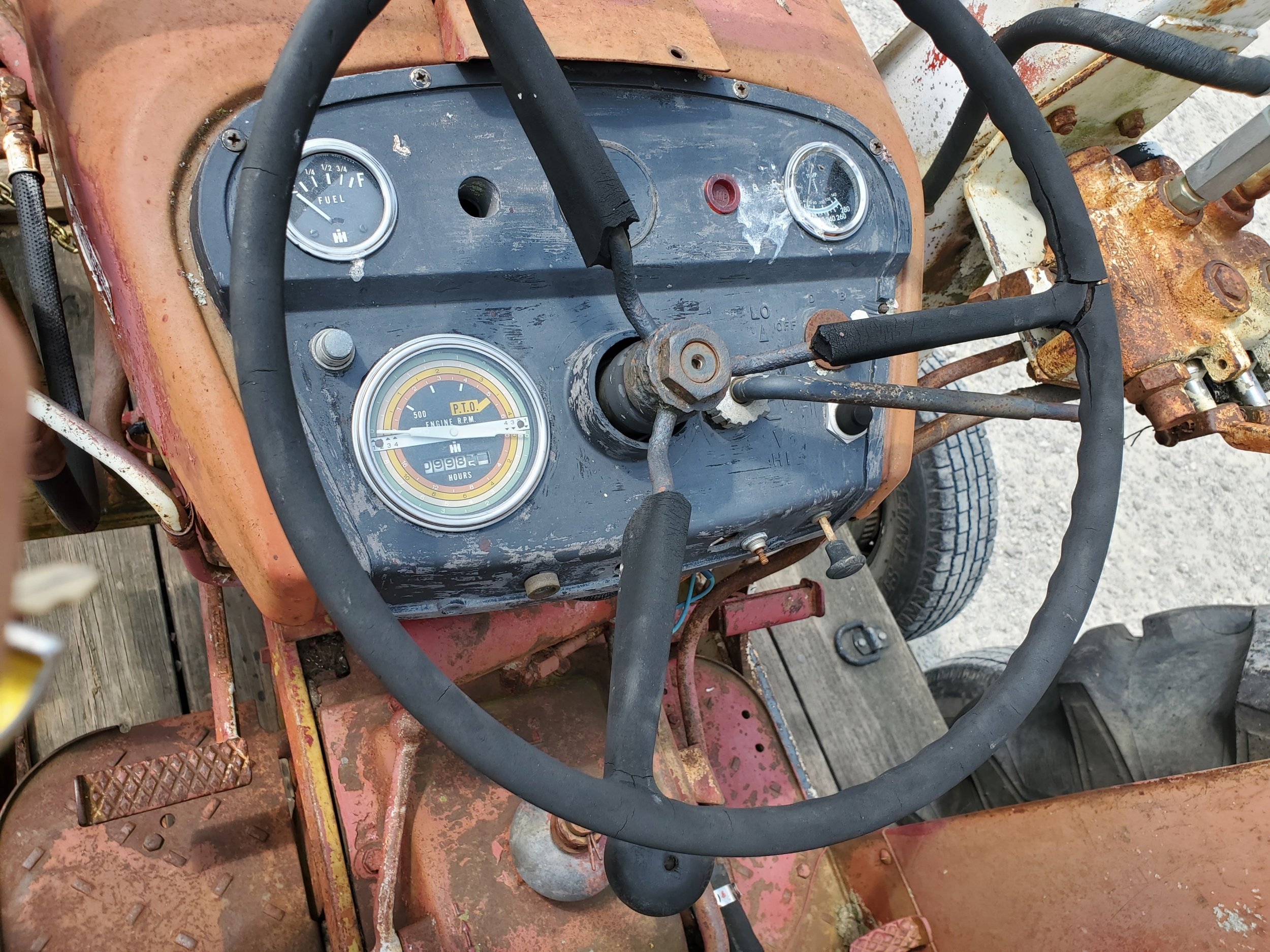

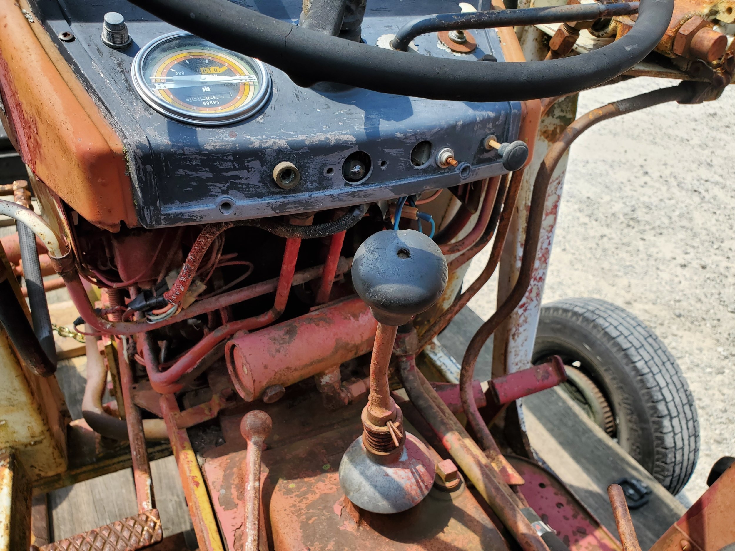

Here are a couple pictures of the dash. There are some missing knobs etc. I need to study what all they do. I know one of the rods is the choke.

Brake hanging up/sticking sounds like one of the springs, or more that hold the actuator plates together may be broken, and slotted ramps the ball bearings ride in may be rusted along with those ball bearings. They are pretty easy to service. Disconnect the brake rod, remove the bolts holding the brake housing to the tractor and everything comes off in your hands, except the back brake disc. It should stay on the bull pinion shaft. This is a link to the Case/IH online parts catalog showing the brake assembly in an exploded view. Case IH | Schematic, Manuals, Specifications and Diagrams for controls, brakes, brake lock and connections | MyCNH US Store
Hopefully the bull pinion shaft seal isn't leaking and have the brake discs soaked with oil. But, if they are unless totally worn out, you can literally boil the oil out of them with a propane torch. Hang them up somewhere outside, and heat with a propane torch, oil will drip out of them. Might want to place a catch pan underneath because they actually will hold a lot, and it will be a smokey job. Keep heating until oil stops dripping. Let them cool than hit with some spray brake cleaner. I went a step further and roughed the surface up with a 2" medium gasket removal Roloc disc on my 90º air die grinder. If you don't have one of these, it'd be a great investment and save you a lot of time and effort. I got mine at Harbor Freight 30-35 years ago, have used it a lot and still works great. The Roloc head you can get about anywhere, disc's I get generic one's at Flea Markets and last as long, or longer than the OEM Roloc discs. The fellow I get mine from sells on Ebay but see him at Flea Markets in our area. Flea Market price is 50 discs for $20 but may be more on Ebay. None the less, they are well worth it. VERY handy for just general cleanup of mating surfaces.

I got the tractor off the trailer last night. While I was poking around with it I started studying it.
The fuel line is rotted off of the carb and tank. I should have everything here I need to get something on it, with a filter. The question is getting the tank out and cleaned enough to use. I am not sure if the port on the tank will clean up enough and/or not leak.
There is coolant, lots of it, in the radiator - so it hasn't leaked out.
I didn't have time to do any wrenching last night, but the 2 areas for sure that I want to work on for sure are the slide on the gear shift and the fuel system/tank/carb. Those will be first to address this weekend. And the ignition/start wiring.

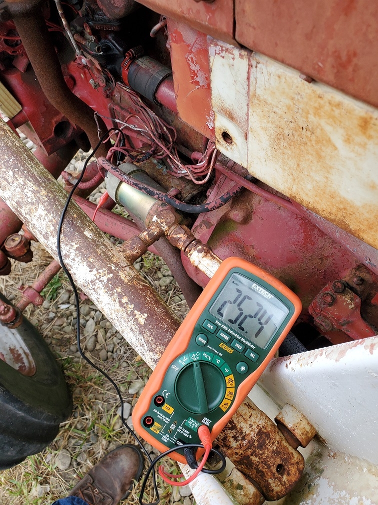

The starter solenoid shows about 252 ohms across the coil. When I put power to the coil it did not engage. The battery on the machine is at about 11.5 volts. I also used a lithium battery that is about 13.5 volts. I got nothing but a little bit of spark. I had the ground connected directly and used the hot side as my contact.
However, I did not clean the terminals very well. So it is conceivable I did not get a good connection. However, with the spark you would think I would have had some better sense of the solenoid trying to engage...
That is not a high priority at the moment. We can jump the high current terminals and get the starter to go (and it goes strong) so there is a "way around it", just something to keep in mind down the road.

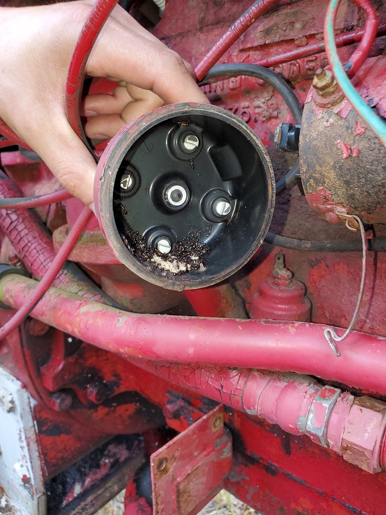

The distributor contacts don't look too bad. However, some ants have made a home there. I pulled some of the wires/plugs and they all are nice and shiny also. So I don't think I have that to worry about, but ya never know.
This was an earlier topic - the brakes. I did not get a whole lot of time yesterday to check much in detail, but I did get a picture underneath to show the linkages and springs.

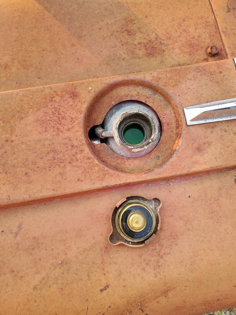

And last but not least for now - the fuel tank doesn't look bad on the inside at all. So it may work out OK. I will hose down the port with some brake cleaner when I get back to it to get the grease and gunk off and see what I got there. It may be OK.
I did find these gems in the tank, though. Anyone missing a maglite head? :D

Speaking of which - I have not figured out the ignition just yet. I assume stopping the engine is by grounding out the power to the ignition coil. However, there is a voltage regulator listed on the diagram that I am not too sure on - where is the power coming from and what voltage is the regulator regulating at?

Hopefully this is a better wiring diagram than you have. Wiring Diagram 354-374-444 – International Harvester Heritage Association Note it is for a U.K. model so you'll have to compare to what you have. Looks like it'd be a lot easier to print those pages off if you're on a PC and have a printer.
I'm thinking VR output should be between 13.5- 14.5volts, depending on how low your battery is.
A quick look at the wiring diagram I'm seeing a ballast resistor. The 444 may be one of the models that when engaging the starter it puts 12 volts to the distributor for a good hot spark to get it to start. One the starter button is released it cuts that circuit then goes through another to run on 6 volts for longer contact points life. You've got some sorting out to do on that harness, but I'd be looking for the ballast resistor, and check voltage output.
Killing the engine is done simply by cutting current to the ignition. Not seeing a key switch, I assume one of the push/pull switches replaced a key switch.

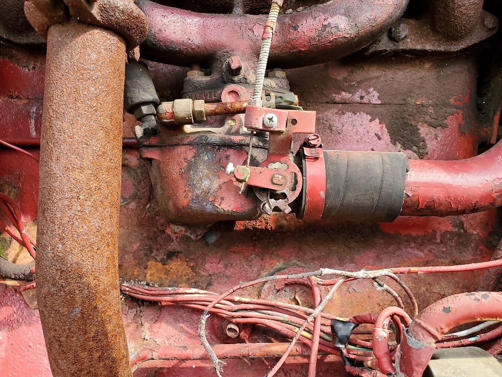

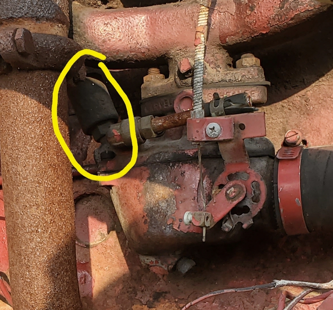

Here is another mystery at the moment - the fuel shut off solenoid on the carb.
Is there a way to block that port? Or does the solenoid definitely have to be there and powered to get fuel thru the main jet?
I did a quick search for a fuel solenoid on the C-153 engine and by luck came upon a thread for one on a 444. Easier for me to post the link to that thread: 444 Fuel Shutoff Solenoid Then did a search for a "load adjusting needle" for a C-153: C-153 adjustable load needle - Google Search Then another search for a fuel solenoid for a C-153 engine and found this: 71358C92 Fuel Solenoid
In my mind I guess I always though the fuel solenoid was to cut fuel to keep them from dieseling when hot and seeing it that close to the exhaust sort of confirmed that. But seeing a load adjusting needle in the thread above shoots that out of the water.
Looking at your picture I'm not seeing a wire going to it. Either it's hidden or was removed/broken off. Either way, I'll assume it did run before. But also seeing that rubber fuel line that close to the exhaust looks like an accident waiting to happen. Personally, I'd figure out a way to make that connection with a metal line, but again merely a suggestion. If you choose to go with another rubber line I'd make some sort of heat shield, for what that would be worth. But a metal line that close to the exhaust sems like it would be pretty susceptible to vapor lock. Just my opinion. Engineers, gotta' love them...

The wire from the solenoid is broken off, the remnants are there inside the can.
I am still chewing through this one.
Looking at the info (and thanks a bunch for the links) - if I were to guess - the solenoid actually controls air, not fuel, in that when it is open (off) it allows the vacuum of the engine running to draw air through the main jet, instead of fuel, there by starving the engine of fuel during shut down. The opposite would be true when the solenoid is closed (on) - the vacuum of the engine (with the assistance of the choke flap) puts suction on the main jet instead, puling fuel in to the intake.
Just a hypothesis at the moment.
If that is the case - then simply blocking that port would do the same thing - it would create a hard block to draw only fuel. That would line up with the link you posted on the replacement non-adjustable solenoid - one that doesn't have a needle valve in it.
