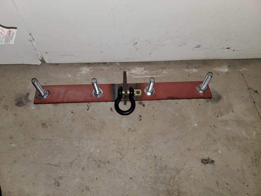

Good idea on the pto shaft to move the tractor. Ill have to keep that in mind.
The rigging plate, though, will help us drag everything else in to the shop - equipment and vehicles. So it has a larger purpose than this one project/situation.

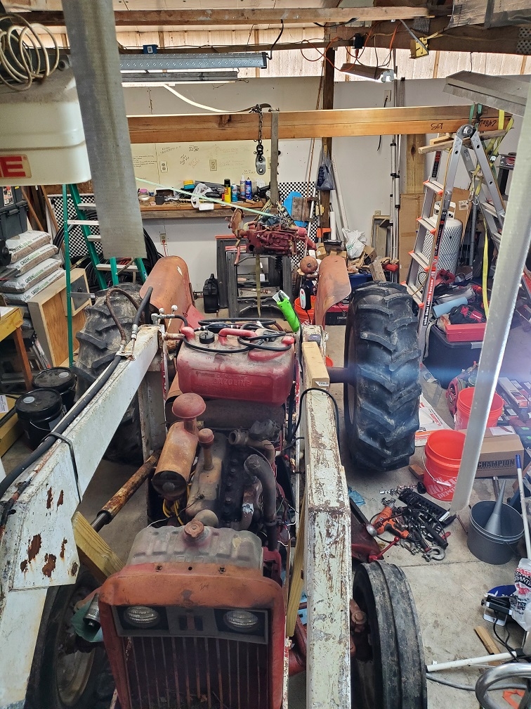

Just a quick update so far this weekend:

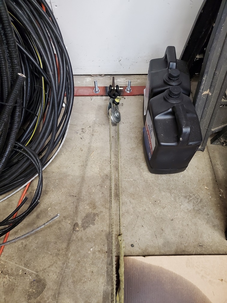

I got the rigging plate fabricated and bolted to the shop floor. It works fantastic.
With the rigging plate in place I was able to get to work today on the tractor work that I've been needing to get to - splitting the lift housing from the chassis. That was a success. It took a while as I had to reorganize the shop in order to get the room to winch the tractor backwards and forwards. So that aspect of the work is now checked off the list.

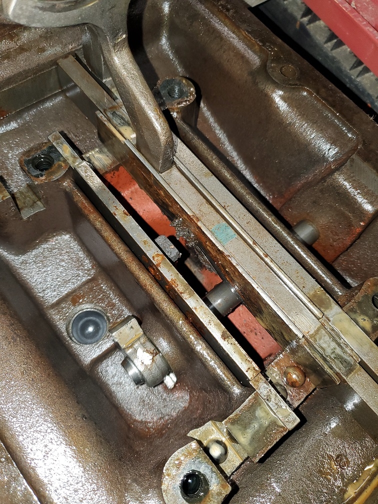

I also got the transmission top cover - with the shifter and forks - off the transmission. In inspecting the transmission - it appears all the gears are in good shape. I don't see anything that is much of a concern in there yet.
What is a concern is the shifter won't move side to side past 1/R - even while out of the transmission. The good news in that is what is hanging it up is not IN the transmission, it is associated with the shifter assembly.
The bad news is I can't find a diagram that shows the proper assembly of the shifter forks/sliders. The parts manual shows an exploded view of the parts, however it does not depict the assembled components or how they assemble.
That said - I can't tell if the hang-up is the ball on the end of the shifter not sliding in to the notches in the higher gear sliders; or if the shift lever is seized on the pivot pin.
I will try to disassemble the shift lever from the top and see what I can find. My hope there is I can pull it out of the top of the cover without disturbing the slides underneath. We'll see what happens.

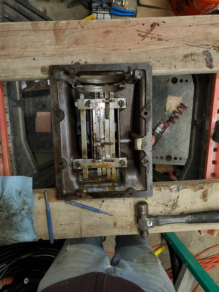

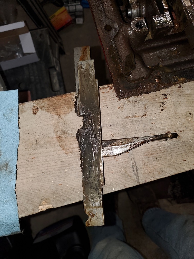

Another weekend update - the shifter is freed up, mostly.
The issue was 2 parts. The 1st part was gunk clogging the slot between the sliders. That prevented the initial side to side movement in the shifter. However, after disassembling the whole assembly it was apparent the larger pin was seized. It had enough slop somewhere that the shifter was able to move side to side somewhat with the gunk out of the way, but not enough to get it to move between the sliders. I sprayed the pins with Deep Creep penetrating lube and beat on the shifter with a ball peen hammer. This got things to move, but they will still need to be worked more to loosen up.

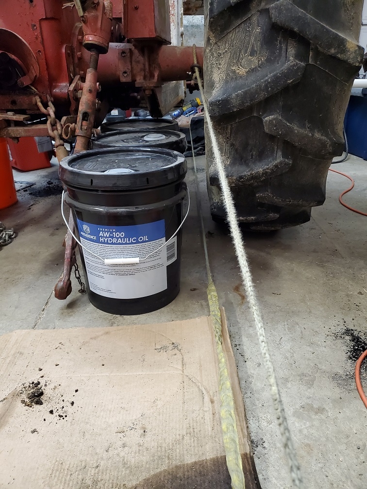

This is the rigging plate and rigging I set up with it to move the tractor. There is a 2" ratchet strap going under the door to a vehicle in the drive as an anchor for the front. I am thinking of putting a rigging plate up there, also, but I am not sure I want that "obstruction" in the way of the floor and rolling things by up by the door. So for the time being the strap out the door to an anchor method is fine.

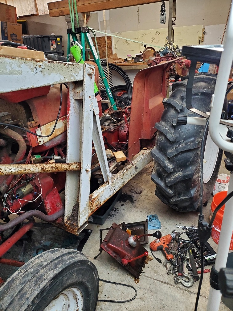

With the tractor chassis mobile now I could get the lift housing up and the chassis out from under it.
After I moved the tractor chassis out from under the lift housing I set the lift housing back down on the ground - where it will sit for a long while. I need to order some gasket material and will need to clean up the seal surfaces yet.

Here are some pictures of the shifter assembly. There is some rust visible. However, the gunk between the sliders should be self-explanatory on the "hang up" issue.

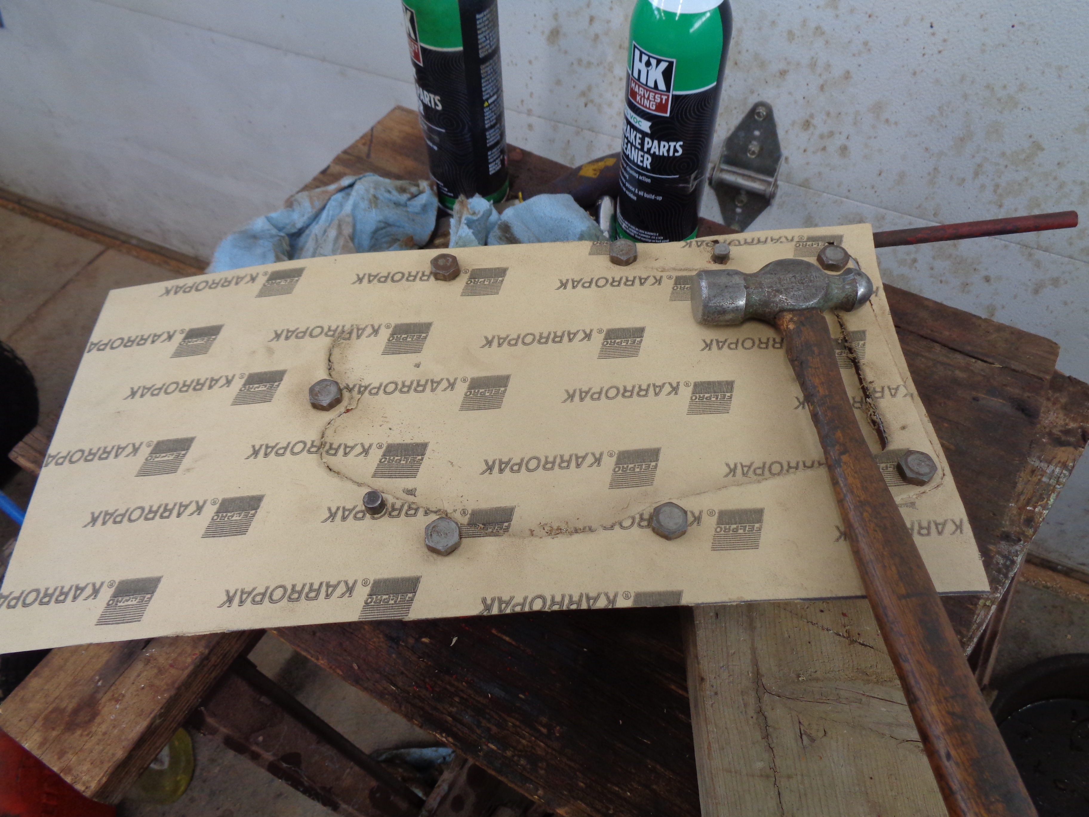

You may want to consider making your own, it's really not all that hard.
You'll want the surface cleaned up. For smaller area gaskets, cut a piece slightly larger that needed. Lay it on the piece you're making the gasket for. Take the pointed end of the hammer and tap out the bolt holes first. I have multiple ball pein hammers in the 6 oz. to 12 oz. range specifically for this purpose.

Just a basic ball peen hammer works best like pictured below, the body hammer with pointed end is too pointed, it will pull/draw the gasket material inward, tried one of those many, many years ago. 8-to-12-ounce hammers work good with the ball end (rounded/domed end) with a more prominent/pointed end. Seems newer hammers in store are blunter. On larger bolts it's best to tap around the hole numerous places to make the initial cut, then once the gasket material fibers are basically cut, you can center the hammer on the hole take another hammer and with a few light taps finish cutting the material.
When making gaskets for the transmission case, that little tab will be in the bolt hole, pull material to the side and take a small screwdriver or shop pick push down on one side and it should turn so you can get ahold of it and pull it out. Lay material back down and run a bolt in to hold it in place, then go to the next hole, and so on. Get all of the bolt holes cut first and insert bolts.
On a piece like that with a straight edge on one side I use the factory edge of the material even with it to help keep it aligned. Next, start tapping on the inside of the case on about a 45º angle, you'll want to tap right on the sharp edge of the case. I'd advise starting on the side that has some material hanging over the edge, it will help keep the material from pulling inward. Once you go an inch or so, you can turn the hammer over and use the flat end and make faster progress until you get close to a corner. I'm assuming the corners are somewhat rounded so switch back to the peen end. Cut/tap around the corner, go another inch or so, then back to the flat end until almost to the next corner then switch back.
You don't need to hit hard, just some light to medium taps to start with until you see what it takes to cut the material. On a long run you may tap an inch or so, then tap back to make the clean cut, or flip the hammer and use the other side to make the clean cut.
Do know you'll have some fuzzies on the edges. For these, take a sharp box cutter knife and rake backwards on the edges. You'll want to hold the gasket close to where you're scraping and only go a few inches at a time. You may still have a few hanging on what was the lower side, just adjust the angle on the knife to wipe them off.
If there are alignment dowels, tap it with the flat end to mark it, then tap it at a 45º angle as most have a slight beveled end. Tapping on a 45º will cut it below the bevel if there is any. You should be able to push the material down over the dowel and continue. Just be careful pulling it back off to clean up the fuzzies.
It may sound a whole lot more complicated than it really is but isn't. It would be nice if you had a smaller piece to experiment with and gain some feel and confidence. But just take your time and you'll get it.
