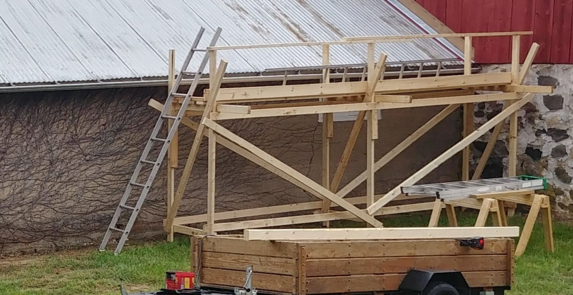

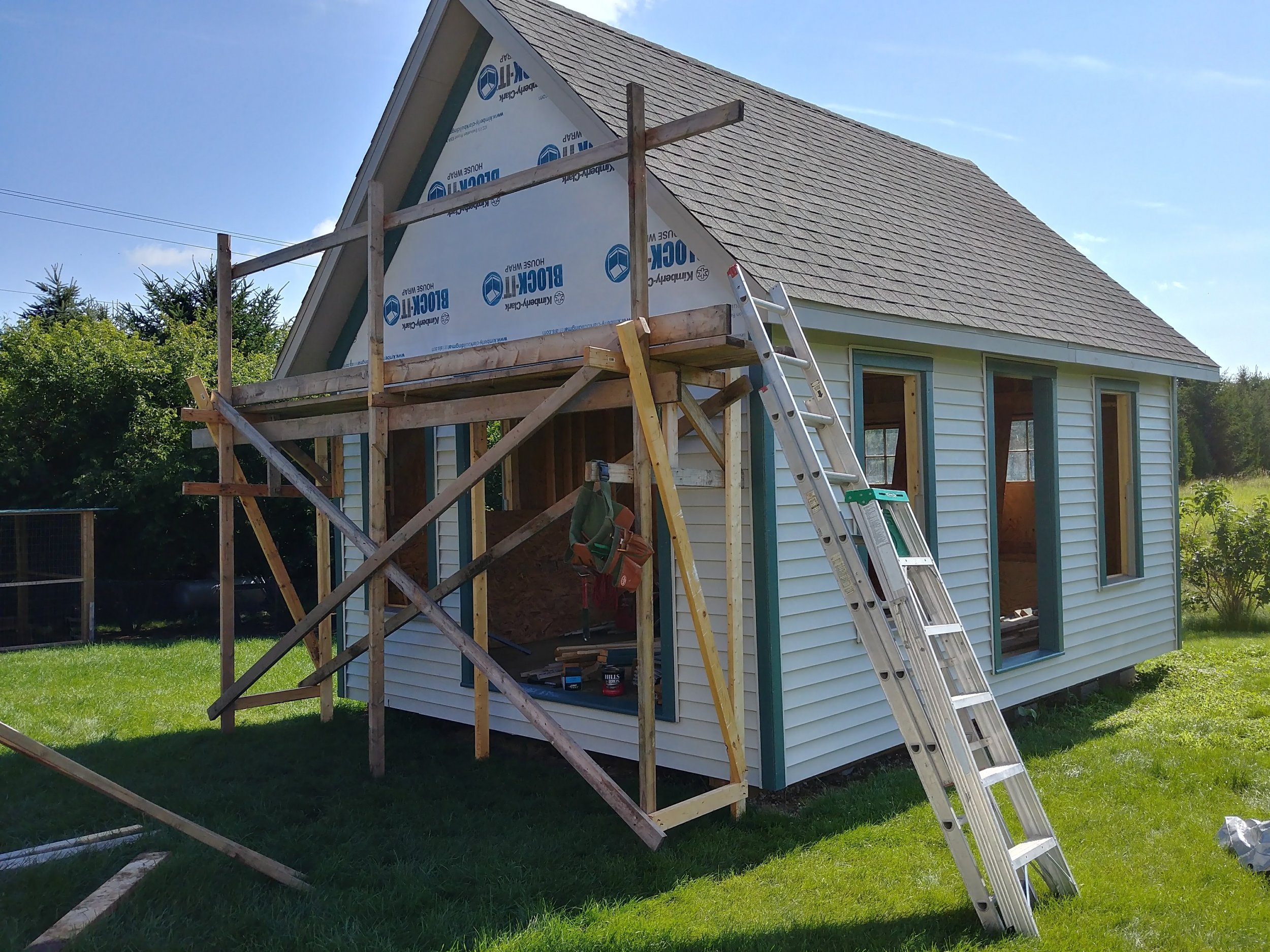

Now days duplex head nails are mostly used for concrete form work. But to buy them today, a lot of times they are still called scaffold nails.
It takes about $125 in materials and 45min to put up 8ft x 16ftlong scaffold, with the materials re-useable afterwards for other projects. In this case I use the loader forks to move it around. 25min to disassemble. Osha has guidelines on scaffolding, including those made of wood. But I think I saw mentioned "My existence can be summed up as an endless series of unreported OSHA violations..."

The small shed on the left was built in 2016, with the scaffold materials ending up used for part of the shed. The metal roof on the right, scaffold was put up yesterday, gone by tomorrow. So there is something to be said about rent/own/store/build depending on use and abilities.
