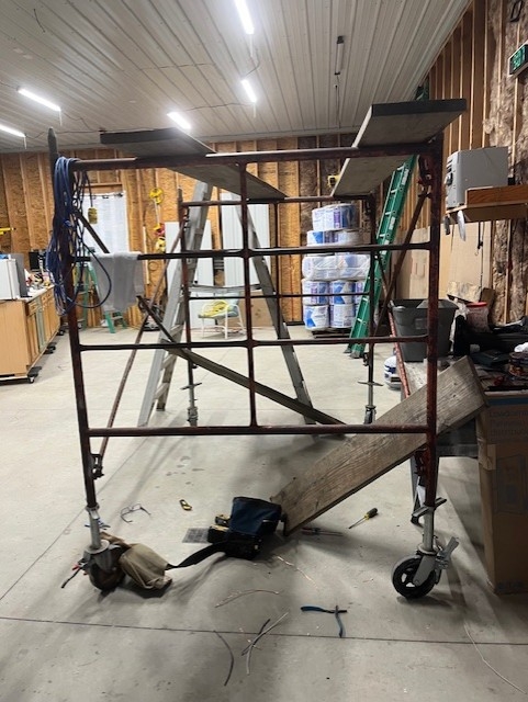

G'mornin.
Became familiar with my scaffolding that has been mine for 8-10 years last Friday morning.
Carelessly went to work 6 ish feet up and one of the oil treated indoor kept 2x10's failed without any sign at all. Needed a piece of OSB to spread my extra Thanksgiving package over more than one board apparently. No injuries other than scrapes on my arms as I went through between the other 2 planks. Yes, I realize how lucky that was.
Shocked me, I take care of them. Scares me to think I was 20 feet up on them last year.
It's been pointed out to me by Mrs. Obvious that aluminum planks for these are only $200. What the problem is is that you usually need several, and I've said it before but I really plan on selling these sets soon so I can't take on these big projects anymore!!
BEEEEE CAREFUL Gentlemen. I cringe when I think of what even a sprain would've set me back.
