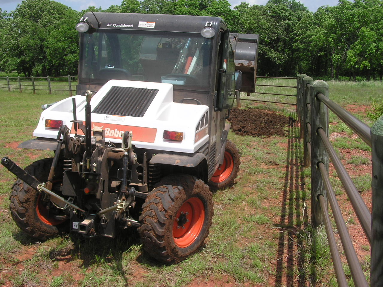

That's an incredible little machine! I'd honestly need to do a ton of research on something like that because I've not considered one or even know what one costs.
I posted because a lot of people have never seen one.
It is going to cost more than a small tractor, but it is commercial quality and with 4 wheel steering, cab with ROPS, FOPS, air conditioning and heat, it is a fantastic machine.

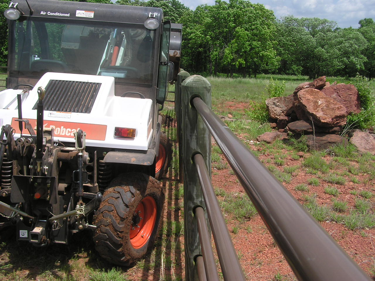

Can't do this with a tractor if close to a building or fence:

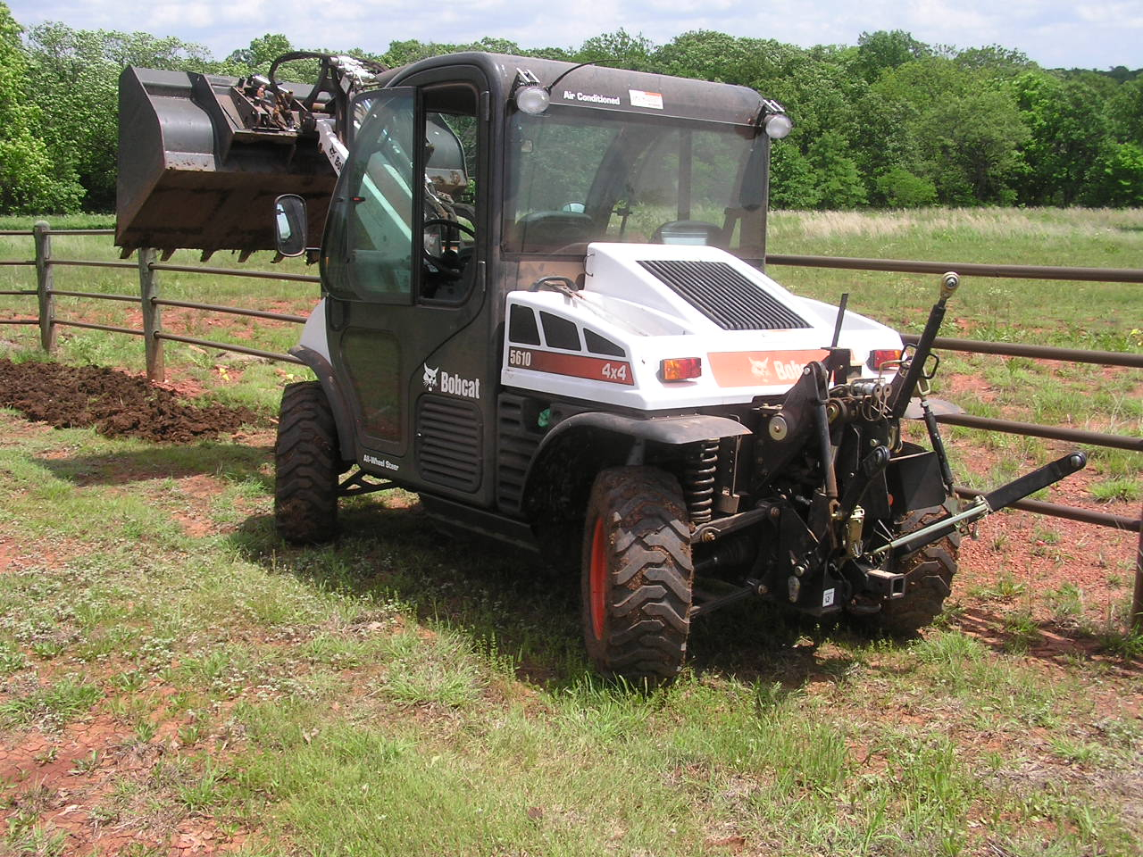

Turn the rear wheels away:
And back up:

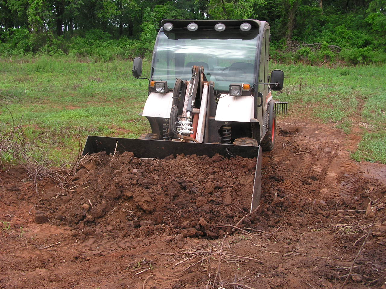

Toolcats do well digging, this is red clay and a 6' wide 1 cubic yard bucket:
